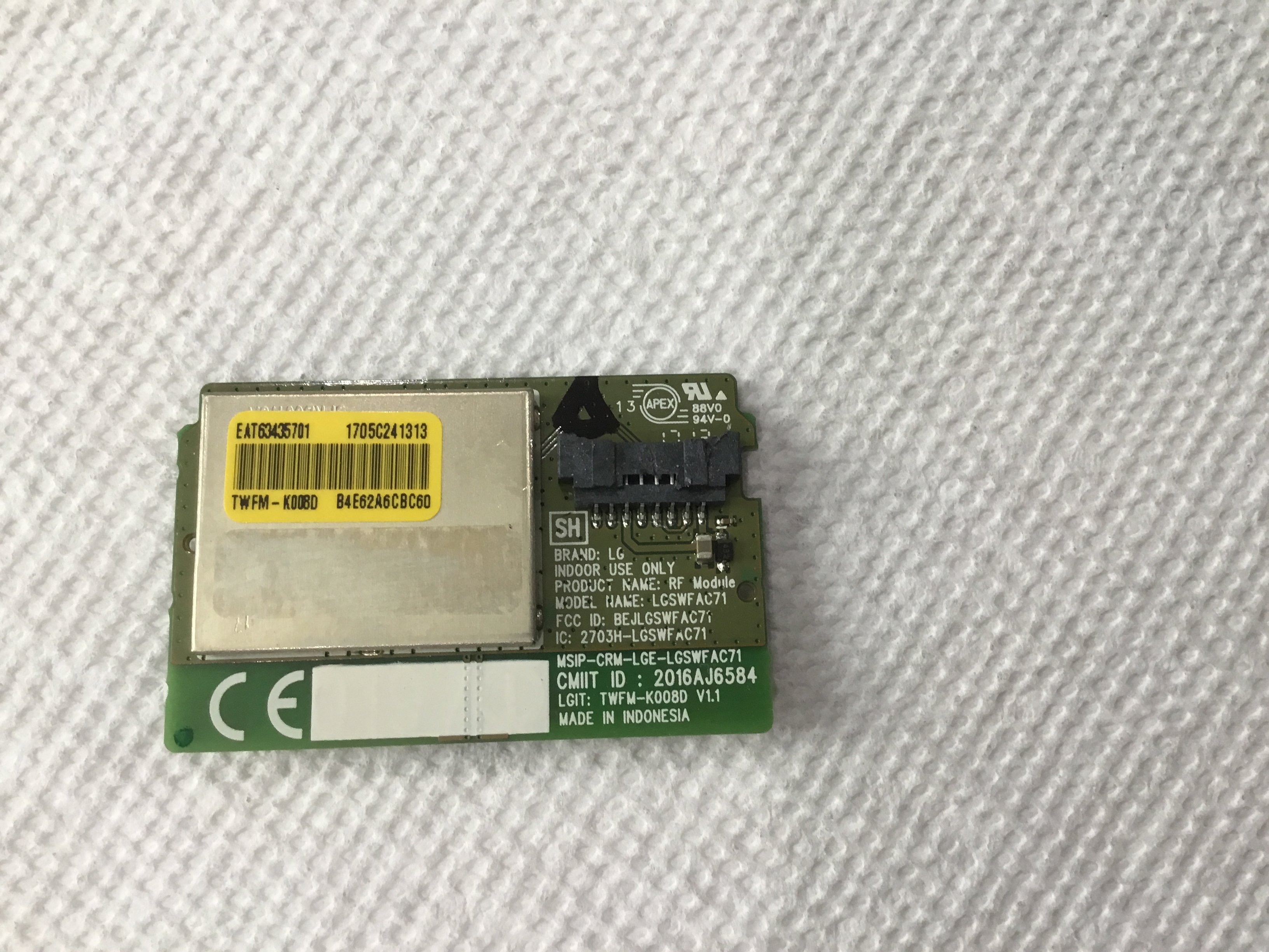

  2. Here is a picture of the WiFi module that I replaced. Everything is working fine now.

  4. I just replaced the WiFi module yesterday and it solved the problem also. We will not buy another LG tv again as this tv was a replacement for an LG that went bad while under warranty. This tv was fine until the last update. We feel LG should have acknowledged and sent out WiFi module replacements but they keep saying they can’t find a connection between the two. Granted some people have more issues and they offer service call but it costs. I also realize not everyone can change out the module. The hardest thing was taking out all the screws out of the back of the tv.

  10. How did you figure out that is those parts that needed to be replaced ? You have to really know what you are doing to to do what you did. Thanks for info though.
