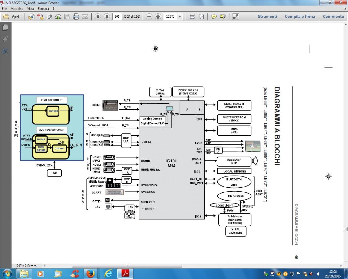

the data provided in the manual must be necessarily true , otherwise incur the crime of fraud against purchasers . so always read the details of their TV to know com ' is done, what has and what has not in hardware . for example the series " U " of 2014 is different from the LB series , and the series LB c ' is a TV that has the processor 14+ others have the processor 14 only . N.B. specifications I posed was generated from the 2014/2015 roughly identical to the same end -
LG SMART TV WEB OS PROCESSOR & RAM INFORMATION
feraug replied to rohit.ksingh9's question in LG webOS Smart TV Questions

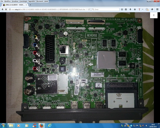

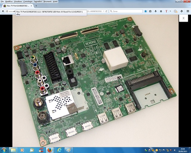

I'm sorry to correct you Simon , mi spiace correggerti Simon, serie lb ram 1° livello = ddr3 speed 1600 , 512 x 16 = 1 byte = 8 bit quindi 512 x 16 bit = 1024 byte. "" "" 2° "" "" "" "" 256 x 16 = "" "" 256 x16 "" = 512 byte. serie lf es 42 lf 652 ddr3 1° livello ( ram A )=bit 512x16 = 1024 byte "" "" "" 2° livello ( ram B )=bit 512x16 = 1024byte. questo è 42LF652 come si vede this is how you see 42LF652 these diagrams are drawn by its manual so original . -

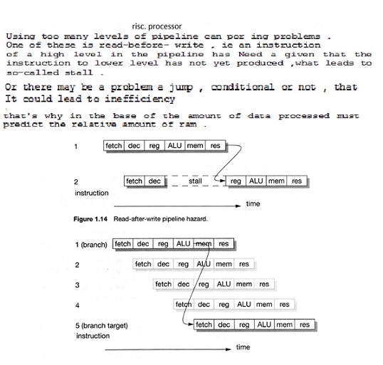

This confirms exactly what I 'm saying has always put a body on a machine that weighs much more than its engine has the strength to move . They miscalculated assessment of ' commitment to process all this , then they are also stupid because they continue to have to do everything automatically . just put a menu choice for the automation functions , like, EPG , channel list ibn reception etc. , etc. , if they did it would alleviate the poor processor and its dynamic ram , for example, if I do not want the channel list could exclude , does not leave us no choice , for example , I bought a TV , because I also tune the radio ? if I do not want them , he tunes too , just give me a chance to ignore them , but not to exclude them from the line saving memory , indexes , etc. , etc . I say this because to do all these automatic , when perhaps at that time I do not need ? give me a chance to turn on or off the function at will , then I would be aware that if you ask an automatic at that time I have to wait for those moments processor esegua.ma them eg I have to change platform from terrestrial TV to satellite TV on TV makes me wait a minute because it must update 5000 channels it is really unbearable . the hardware version 2015 what the ' have partly solved by putting the processor series " + " faster and doubling the ram dynamic second level from 256 to 512 Mb who do not care about us is that in the observations suggest also to lighten the automatic functions with the choices , but we just ignore , do not care about their customers , it is a real shame because the ' hardware is really great, them bit less . not to mention the internet , which is useless , just say that you connect , but then if you actually want to use , a lot of things you are denied and his speed makes us go back 20 years , but not ashamed !. I am not referring to the connection to the network but the connection internet.http . what is the use if we implement it in effect is unusable ? -

in all this , it is important to create a good kernel , and size the dinamic ram wisely , preferably with a good margin of emergency space . -

from a manual page lists the block diagram , there are all the information you need. right to information : in the 2015 version of the processor IC 101 is not more but m14 and m14 + ram ( b ) the second level , is 512mb Ram is ddr3 "a" and " b " versione lb 2014, 512x16 = 1024MB= 1GB 256X16 = 512MB versione lb 2015 memory "A" 512x16 = 1GB, memory "B" 512x16 = 1GB this is versione 2014: if you look at the two images of a board is the 42lf652 , the ' other is of ' 42lb650 you will notice that they are identical , confirming that they have just replaced the ' m14 and the ram " B " diagram LB650 Mainboard LB650 mainboard LF652 these diagrams are drawn by its manual so original .
