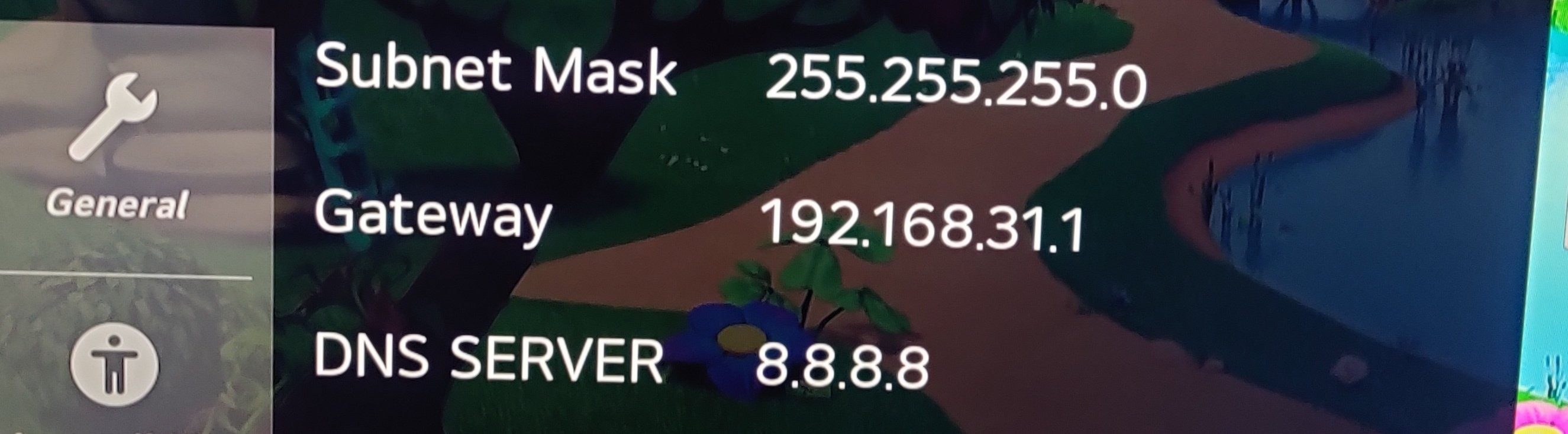

  1. Hi, Yes, mine issue resolved after setting 8.8.8.8 DNS server. You can try at your end and check it is working for you. This LG web os issue. I think they will fix soon. I already reported the issue LG Customer support

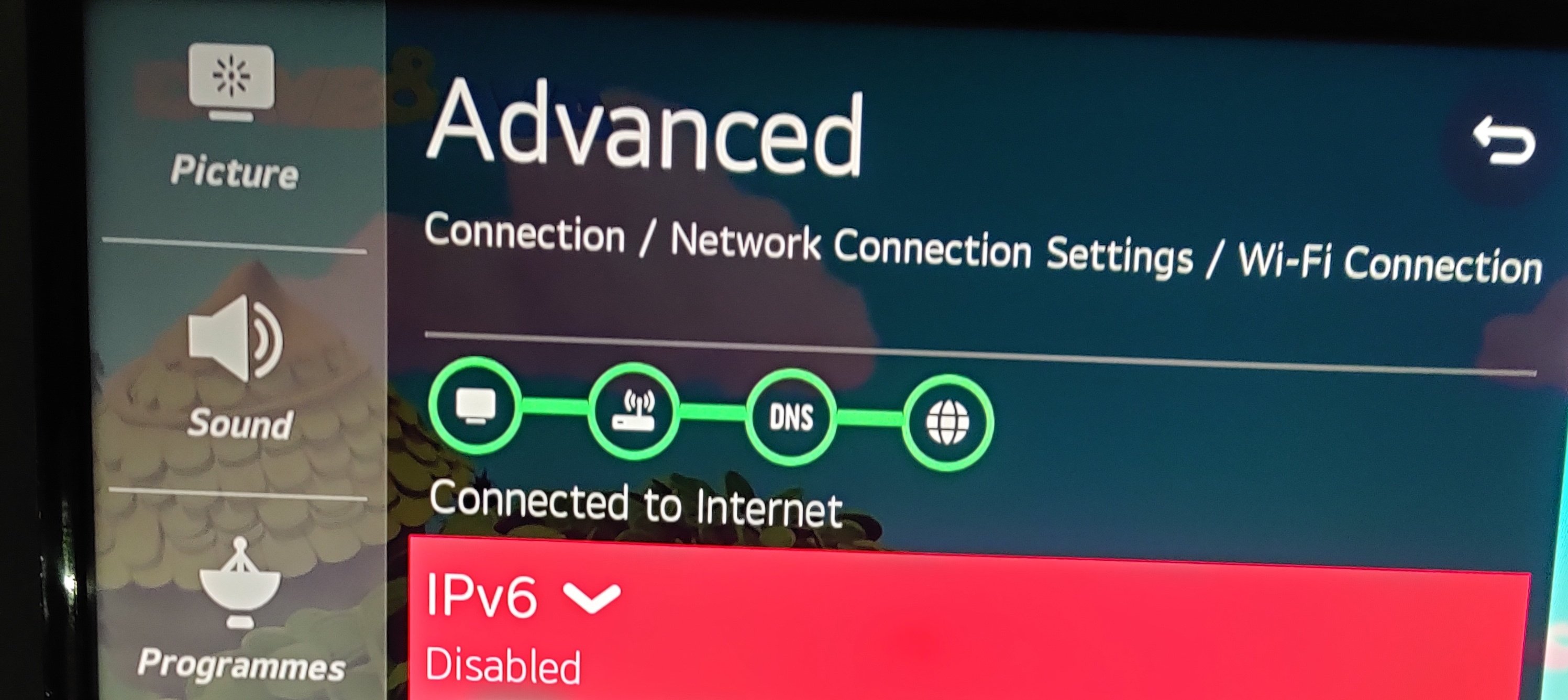

  2. You can go to Advaced WIFI settings ( Once you will connected to WIFI ) Modify DNS Server 8.8.8.8 (Wait WIFI is getting connected ) After that reboot your TV. this solution works for me.

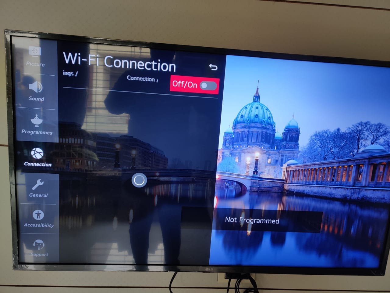

  4. Hi Thanks for reply, I given remote support to LG customer care executive. They said setting are fine and good. They said it takes approx. =~ 4 minutes to connect Wi-Fi, that answer is not valid. explained LG customer care, can check wifi on your smartphone, it takes less than 1 minute to connect. I observed few things, One TV power on, I went to Connection -> WIFI Connection, it shows cursor stuck even didn't turned off WIFI at that time, I will need to wait approx. =~ 4 minutes after that I will change WIFI settings. I think, This is Web Os Bug. Is the TV using a 2.4GHz band, or a 5GHz band? I think 2.5 GHZ Which is the best/strongest signal in the TV room? strongest BTW, attached Image
  5. Hi All, Purchased LG UN 7350PTA 43 inch tv 7 days back. Steps for reproduce 1. Configure TV WIFI with WIFI router 2. Turned off TV 3. Turned on TV 4. Takes approx. 4 minutes to auto connect WIFI, at that WIFI searching time, i did not even seen any WIFI name, it populated all WIFI available after 4 minutes. Contacted LG Customer care, He told it takes 4 minutes to connect WIFI. nowadays Mobile phone is takes approx. 30 seconds to connect WIFI. Note: tried with mobile hotspots, it is same behavior. it could be SW issue from LG TV. Reset TV 2 times but no luck
