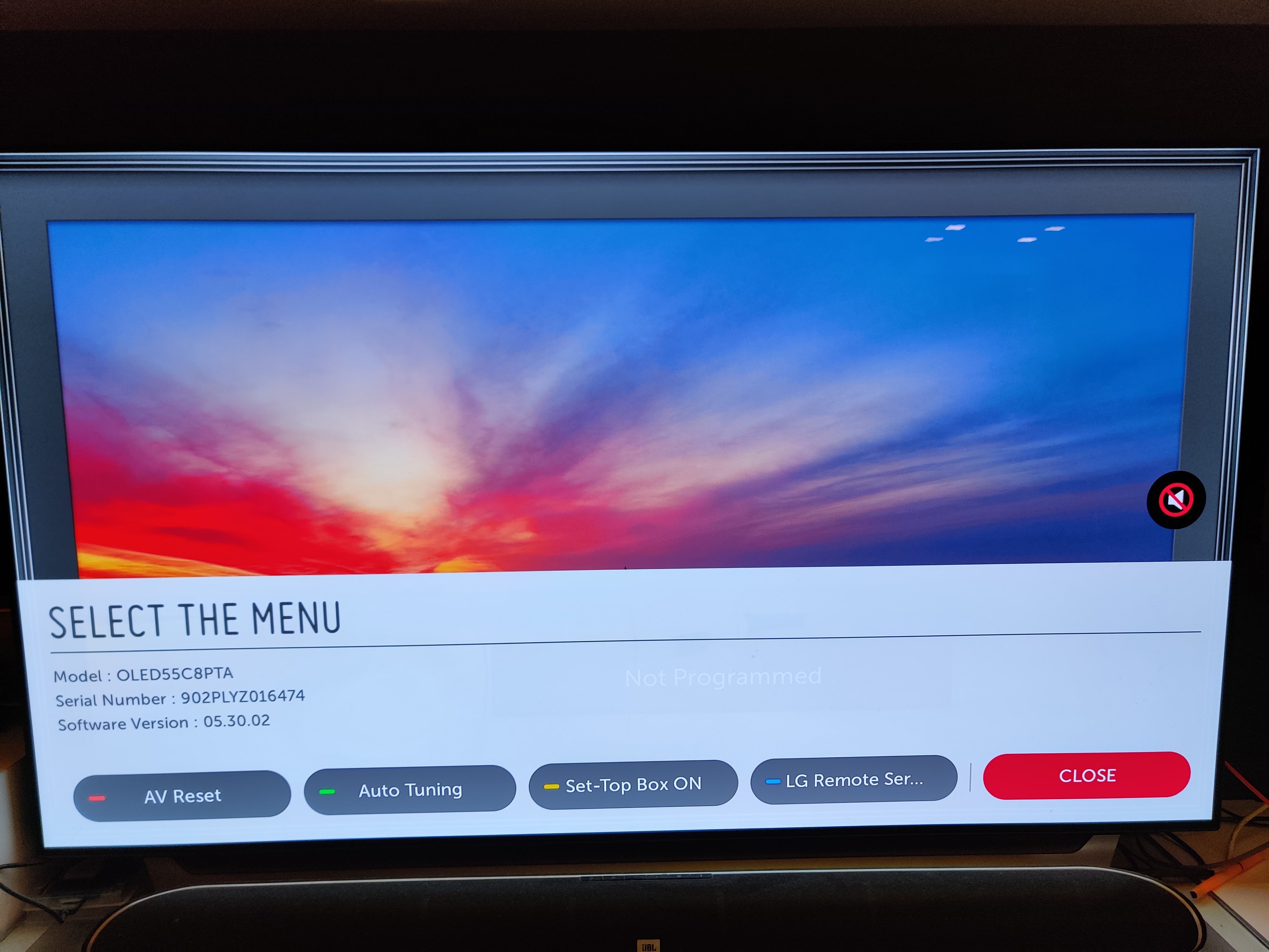

  8. In my case the easier solution is to just disconnect from the connected network and reconnect to the same one. No network switch is required. Only pain is every time I need to key in the password. And the real pain is unable to do a true factory reset. Does anyone know how to do a factory reset. I also downloaded the tv firmware from their website but they are saying that can be installed only if tv's present f/w version is lower than the one in the usb drive.

  11. Unfortunately, the firmware can't be downgraded. LG must provide another update to fix this asap. I am now relieved that other people are also facing the problem. My warranty has been over in May 20, and i was afraid that it is some hw related problem than i am screwed. Let's hope LG addresses this problem asap.
