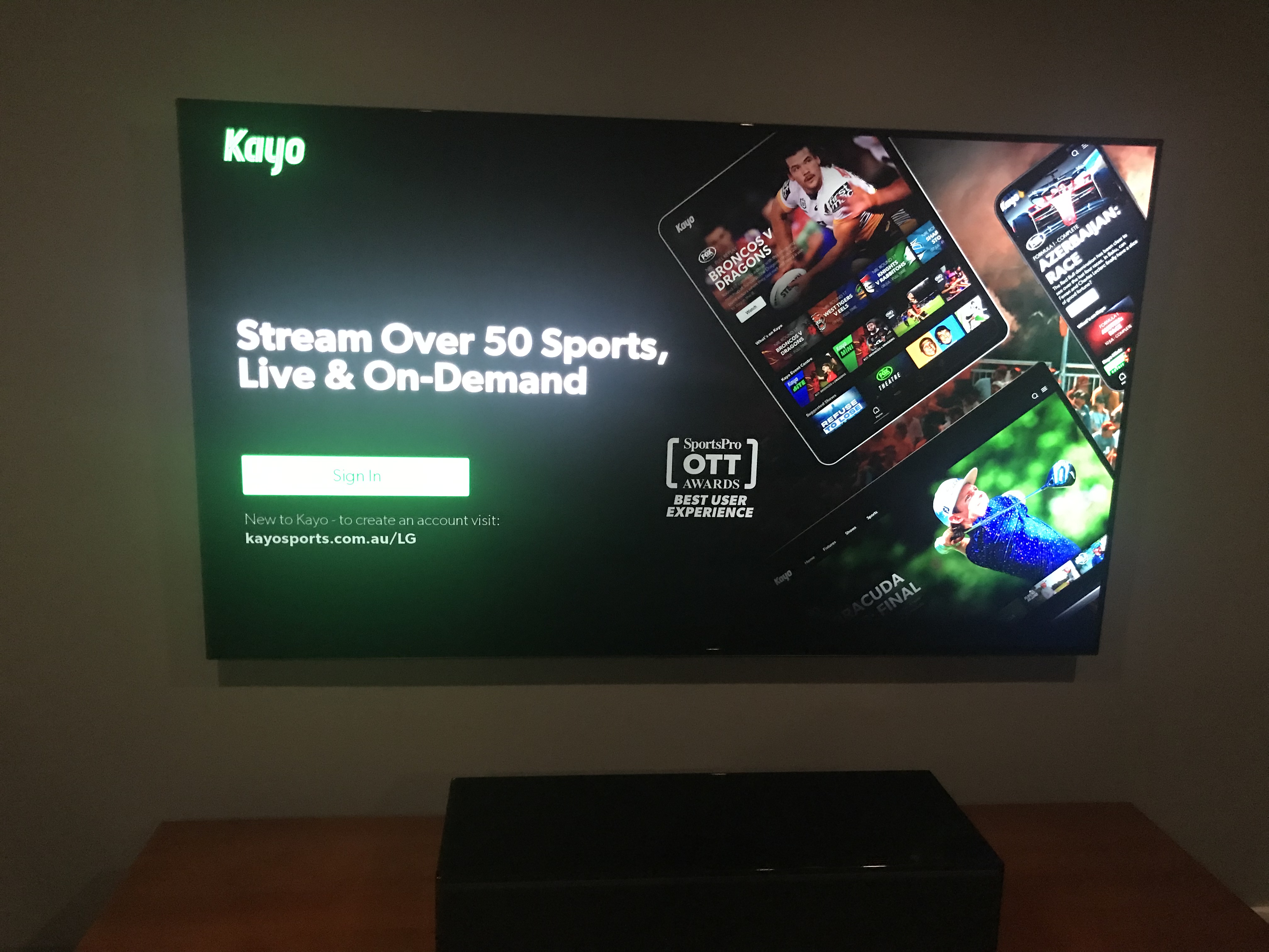

  5. Kayo app does not open when turning on tv. Needs to be restarted. All other apps are fine. Speed is fine, connection is wired.
