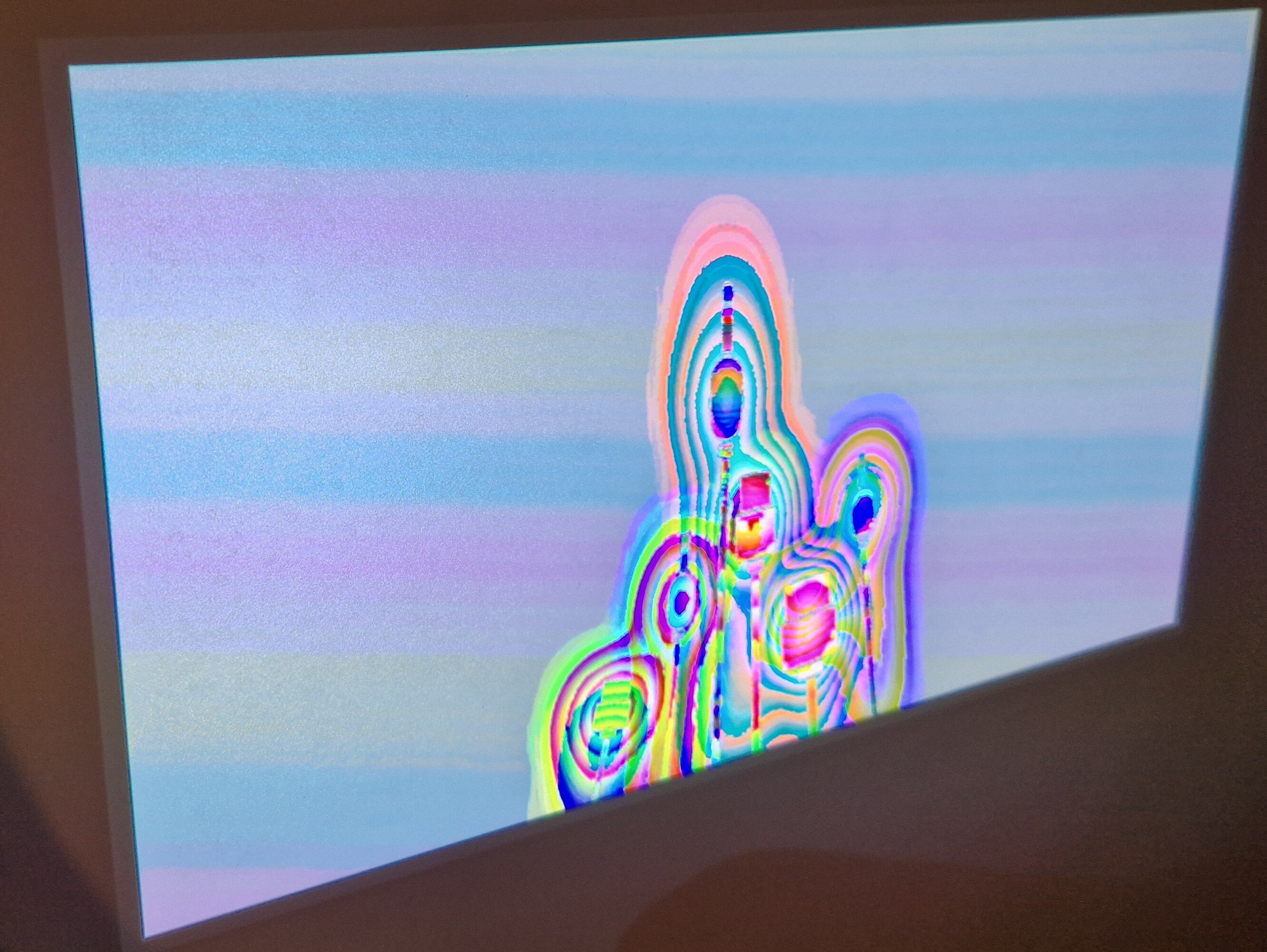

  2. Hi Hardkernel, I would like to know the product code of your device, it is written on the underside of the projector. It is not the same as the model name. My product code matches user Adam Matis's product code and this device is definitely incompatible with this Korean update. The way to unbricking this device is very long and complicated so I will not go into details here, but if there are any users in the same situation feel free to send me a message asking how I did it. I have checked now and this update v04.70.35 has an ID = HE_DTV_W17R_AFAAABAA, which is definitely not compatible with this PF50KG projector. It is not even made for a projector as DTV stands for a digital television. It is also an unreleased beta update (it has NSU in it's name as opposed to USB) so even for compatible products it could have bugs. I think nobody should try using this update on their device unless they really know what they're doing. Finally, the discoloration that occurred when I tried to force my device to run the Korean firmware looked like the image I attached below, completely broken.
  3. Hi, I have spent considerable time unbricking my projector but I succeeded and it is possible. The replacement motherboard was not compatible with my device (it came from a PF50KS-EU model) so in the end I fixed my old motherboard. Model is PF50KG-GL, product code is PF50KG-GL.AEULLAN. The OTAID of my device is HE_PJT_W17X_AAAAGLAA (the ID of the update should match the ID of the device to make sure they are compatible with each other) while the OTAID of the Korean update is HE_PJT_W17Z_AAAAAAAA. I have managed to run the Korean firmware v03.00.17 on my device and can confirm it is NOT compatible (colors look broken, it doesn't respond to button presses and runs extremely slow). The NSU update v03.00.09 is made for my device but I don't think it contains the LG Content Store so I haven't tried it. I have managed to get my device back to stock firmware v03.00.06 and I have installed Youtube ad-free from the Homebrew channel and I'm satisfied. If anyone has a projector of the same model and product code I advise to NOT update to this Korean software. I cannot say anything about any other models and product codes.
