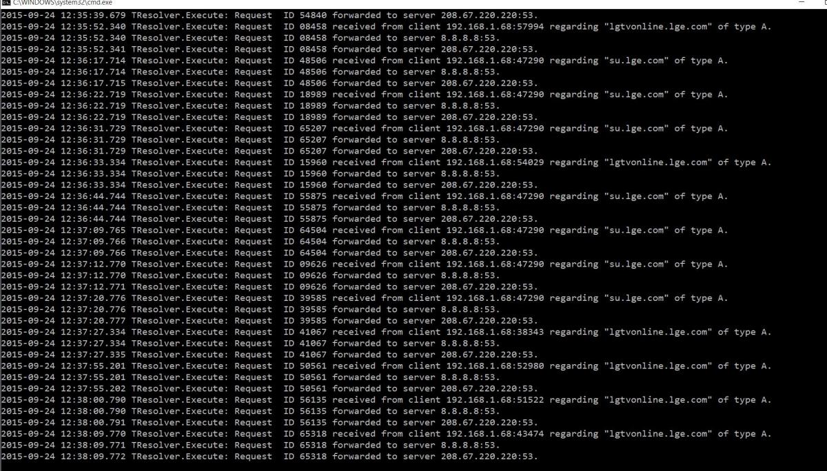

I did try, see post #38. Everything works but when it says its updating nothing happens. Thanks. Maybe the problem is with NZ ISP? Should I try using a VPN? -

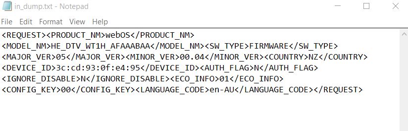

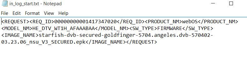

Hi Simon. Thanks for all your effort. I used your new updater but still no luck. I've attached snapshots. TV is a 84UB980-TA. -
How To Downgrade webOS TV Firmware Tutorial
vs2 replied to SIMON's topic in LG TV and LG webOS Smart TV Discussion
Hi Simon. LG New Zealand put an online update to 05.00.04 for my 84UB980-TA but it was a mistake according to them and now the EPG is not working. I tried your method but after accepting the update nothing happened. Could you please add the **UB980 series to the list so I can roll back to 04.62.50. Thanks.
