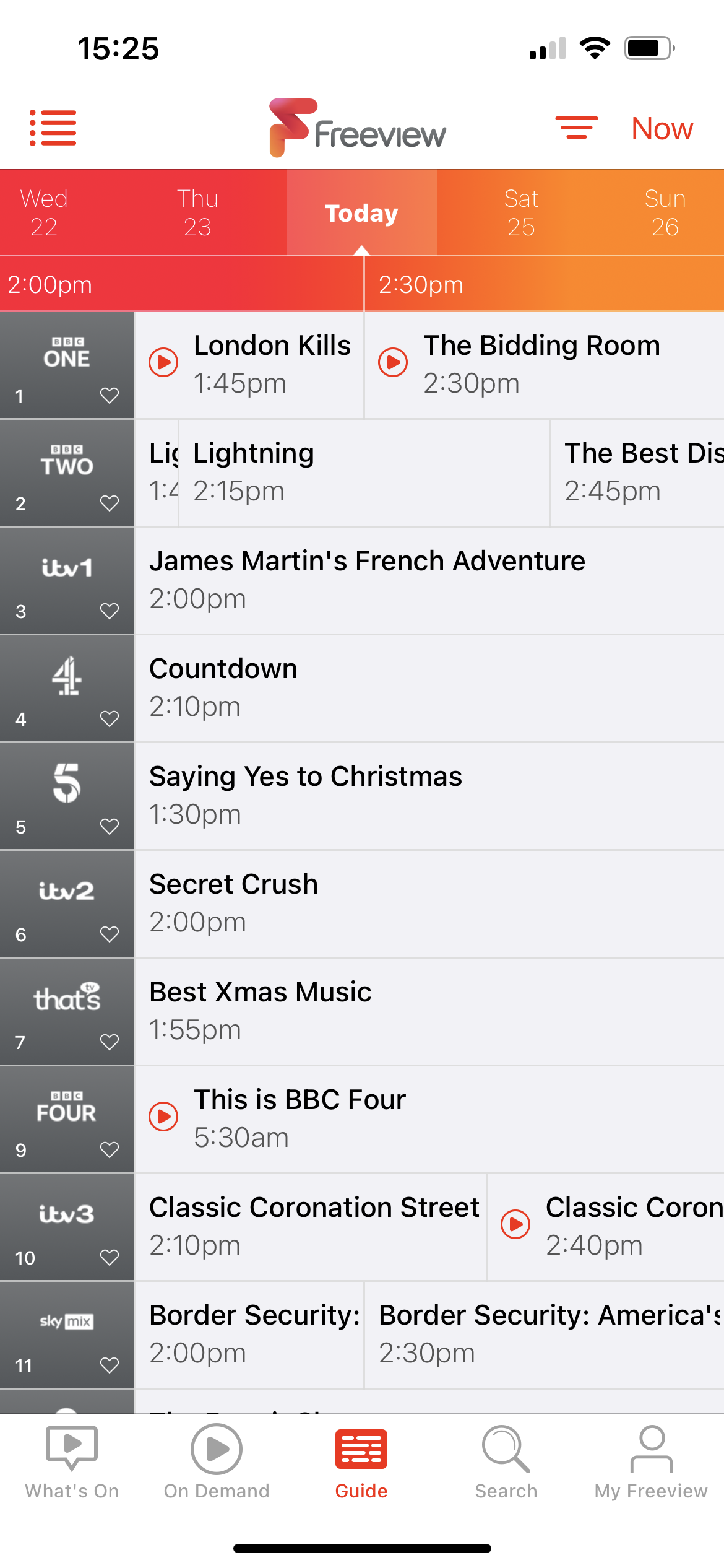

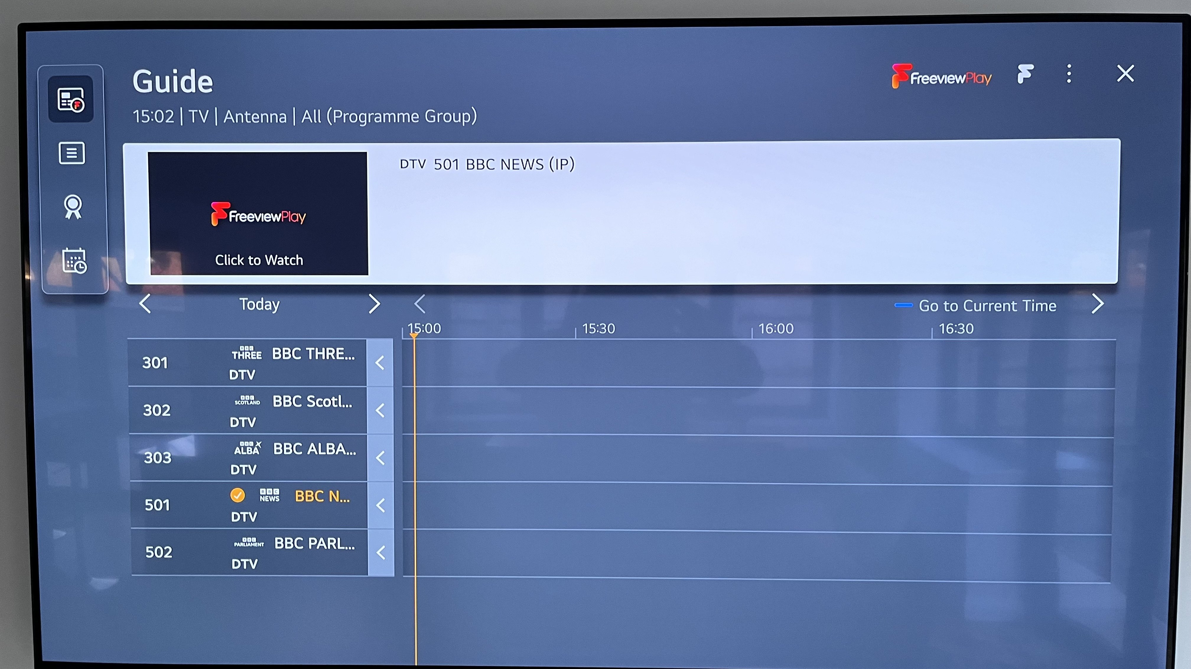

  3. Hi I have an OLED A2 48” 4k, which doesn’t have an aerial but is connected to WiFi. All the streaming services are working fine, but my understanding (From Freeview website) is that the TV guide should be populated with a live Freeview TV schedule that , if you click on a live broadcast, opens it up in the relevant app. E.g. BBC, ITVX, 4 etc. There are a couple of BBC IP channels showing, which play without opening the apps but nothing else. Any ideas? I have the Freeview App on my phone which does exactly what I was expecting above.
