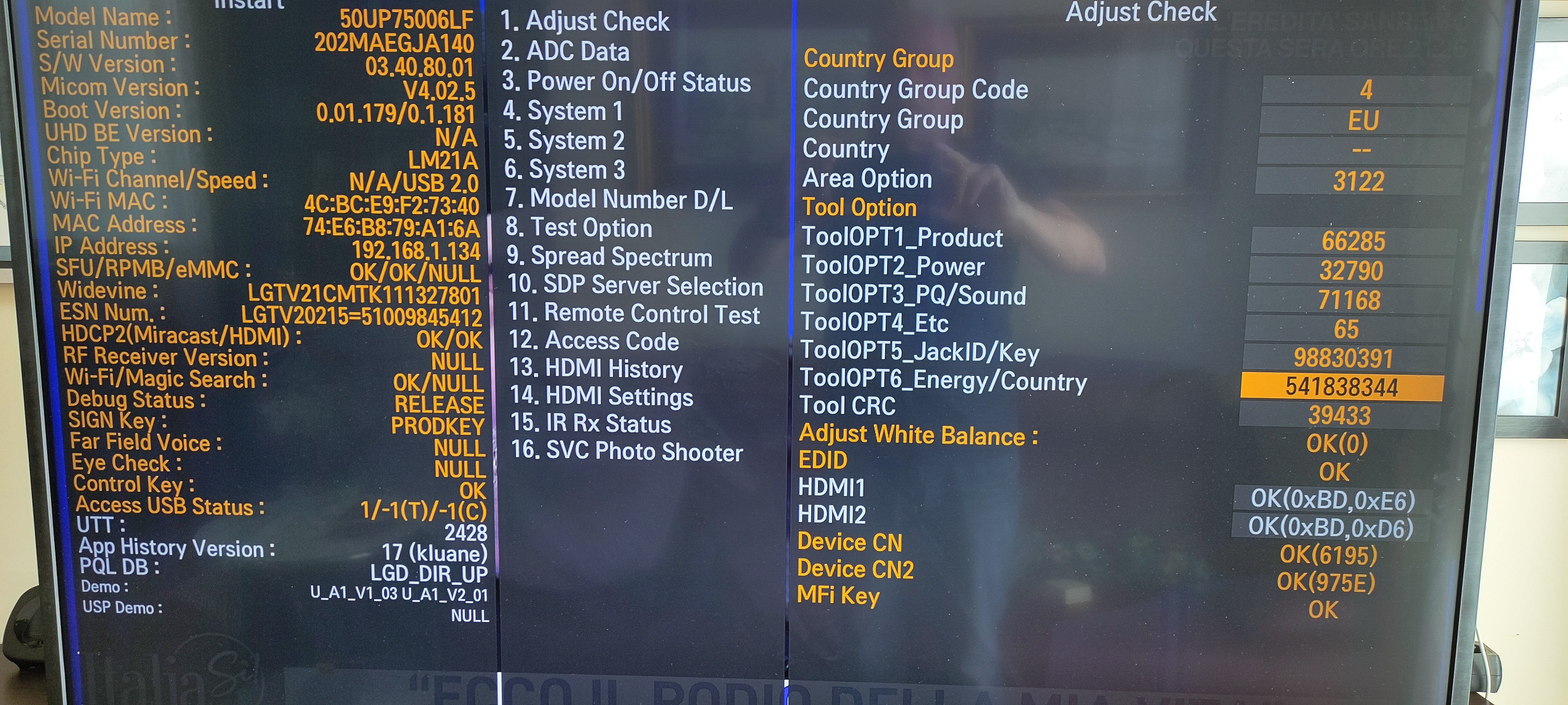

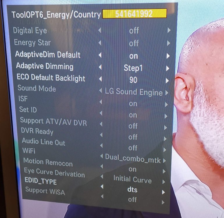

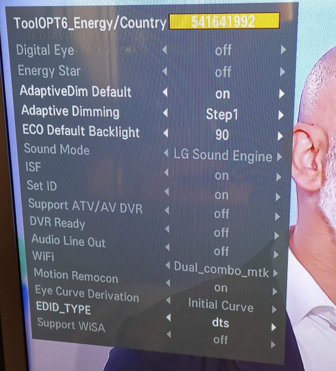

Hi, could you help me please?
Whats the code to enable DVR in my ToolOPT6 menu?
My code now is 541641992

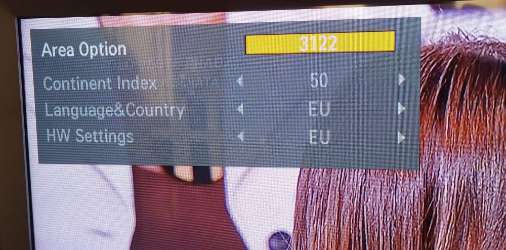

my country is Italy area option code: 3122

Same area code 3122, continent index (50) , language EU, HW EU

I tried to change the area code at ez-adjust menu
tried from 3121 to 3128.
When you change the area code also continent index is changing a bit (i.e. 50--> 52) and some settings at the other menus of ez-adjust
I think the options change without a reboot so you can see what is changed.Tried also reboot after every change.
Unfortunately dvr ready remains off at all the above changes
Also tried to set area code 3642 (ukraine according to
Looking at the options after setting it (without reboot) did not seem to change the dvr ready=off .
Tried reboot and boomm. No Display and the red led on (like on standby).
After calming a little bit ( :) ) and trying several reboots it restarted with last working area code .
Also pressed the "in stop" button  at the virtual remote control (
and maybe this helped also ... or maybe the tv understood that it can not boot multiple times and reset itself...
At normal operation when I press ïnstop" the TV does a factory reset and asks again to be setup (like when I 1st time I powered it)
After all the above I guess(not sure) the area code is not relevant for dvr off setting.

On 11/21/2023 at 8:59 PM, qix70 said:
Thanks to the help I found on another forum I unlocked the recording function and timeshift!
The new code for my TV only changed the 2 necessary functions: DVR ready -> ON and support ATV DVR -> ON
This code worked perfectly on my small TV 28TN515S (Italy)

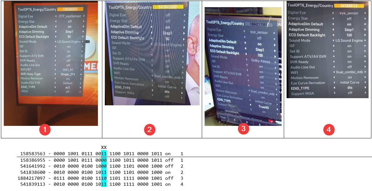

In my ToolOPT6_Energy/Country menu:
541641992 - corresponding binary 0010 0000 0100 1000 1100 1101 0000 1000 (DVR OFF)
541838600 - corresponding binary 0010 0000 0100 1011 1100 1101 0000 1000 (DVR ON)
Obviously this is the specific code of my model, each TV has its own code depending on its functions.
You have to be very careful not to modify the other functions to avoid the risk of brick the TV !!!
I understood that you have to convert the decimal code into binary and change the bit corresponding to the function from 0 to 1 and then convert it back to decimal and insert it in place of the original. After changing it, ON will appear on the 2 functions we need. 🙂
then exit the menu and perform a total reset of the TV and after the initial settings you will find recording and timeshit (called "time machine" by LG) active!
Hope this helps

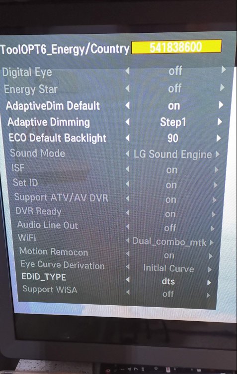

541838600 = dvr enabled
541842696 = dvr enabled + dolby atmos in sound option.
541846792 OR 541850888 = dvr enabled + DTS Virtual X
you can contribute here
you can enable but you must change country from menu because if you select italy, pvr still disabled, it's a SIAE legal stuff.

Thank you,
541838600 it's OK , DVR and Timeshift enabled !👍
I haven't changed country and everything works fine 😀

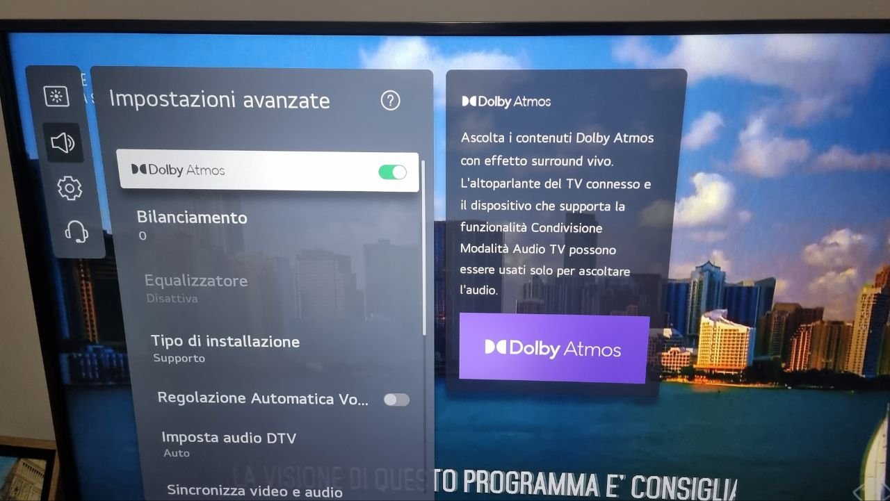

you can enable dolby using 541842696,  it will make appear "dolby atmos" in sound settings like the photo. you should have a better sound quality.
I succesfull activate it on my 55up7500 that according to LG site, i should't have :D
Also a friend of mine would like to activate dvr... His model is 55UP75006LF also you have this tv?
I haven't had time to check the original code on the service menu yet..
Can you confirm me if the dvr unlock code is the same - - >541838600 ?

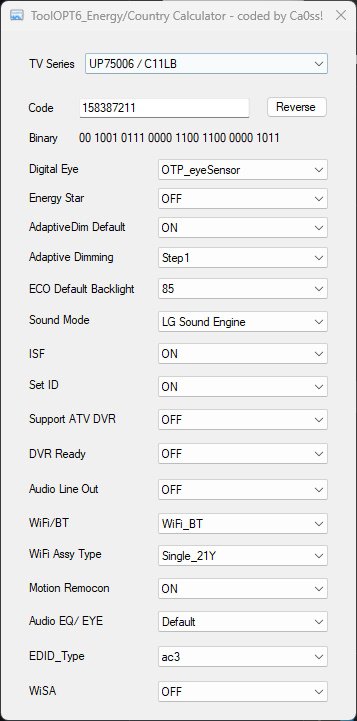

i can't confirm. some tv are the same but have little changes like the wifi module etc. if you use that code, you can enable pvr probably but there are a lot of chance that he will disable wifi :)
so please, read the original code. fortunately yout tv is like mine (mine have same model number) and is fully supported by my calculator. open Github and search for "ToolOPT6" and you will calculate by yourself
In my experience you can enable "Support ATV DVR", "DVR Ready" and set "Sound Mode" to Dolby Atmos without any issue.
N.B. The code "541838600" is not for UP75 Series but it still a vadid code. If you put on the tv, you will disable "Digital eye", lost WiFi and Bluetooth functionality and disconnect all smart remote. Please don't do that

Now I have LgNetworkRemote App to enter on Service Mode on my LG50UP70056LF.
BUT I CAN'T USE RECORDING. There is a solution???
Thank you
you enter the wrong menu, you should enter on ez-adjust menu, not instart.
the correct button is the red-cicled one, the default password to enter is 0413.
based on the code i see on your photo, you should have already dvr enabled, you can enable dolby atmos using this code "541842440"
if long pressing the red button say that your tv does not support recording, you must change country to other one (like germany)

You have a new 2024 model, a c4. even if you open the service menu, you cannot edit the value. You can unlock that with jailbreak, but till today there is no publick jailbreak avaiable for you tv
Thank you very much for your Help Asistenza. Do you have Viber or Telegram ? Are from Greece?
On 11/26/2024 at 11:48 AM, Vladimir Voronov said:
The ability to record TV programs can be enabled by reprogramming two bytes in the EEPROM of the TV using a programmer from Aliexpress
Instructions are here
Hello Dear Friend. I have a new model 2024 , and here in Greece we have the same problem! The model is LG OLED TV 48C46LA 48" 4Κ Ultra HD WebOS24. What I can do to enable the DVR Recording? In the example that you gave is an old model. Thanks in advance and best regards!
The method works on all LG models, regardless of the year, here for example - not 2024, but TVs from the latest years of production
Thank you very much for your help! I'll watch what you send me!
On 6/11/2024 at 4:56 PM, Assistenza MailProva said:
Yes, the DVR work by setting Germany as the country
No, l'ordine dei canali non è quello italiano
to short correctly the channel list, you must use an external app called ChanSort.
1. using the italian setting, export channel list to USB. Copy the .TLL file on the pc and name it ITALIAN.TLL
2.Change country to Germany and export again the channel list. Copy the .TLL file on the pc and name it Germany.TLL
3. Open ChanSort and choose Germany.TLL. the program will ask you what you want to do, choose an option that say something like "short channel like a existing list" (italian: "Copia Elenco canali: ordina i canali come in un elenco di riferimento) and choose  ITALIAN.TLL as reference list.
If the app trow some exception ignore click ok and go on
Save the shorted list using the original name "GlobalClone00001.TLL" and impot back on the tv
if you need the italian guide google this: "attivazione timeshift e registrazione su
lg"
Else contact me on telegram @Ca0ss93; i will send you a guide
Changing country from Italy to Germany the DVR works but HbbTV  for Mediaset Channels not work.  HbbTv Rai - La7 - Warner channels work!
non usando questi servizi non mi sono mai posto il problema, se trovi una soluzione fammi sapere :)
I don't use this service, so i don't search any solution to this. if you manage to solve it, please let me known
