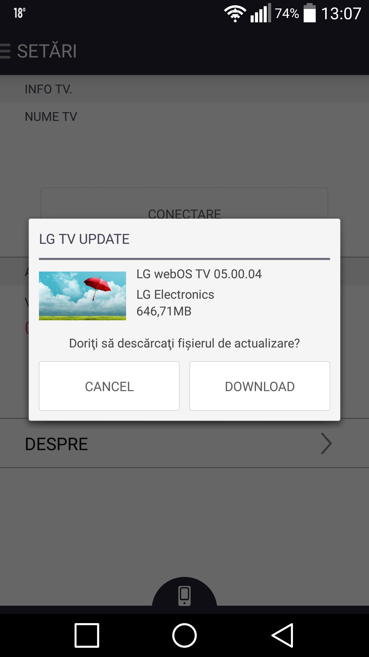

New firmware (05.00.04) available for manual update dated 17/sept/2015.

New update available via Wi-Fi. Installing now.
05.00.04 on 730V.
Region: Macedonia
Previous firmware was 04.65.05, installed via USB.
Previous webOS TV Version was 1.3.3-3953 (afro-arches)
