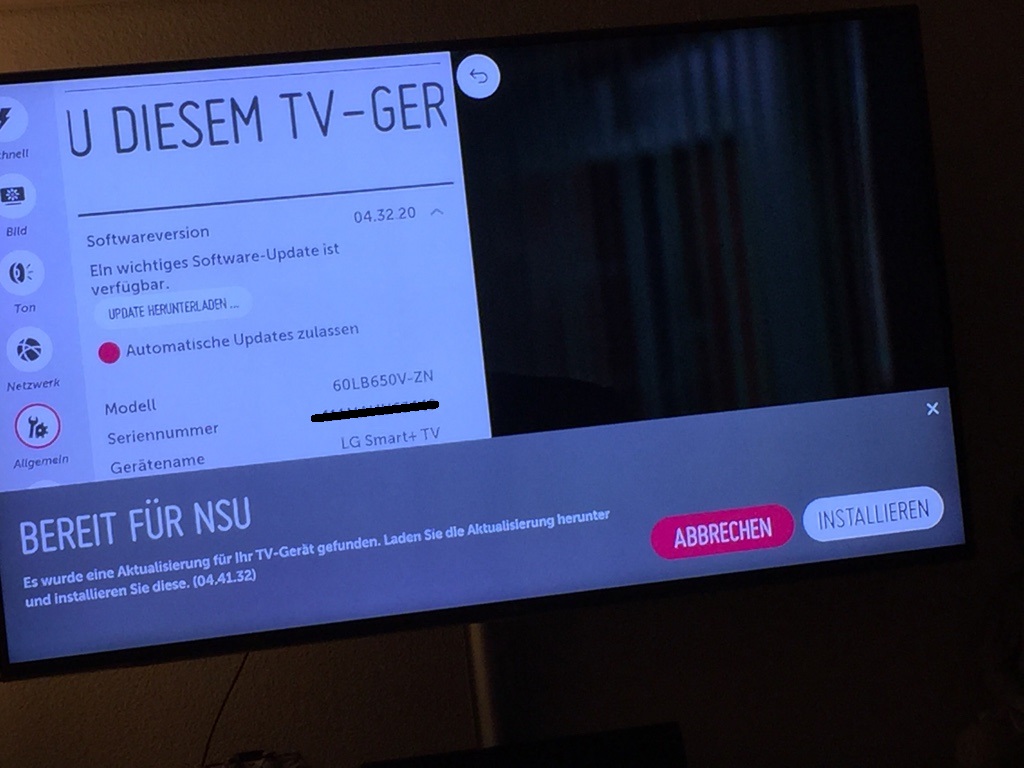

Every time I try to update, I get reply "Prüfen auf Aktualisierung nicht möglich" after several minutes. This does mean that an update is not possible? Internet Connection is working well, Youtube and Internet is working.

Just updated to
04.41.32
1.3.2-3232(afro-arches)
Changed location to Germany and updated over the wifi.
