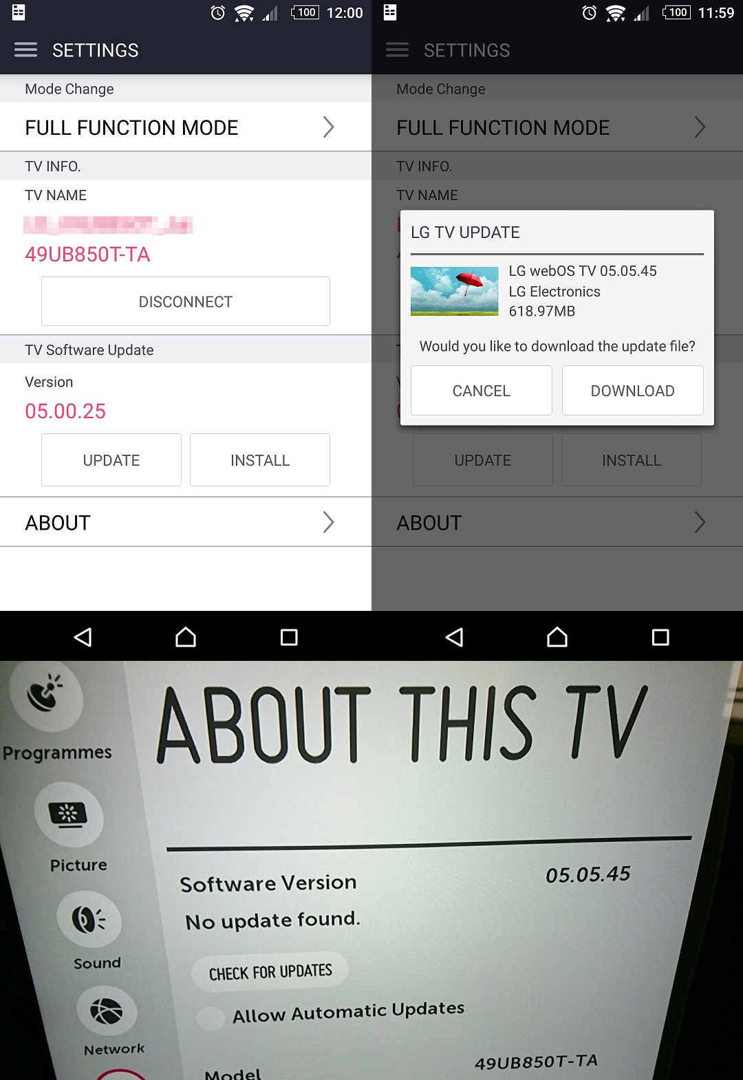

Singapore 49UB850T got update alert for 05.05.45 on 26/Dec. previously is 05.00.25. I believe it is still WebOS 1.x
It tally with
[05.05.45]
1. Disable the skype due to spec out.
Edited by Jai
