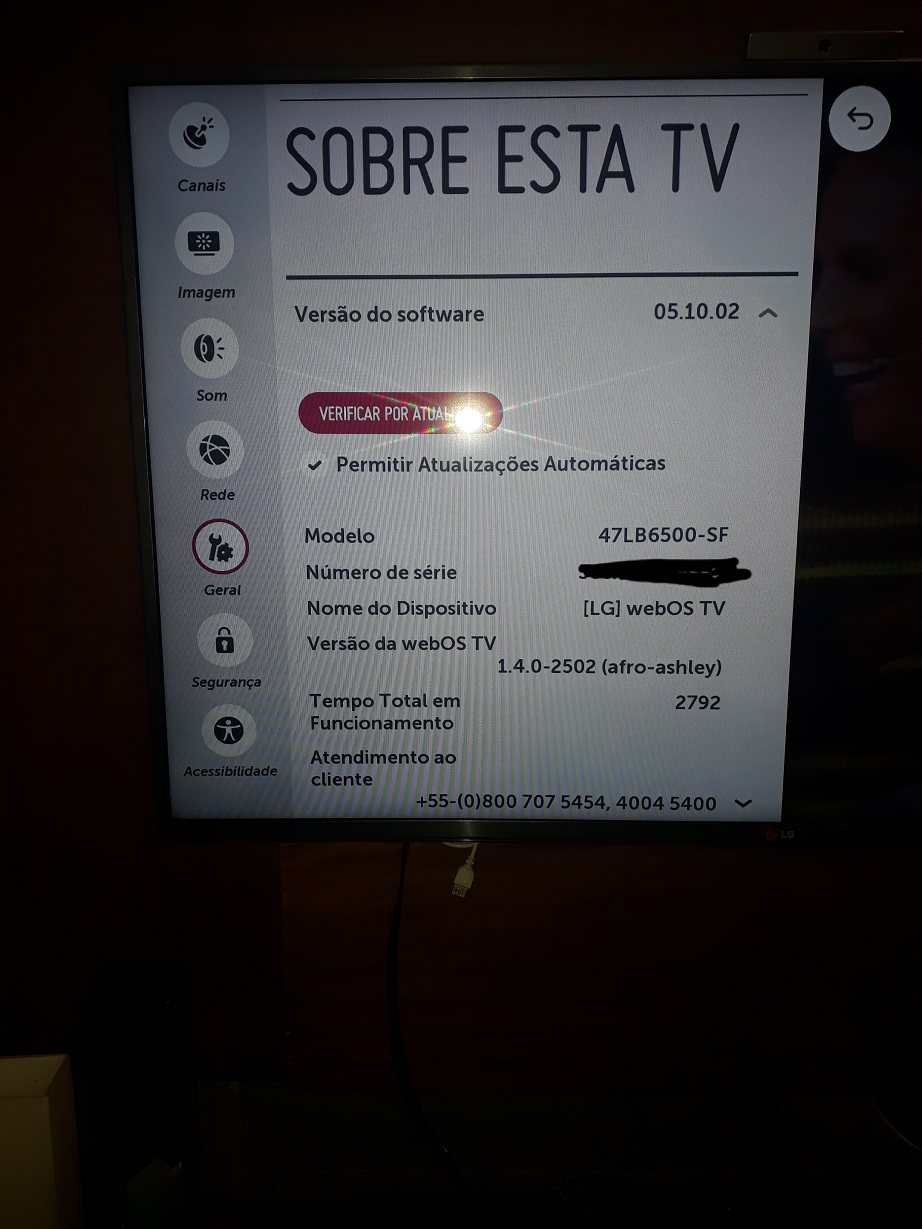

I would like to know if have some firmware compatible with LG 47LB6500. This is the latest firmware wich i install...
Expand
As far as I can see you installed a BETA 05.10.02 long time ago. LG Company did not allow firmware to be downgraded. You'll never get official update because official firmwares starting with 05.05.xx but you have 05.10.xx,  so only way is unofficial downgrade to latest official for your region (Brasil). Process is a bit complicated and here on this forum you have detailed tutorial how to. HERE IS TUTORIAL
Attention: You can destroy (brick) your tv set if something going wrong in the downgrade process.
Cheers! Dejan
