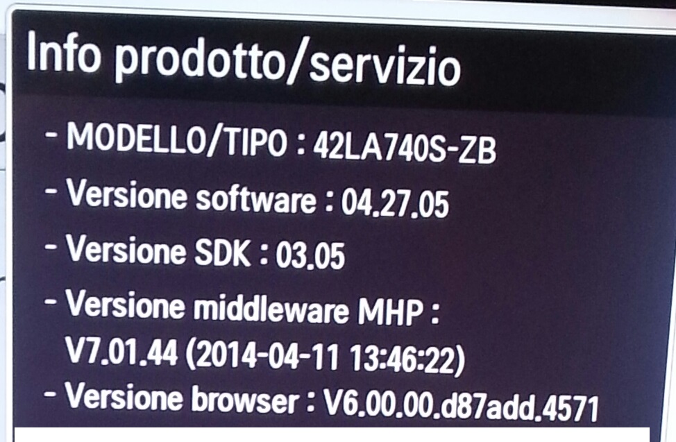

Hi! I started having this annoying issue on my 42" 42LA740S after an update, probably the same as you. Out of the box it was possibile to switch language and subtitles while streaming (I use Plex as media server on my PC). I'm trying to get an answer from the LG italian support, but I expect nothing  :unsure:

Are you sure it works streaming from a DLNA server like Plex? I just received last update (04.27.05) but this ain't changed. What is your software version?
I attach a detailed screenshot of my sw version  :)
