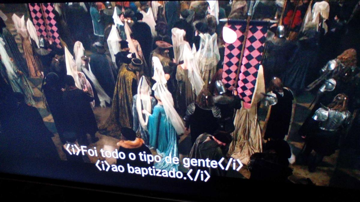

I recently bought an LG lb730v and i have a problem when i see movies trough a usb pen. Sometimes the subtitles appear with a strange symbol and i tried to switch the codification but nothing works. It happens with all movies, series etc etc...
Does someone now how to solve this problem?post-1895-0-85936200-1416763341_thumb.jpg

Well, what can I say.... it appears the TV can't handle italic formatting <i> tags.
You should report this to LG support, but I don't have any hope of LG fixing this any time soon. They seem to have given up on webos alltogether. They LOVE To sell new tv sets, but fixing these kinds of "basic" issues with their software seems to be very far down on their list of priorities.
I love the new thinking with webos, but I absolutely HATE having anything to do with LG. They really just doesn't seem to give a damn...
/Henrik - who really want to throw an egg on the president of LG...

I think that is nothing to do with Italic. It happens when the character that is speaking don't appear on the image. It is a really strange thing
Isn't this the case when someone is speaking off camera, the subtitle is in italic. I have checked at least one movie here at home and that is definitely the case.
A few years ago I developed a custom movie viewer for Windows Phone, and subtitling was one of the features I was working on, and even in that small viewer, we supported proper subtitle formatting, including bold and italic... I am baffled by the fact that webos can't get these things correct.
/H

Does this solve the problem with <i> tags not being rendered correctly?
/H
http://www.lgwebos.com/topic/1660-better-subtitle-handling-parsing-the-ii-and-bb-tags/
Until they fix the issue, the only way is to fix the subtitles by replacing <i>, </i>, <b>, </b>, <font...>, </font...> etc. tags with 'notnihg'. Here you are the macro for UltraEdit to get rid of <i>&<b> tags:
