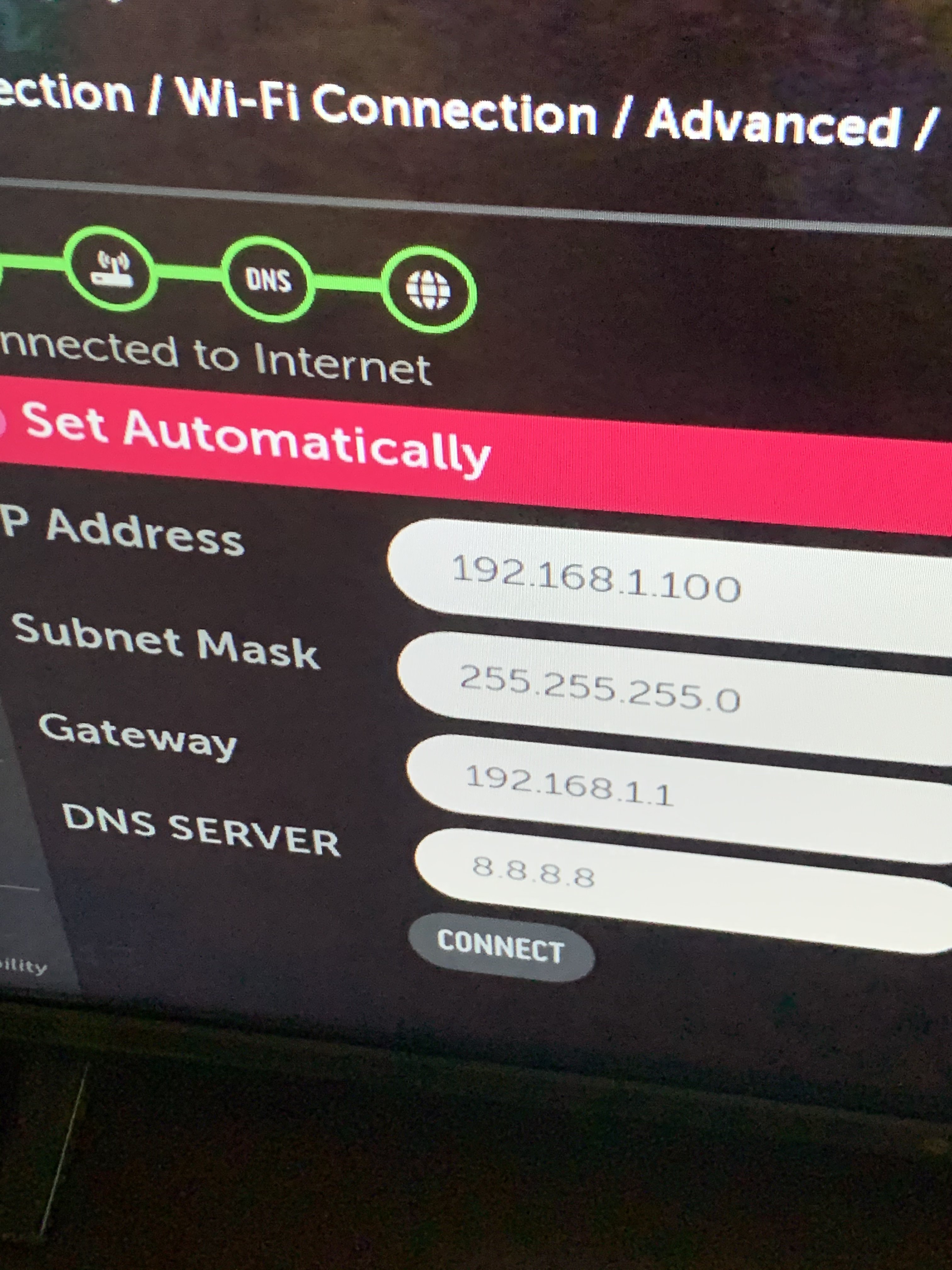

I had the same problem app would not update. I already have DNS 8.8.8.8 as default from the  router. The way I got around it was to go  to the TVs Internet Settings and turn off IPV6. I was then able to update apps.
I had the same issue and figured out that i have to change the DNS server address to 8.8.8.8
now its totally works for me.
navigate settings->network->connection->wifi connection->advanced wifi settings->edit
set dns server to 8.8.8.8

Easy fix folks.
Go into your network settings.
Click on whichever connection your have (wired or wireless connection )
Scroll to the bottom and select edit
uncheck set automatically
change the DNS server to 8.8.8.8
click connect and bam you’re good to go
