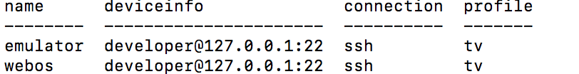

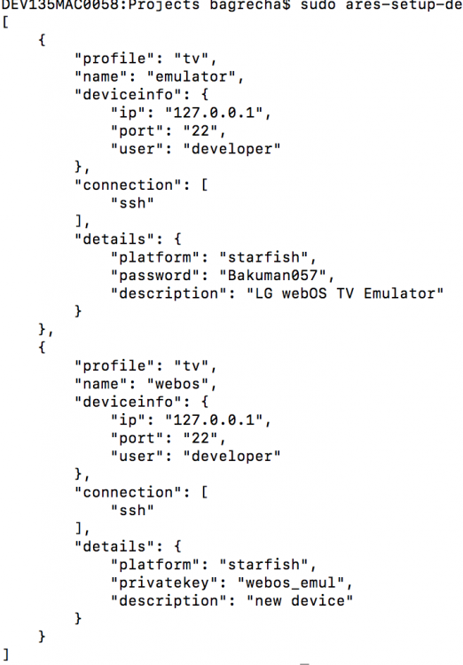

when i try to install the app to the emulator it works fine but when i try to install the same app on the signage tv (webos) i get an error ares install failed,, can anyone here help me out, i can install the app to the tv in other way like exporting the app then installing it on the signage tv using remote option or using usb..kindly do help.. using the webos IDE it fails
error::
24/01/20 4:00:37 pm : [Package] Creating package com.lg.app.signage_1.4.0_all.ipk in /var/www/html/iEvince/client/OutputIPK/client_Signage_TV
24/01/20 4:00:37 pm : [Package] Success
24/01/20 4:00:37 pm : [Install] Installing package /var/www/html/iEvince/client/OutputIPK/client_Signage_TV/com.lg.app.signage_1.4.0_all.ipk
24/01/20 4:00:39 pm: [Install] ares-install ERR! ares-install: install failed
error::
I have the same problem.

Hi all,
i have a same problem, when I run
ares-install com.domain.app_1.0.0_all.ipk -d emulator -v
it is failed to

ares-install verb Resolver#getDeviceBy()     name: 'emulator',
ares-install verb Resolver#getDeviceBy()     type: 'starfish',
ares-install verb Resolver#getDeviceBy()     description: 'LG webOS TV Emulator',
ares-install verb Resolver#getDeviceBy()     host: '127.0.0.1',
ares-install verb Resolver#getDeviceBy()     port: 22,
ares-install verb Resolver#getDeviceBy()     username: 'developer',
ares-install verb Resolver#getDeviceBy()     files: 'stream',
ares-install verb Resolver#getDeviceBy()     noPortForwarding: false,
ares-install verb Resolver#getDeviceBy()     indelible: true,
ares-install verb Resolver#getDeviceBy()     password: 'test',
ares-install verb Resolver#getDeviceBy()     privateKeyName: undefined,
ares-install verb Resolver#getDeviceBy()     privateKey: undefined,
ares-install verb Resolver#getDeviceBy()     display:
ares-install verb Resolver#getDeviceBy()      { name: 'emulator',
ares-install verb Resolver#getDeviceBy()        passphase: undefined,
ares-install verb Resolver#getDeviceBy()        conn: [Object],
ares-install verb Resolver#getDeviceBy()        devId: null,
ares-install verb Resolver#getDeviceBy()        addr: 'ssh://[email protected]:22',
ares-install verb Resolver#getDeviceBy()        order: '0',
ares-install verb Resolver#getDeviceBy()        profile: 'tv',
ares-install verb Resolver#getDeviceBy()        privateKey: undefined },
ares-install verb Resolver#getDeviceBy()     lunaSend: '/usr/bin/luna-send-pub',
ares-install verb Resolver#getDeviceBy()     lunaAddr:
ares-install verb Resolver#getDeviceBy()      { install: [Object],
ares-install verb Resolver#getDeviceBy()        remove: [Object],
ares-install verb Resolver#getDeviceBy()        list: [Object],
ares-install verb Resolver#getDeviceBy()        launch: [Object],
ares-install verb Resolver#getDeviceBy()        terminate: [Object],
ares-install verb Resolver#getDeviceBy()        running: [Object],
ares-install verb Resolver#getDeviceBy()        getStorageList: [Object],
ares-install verb Resolver#getDeviceBy()        deviceInfoSystem: [Object],
ares-install verb Resolver#getDeviceBy()        deviceInfoConfig: [Object] } } ]
ares-install verb installer#waterfall callback err: Error: Please check the device IP address or port.
ares-install verb installer#waterfall callback err:     at Error (native)
ares-install verb installer#waterfall callback err:     at Object.c.changeErrMsg (/usr/local/share/webOS_TV_SDK/CLI/lib/base/error-handler.js:3:237)
ares-install verb installer#waterfall callback err:     at Socket.<anonymous> (/usr/local/share/webOS_TV_SDK/CLI/lib/base/novacom.js:15:113)
ares-install verb installer#waterfall callback err:     at emitOne (events.js:96:13)
ares-install verb installer#waterfall callback err:     at Socket.emit (events.js:188:7)
ares-install verb installer#waterfall callback err:     at emitErrorNT (net.js:1281:8)
ares-install verb installer#waterfall callback err:     at _combinedTickCallback (internal/process/next_tick.js:80:11)
ares-install verb installer#waterfall callback err:     at process._tickCallback (internal/process/next_tick.js:104:9)
ares-install info finish(): Error: Please check the device IP address or port.
ares-install info finish():     at Error (native)
ares-install info finish():     at Object.c.changeErrMsg (/usr/local/share/webOS_TV_SDK/CLI/lib/base/error-handler.js:3:237)
ares-install info finish():     at Socket.<anonymous> (/usr/local/share/webOS_TV_SDK/CLI/lib/base/novacom.js:15:113)
ares-install info finish():     at emitOne (events.js:96:13)
ares-install info finish():     at Socket.emit (events.js:188:7)
ares-install info finish():     at emitErrorNT (net.js:1281:8)
ares-install info finish():     at _combinedTickCallback (internal/process/next_tick.js:80:11)
ares-install info finish():     at process._tickCallback (internal/process/next_tick.js:104:9)
ares-install info finish():  err: Error: Please check the device IP address or port.
ares-install ERR! ares-install: Error: Please check the device IP address or port.
ares-install verb Error: Please check the device IP address or port.
    at Error (native)
have anybody any idea?
