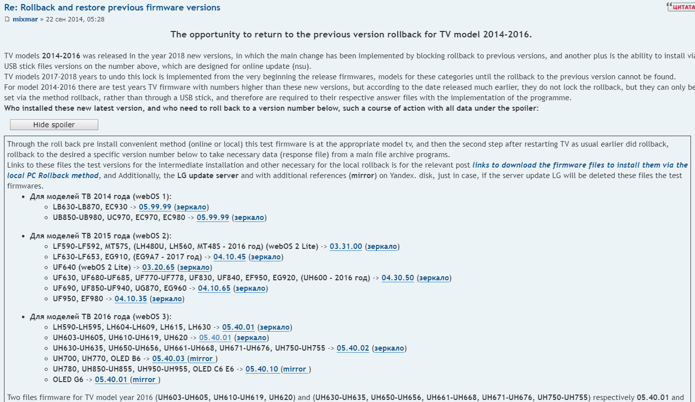

@harry201204  I was able to downgrade my firmware using an epk file I found on a russian forum. After installing this one I could then install the  official ones from the LG.
Just make sure to edit the CheckSWManualUpdate with the SW version you will be using.
http://webos-forums.ru/topic3157.html
Translated - http://www.microsofttranslator.com/bv.aspx?from=&to=en&rr=DC&a=http%3a%2f%2fwebos-forums.ru%2ftopic3157.html
Look for the files listed in this post:

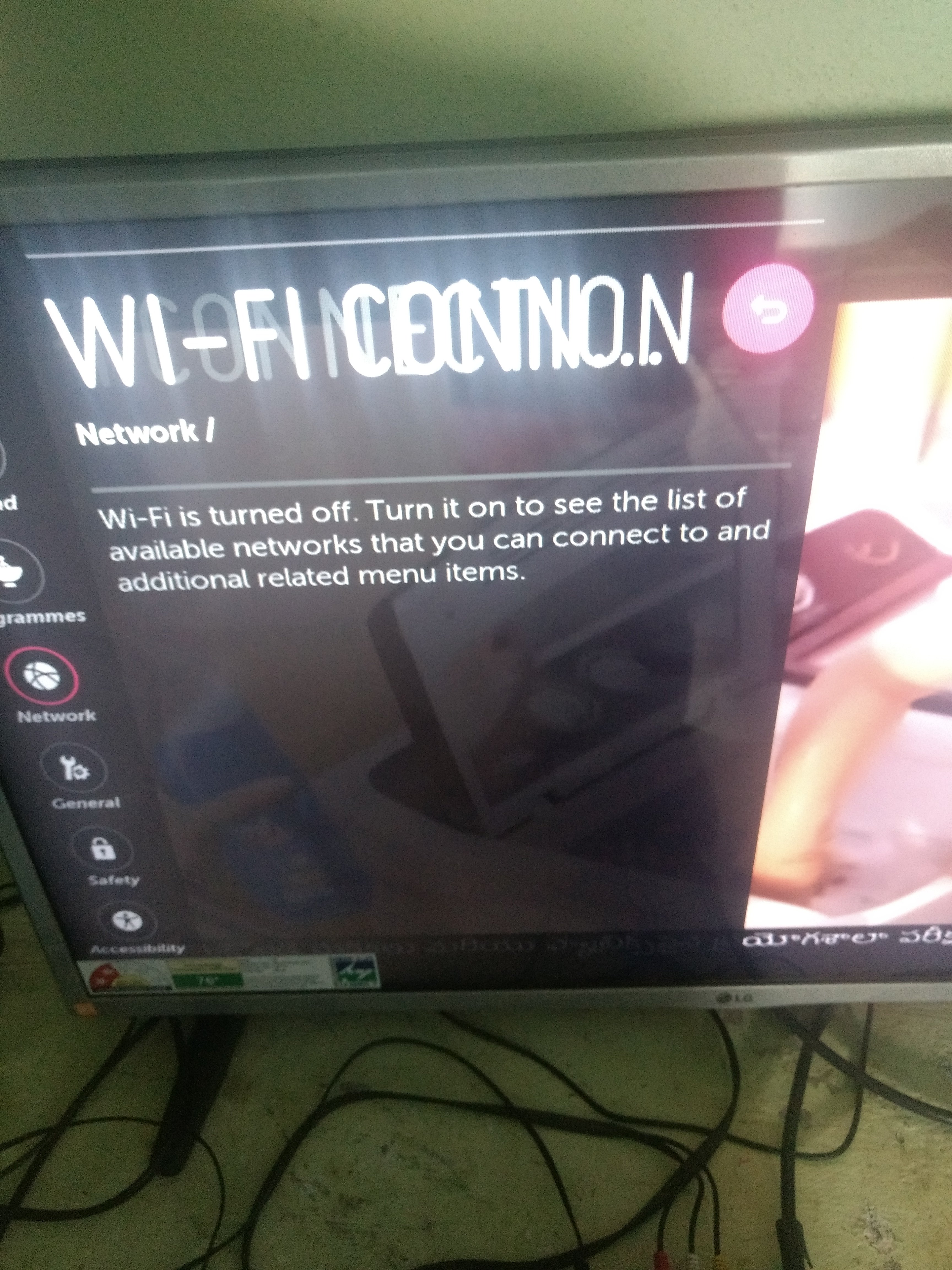

After update latest version 5.80.25 my TV wifi turned off its doesn't opening .so how can I downgrade without WiFi or internet
Remaining all functions working fine.
Issue is wifi turned off
Wifi-Direct  turned off
All internet options turned off 😭😭😭
Model: LG 32LJ573D-TA
LG WEBOS SMART TV
ITS  ONE year old ..
Please help me 😭😭😭😭😭😭

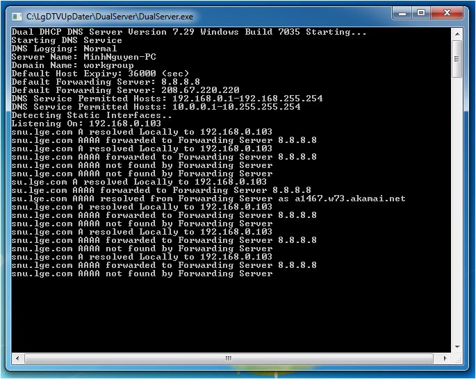

Mình đã làm như bạn hướng dẫn nhưng vẫn không được. giúp tôi!
HE_DTV_W17P_AFADABAA
<RESPONSE><RESULT_CD>900</RESULT_CD><MSG>Success</MSG><REQ_ID>00000000019044989056</REQ_ID><IMAGE_URL>http://snu.lge.com/SWDownload.laf</IMAGE_URL><IMAGE_SIZE>841527141</IMAGE_SIZE><IMAGE_NAME>starfish-dvb-secured-k3lp-573.drto.k3lp-57304-04.70.04-prodkey_nsu_V3_SECURED.epk</IMAGE_NAME><UPDATE_MAJOR_VER>04</UPDATE_MAJOR_VER><UPDATE_MINOR_VER>70.04</UPDATE_MINOR_VER><FORCE_FLAG>Y</FORCE_FLAG><KE></KE><GMT>29 Sep 2017 06:46:48 GMT</GMT><ECO_INFO>01</ECO_INFO><CDN_URL>http://su.lge.com:80/GlobalSWDownloadCdn.laf?IMG=/201709/starfish-dvb-secured-k3lp-573.drto.k3lp-57304-04.70.04-prodkey_nsu_V3_SECURED.epk</CDN_URL><CONTENTS></CONTENTS></RESPONSE>
Edited by minhnguyen4575
bổ sung thông tin

      It is unprofessional on part of LG TV that they do not resolve the basic issue of adding app gCmob in their app store.
      My 50UT80506LA LG WebOs TV does not support my office security camera system via wifi to TV.  We need (gCmob app) in list of app.
      I can't connect my office camera via Wi-Fi to LG-TV. No body in LG TV technical team is proactive in resolving the issue of customer. They are more happy to befool the customers, rather than looking for technical solution through wider thinking.
      Please talk to you top management and make a visit to our office to understand the customers plight..
      Please respond to customers needs.
