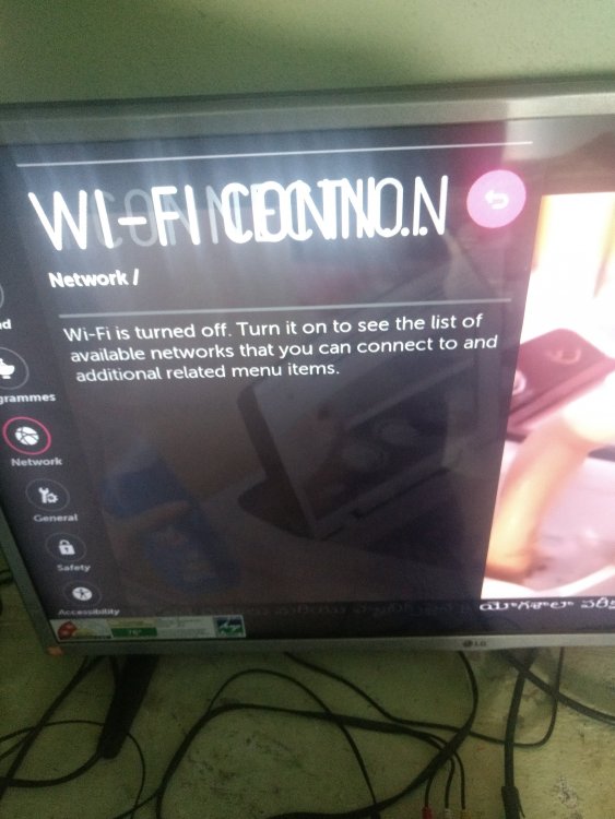

      Hey guys !!!
      I have a UHD UJ634v  LG webos Tv  that lately an error message pops on the screen staying : Tv signal has been lost due to the satellite LNB short.Check LNB connection"
      This is really getting on my nerves because I can't get any signal even after resetting the TV or even updating to the last  software version.
      I check my cable line and fixed every possible problem. The error message keeps showing up even after disconnecting cable line from the back of TV just as if a short circuit or something has happened inside the Tv.
      Do you think that'd be software or hardware failure or something else??? How to fix it?
      Please help me out with this cuz all my lovely satellite TV channels are gone 😐
      Here is the actual error message on the right top o the screen
      Thanks in advance !!!
