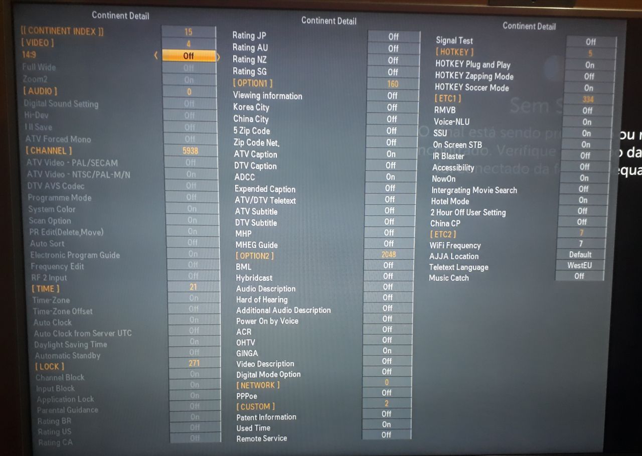

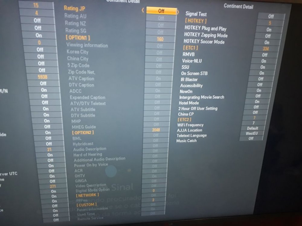

How do I change the values in the ez adjust menu on the "Continent Datail" tab? I think I can not tune in to DTV channels because dtv Caption tab  is "off" and can not change to "on".  Can someone help me?
