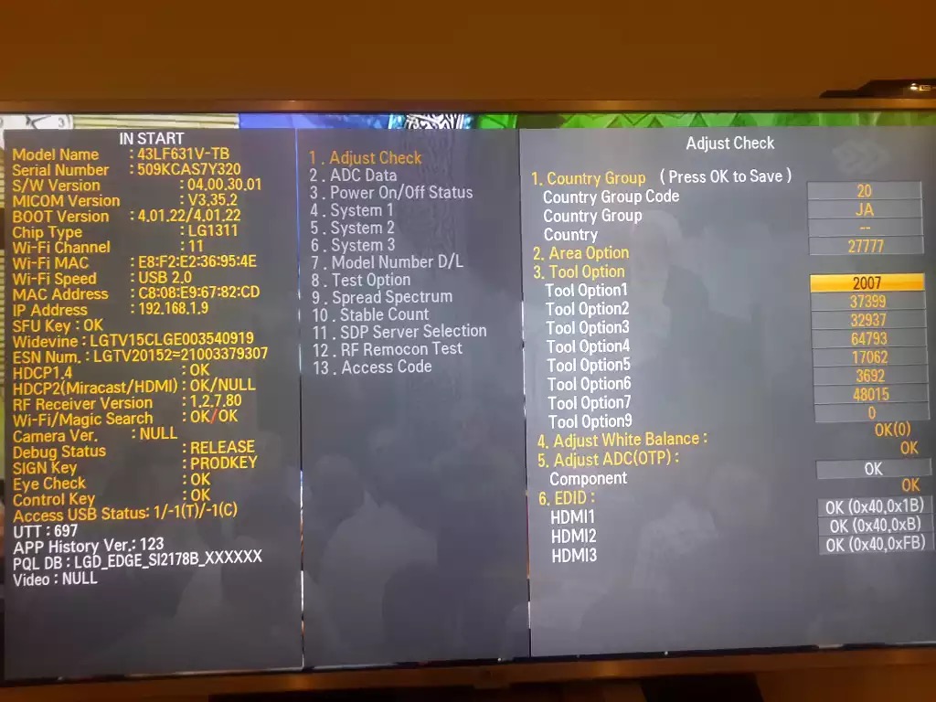

How to activate satellite menu on 43LF 631V
I have a lg webos 43lf631v and i can't find any menu to adjust the satellite reciver so any one could tell me how should i change the area code on the secreet menu to make satellite reciver s menu activated?
