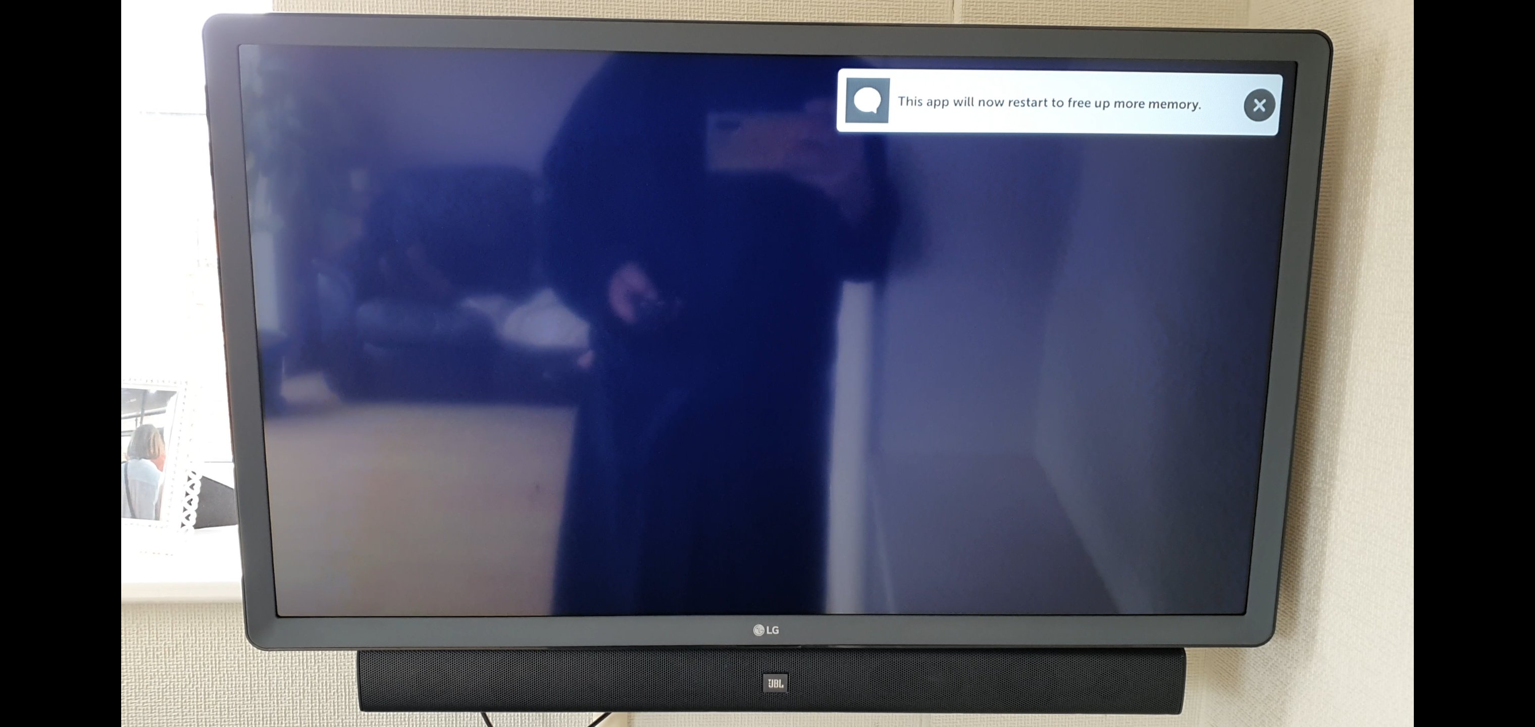

this app will now restart to free up more memory
Bought a new 65" Smart TV, all the preoaded apps You Tube, Netflix etc  are restarting after couple of minutes with "this app will now restart to free up more memory" message.

Hi my lg 32lk61 keeps bringing up the memory error issue and have talked to lg service regarding the issue. asked me to take a screen shot and a copy of the invoice so it can be returned for service/repair
I like other believe there is not enough memory installed in the lg smart tvs ( no issues with my samsung tvs
is there a way to get into the service menu to look how much memory is installed then when my tv comes back I can check to see if there has been a memory upgrade
