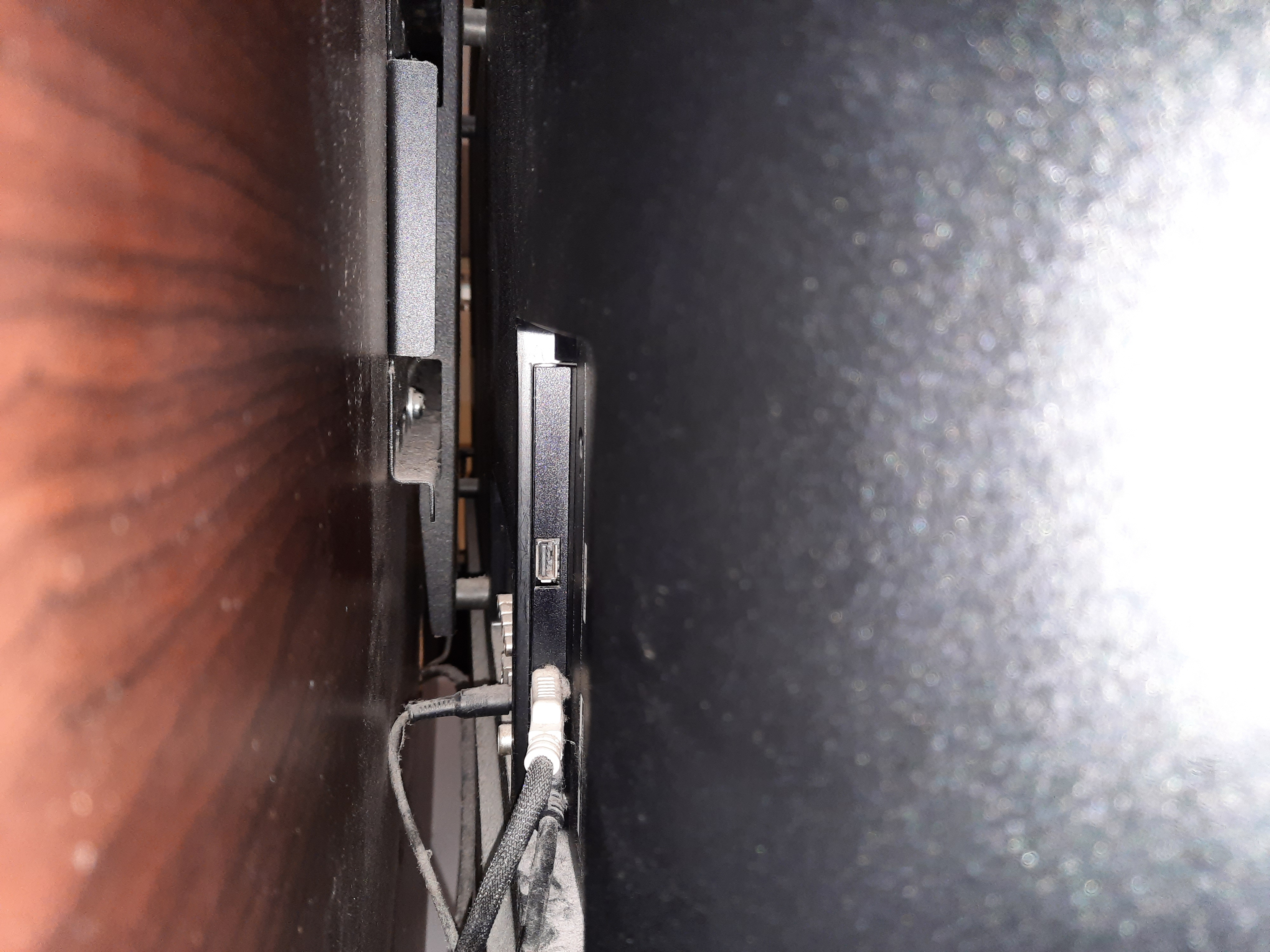

Then I've realize that there was a usb drive (pendrive) inserted in the usb slot at the back of the tv..maybe it has been there for about 1-2 months back (I've remembered the last time I use the usb slot to watch a movie). The "restarting problem" have gone for good this time.
Maybe you guys can try this method..inserting usb drive (any usb drive)16235636794317814032248109380839.thumb.jpg.0cd906b9d2dca448eb8d57a21ecdfeb6.jpg in the usb slot behind the tv. It works well for me. Cheers...

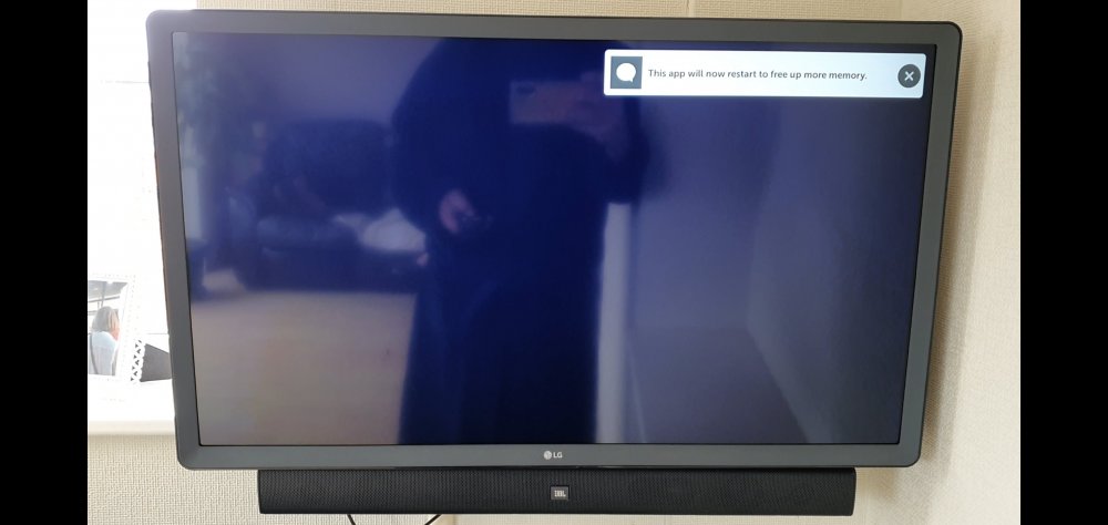

      Just bought a new LG 43UT91006LA TV .
      After one week we're getting a "short of memory " screen warning before TV shuts off and restarts . I've not loaded any apps but I've managed now to delete one . I've checked that the apps are updated . I'm thinking that I can rid myself if the games but not sure how to do this ..I'm a bit baffled that a one week old TV can't cope with it's pre- installed apps ?!
