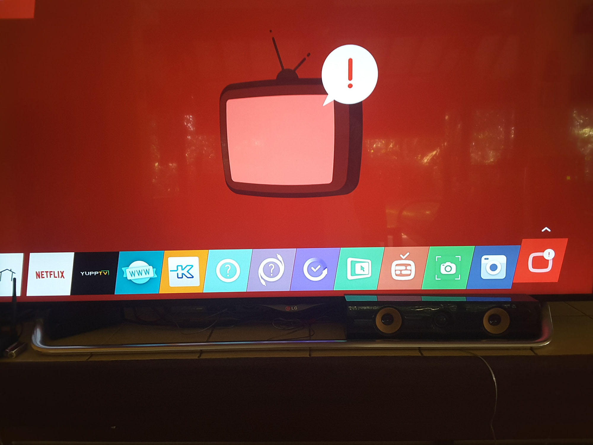

My TV is a 55UB850T purchased Nov 2014.  About a week ago it said YouTube needed to update, so would jump to LG Store where I would select Update, but this would fail, so then I would choose Launch and we could keep going.  After a few days it changed so that as it jumped to LG Store, it showed the flash screen of the store and now sticks there.  We cannot attempt an update and cannot launch.  So I have lost YouTube.
I have done a factory reset, but still the same.

From further playing around I now can say that the LG Store is unable to update any existing app and also cannot install any new app.  The progress bar shows 5% or so, then stops and says Temporary error.  So it seems like a network error but when I go to Settings > Network > Wired Connection - it reports the Connection as OK.  I have tried changing to manual network settings and then choosing Google DNS - but no difference.  Then I have disconnected the wired connection and established WiFi but still LG Store behaves the same.
Are there other ways to check that the network connection for the TV is OK?  I am beginning to wonder if there actually could be a hardware problem.
