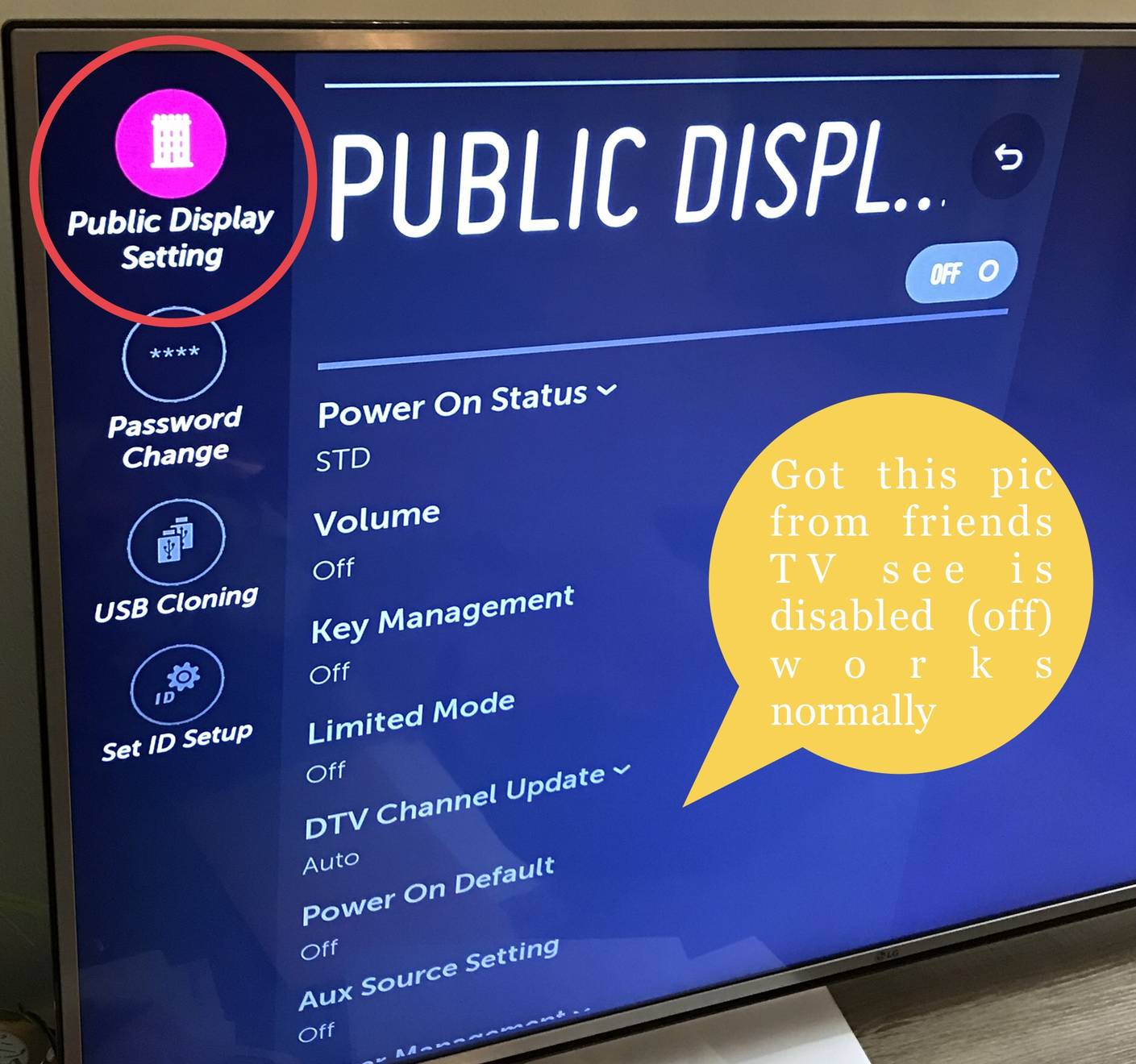

My original remote control doesn’t work and only able to turn it on/off also initial setting greyed out account management gereyed out non of remote app on phone can be pair :(:(
I’m really disappointed
can you help me and get it touch,,,and the picture below shows my tv’s publis display setting is enable( ON )
Also this issue happen after I paired an app called smartify LG remote > in third tab> there is function called installation setting and brings public display setting on webOS tv model 55EG9200 once I enabled that everything is completely ruined , I attach the picture of that secret menu only appears by smartify remote app

      We are able to EDIT some of the functions that are in the initial SETTINGS screen.  However other functions that are layers deep into the settings are unable to be dragged/dropped into that EDIT function. Like ASPECT RATIO. To get to that feature requires a long list of clicking things. It is a function that we use a LOT in order to prevent screen burn-in on these OLED screens. (to be able to watch a channel for extended period of time that happens to have that stupid LOGO or "crawl" along the bottom. Like CNN or MSNBC).
