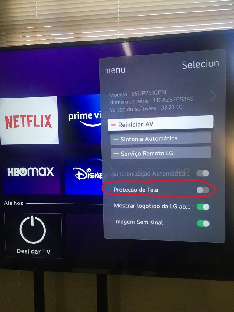

On 11/30/2021 at 6:04 PM, JasonT said:
Press the mute button 5 times in a row with your magic remote
Disable screen saver
It's a hidden menu..... yup...
Thank you, work just fine.
Really appreciate.👏👏👏👍

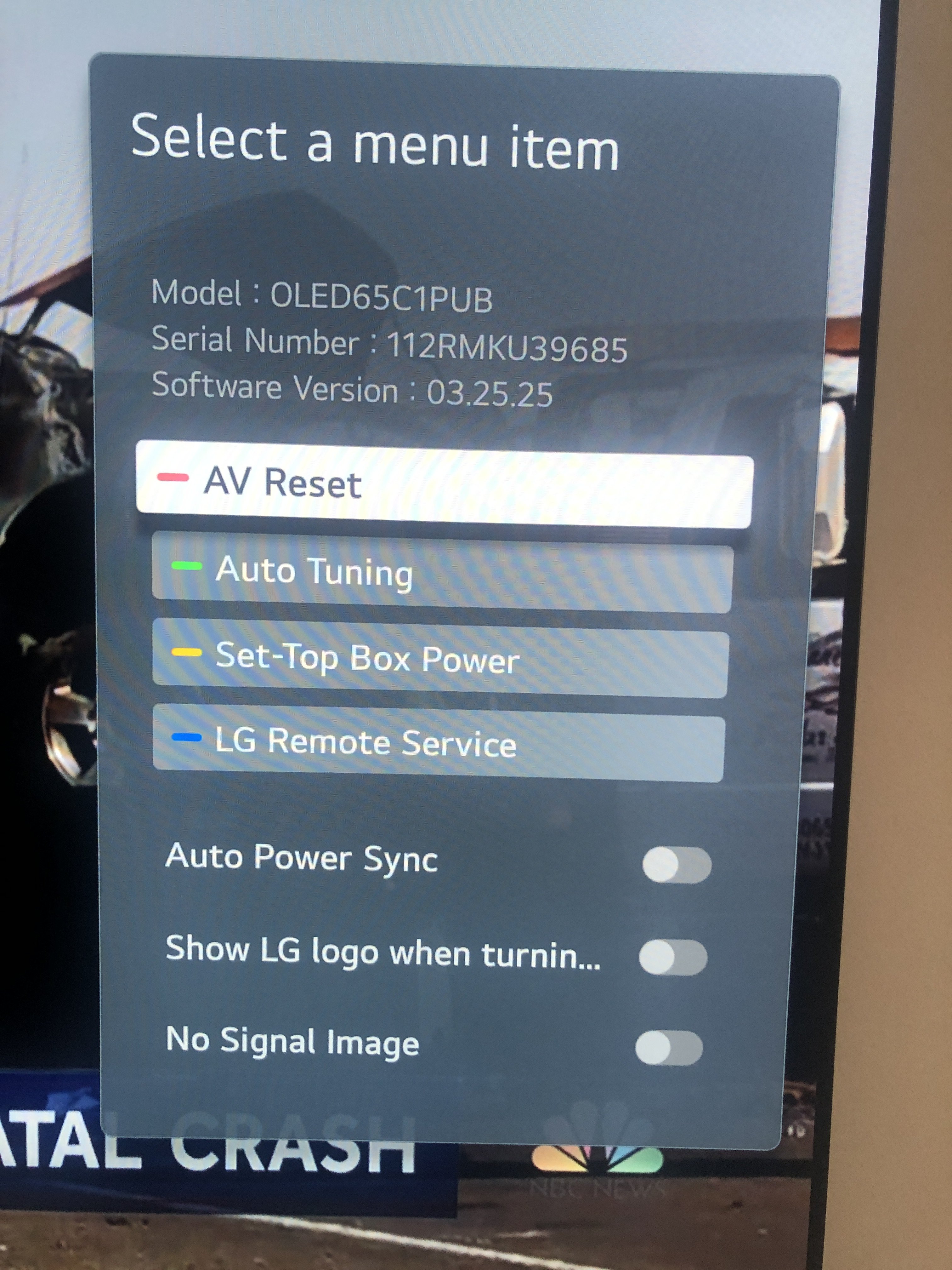

There is so much wrong with your comment.  First off that mute 5 times menu is for Turning off the “No Signal Image” message when you are connected to an input with no signal.  It has absolutely nothing to do with the screensaver mentioned in the original post which pops on while viewing content within apps.  In fact when you have opened an application that “press mute button five times” feature doesn’t even bring up the menu shown in an earlier post.  It simply toggles the sound on and off fives times.
If you want to duplicate the problem mentioned in original post install the application “SmartScreensaver” by WebOSCoder.   Open it and just view the images.   In a couple of minutes the LG fireworks/clock&weather screensaver will interrupt the images.
Dude, I think you have some personal issues to resolve.
I'm saying it worked on my tv.
You are doubting my word without even knowing me.
I say to this community that here on my TV in Brazil, this procedure solved the problem.
Use a translator and see that I disabled the screen saver, then I tested the browser and now it's ok.
Boa sorte e adeus.
Boa sorte e adeus.
I want to apologize for my apparent frustration.  You are clearly trying to help.   My frustration is with LG.  Apparently LG is not consistent with their firmware across models.  This one doesn’t have that option and on latest software update.   And based on the date of the first post for this issue it has been a problem for some time.   But at least it looks like they have fixed it in some models or some regions.  So there is hope they will expand that fix.
  • 2 weeks later...
Can you tell me what model of LG tv you have that gives you the option to turn off your screensaver?
1 hour ago, raehl311 said:
Same problem.  Pressing mute on the remote 5 times... mutes and unmutes the TV 5 times.  No other apparent way to disable this "feature".
I don't know what I did differently, but the press mute 5 times button DID get me a mini service menu where I could turn off the screen saver.  If it doesn't work for you, try with the home menu up on the screen, or right after the TV turns on.
When I do that I only get an option to turn off the No Signal Image but not the screensaver.
Definitely seems model dependent.   Mine is a newly purchased 32LQ630BPUA from Best Buy.
May try checking you have the latest software/firmware version.
I did that first thing.  It’s because I have an OLED TV instead of LCD or LED.
