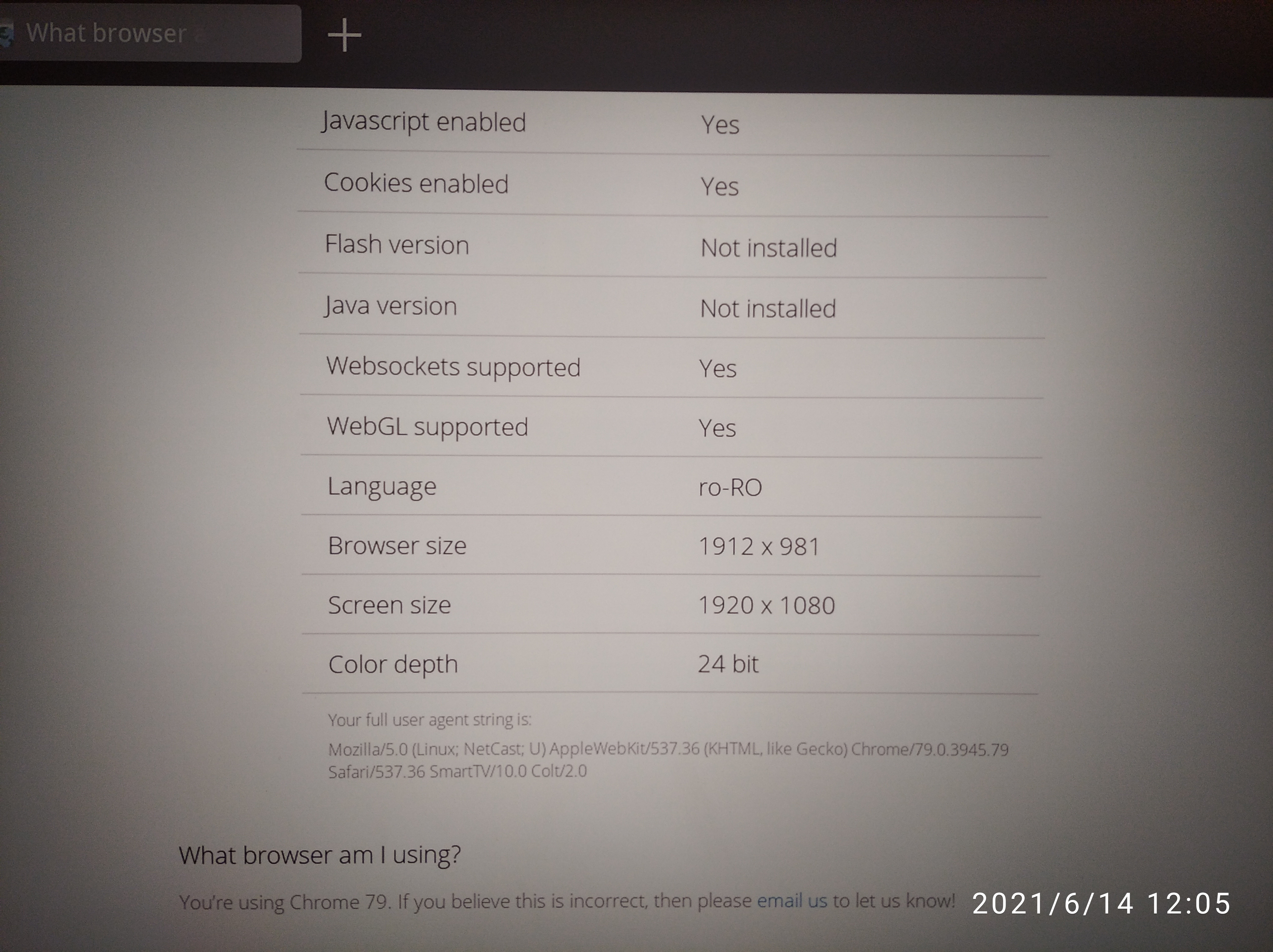

14 hours ago, vladtheodor said:
Swap partition?
Ramdisk ?
Overlay File System?
Virtual RAM on a memory-stick or SD-card?

Well, my LG UM7100PLB updated today to v 05.10.05 webos 4.9.2.-5390405 Goldilocks2-Gyeryongsan.
I updated the browser with the home-button in application. Was 102MB big.
And we have a new browser! It is a Chrome on Java but good!!! Now we can watch online recorded full-lenght movies without interruption.
Seems to have H264ify allready enabled... "Adaptive Javascript" in the browser settings is fine now. No lag.
For blocking ads i disabled the wifi ipv6 in the smarttv settings and for ipv4 now using the adguardDNS 94.140.14.14 adress. Or 94.140.15.15
Thanks guys!
