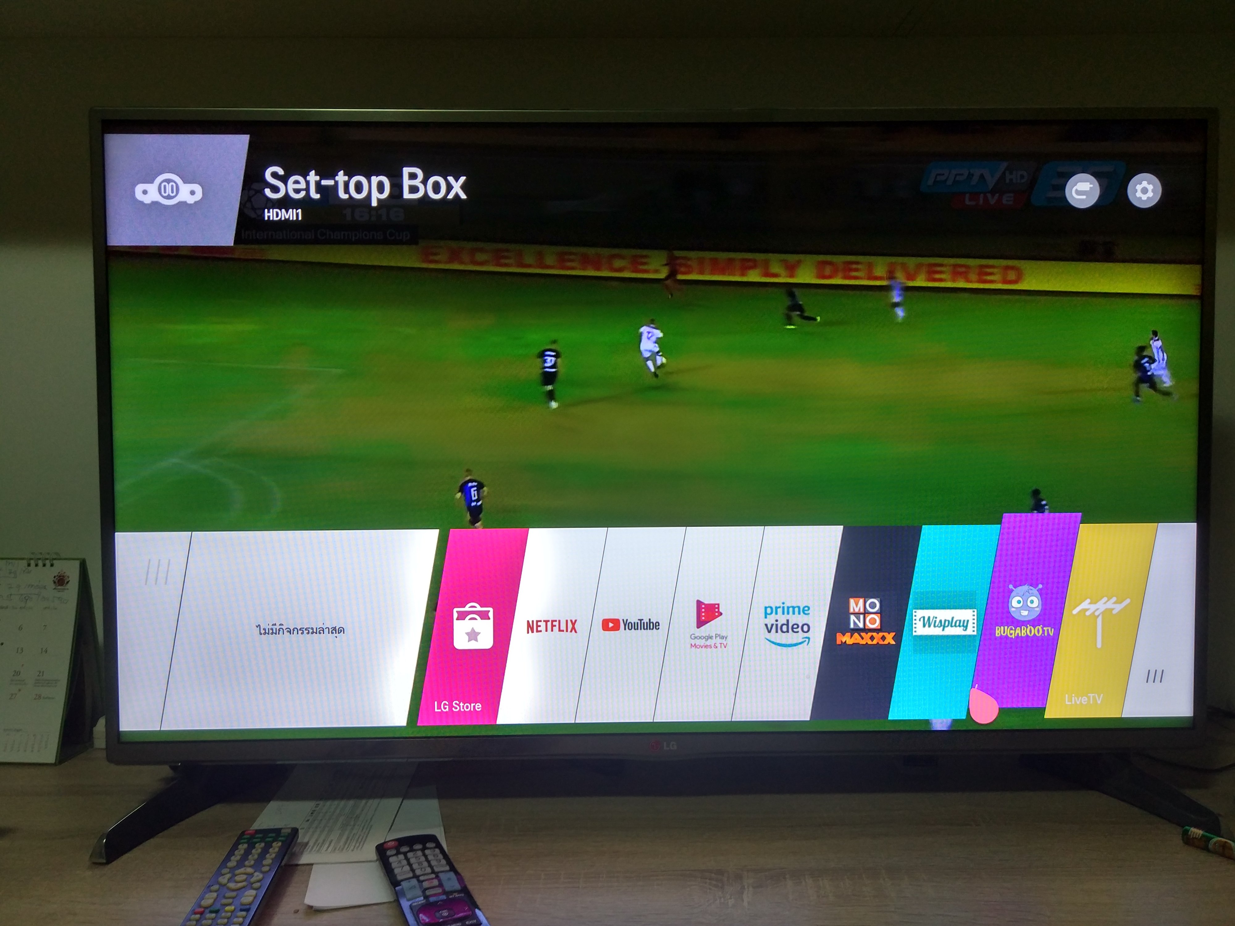

My screen after Factory reset (may required few restart)
I had to re-log in to my Youtube account
, and re-sign in Netflix with e-mail address
,Enjoy :)
