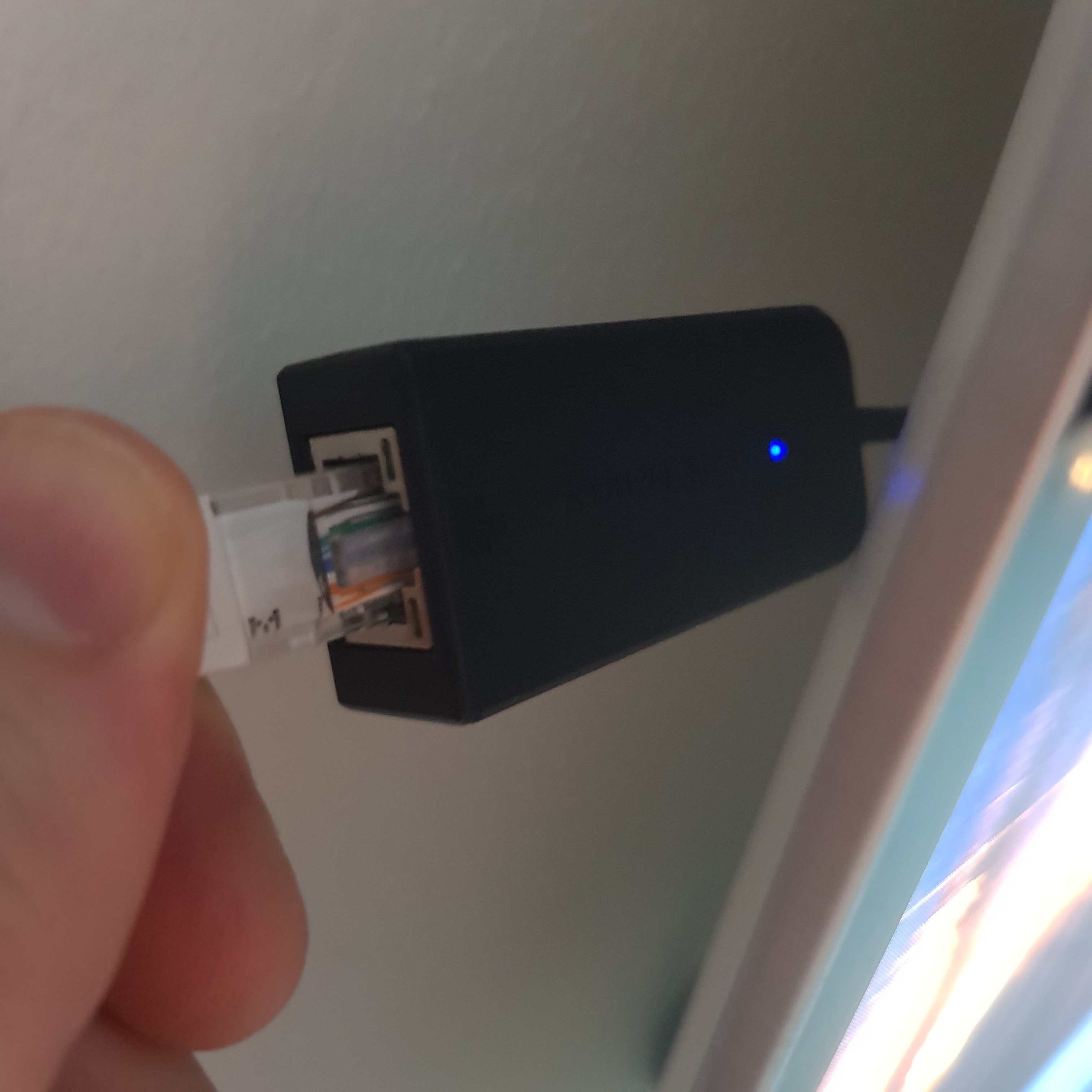

Doesnt work on my 65b7 😞
it lights up but no connection 😞
bought the one linked to from cablematters
Says a  unknown device was connected and it light up, but no internet when wifi and cable is turned for
It is in the 3.0 slot
anything special i should do?
I had to plug in and out several times, waited for it to install (no message). Also try turning tv off and on a few times. If the lights start blinking there is communication...
I only have a light in the small blue led. Are you using the 3.0 slot?
So you have to do that every time ? Or does it just work after that first time ?
Hrm... Worked perfectly for me first time...   You're sure it was this guy:
I have a 65e7, which should be identical to your 65b7 in this regard.
Yep its the 202013-BLK... it seems it might not get enough power or something. I have no lights in it besides the blue led. When i turn on the tv the network leds light up for a split second and then goes to nothing..  tried getting it in and out 100 times.
Plugged into the 3.0 slot
The 127th time worked! And it works every time now!
Super weird!
Better and more stable speeds now 🙂
