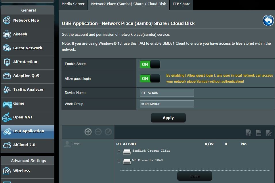

I am able to access USB mounted on ASUS RT-AC68U from TV  LG OLED 48CX without any problem. The router have to ENABLE "guest login" that requires no password. Should not be a problem with security issues if you have a router with firewall.
If I try remove guest loging., it does not work. The network drive will automatically appear on the LG TV on network picture, and can be accessed without any configuration at all.
regards Ingemar

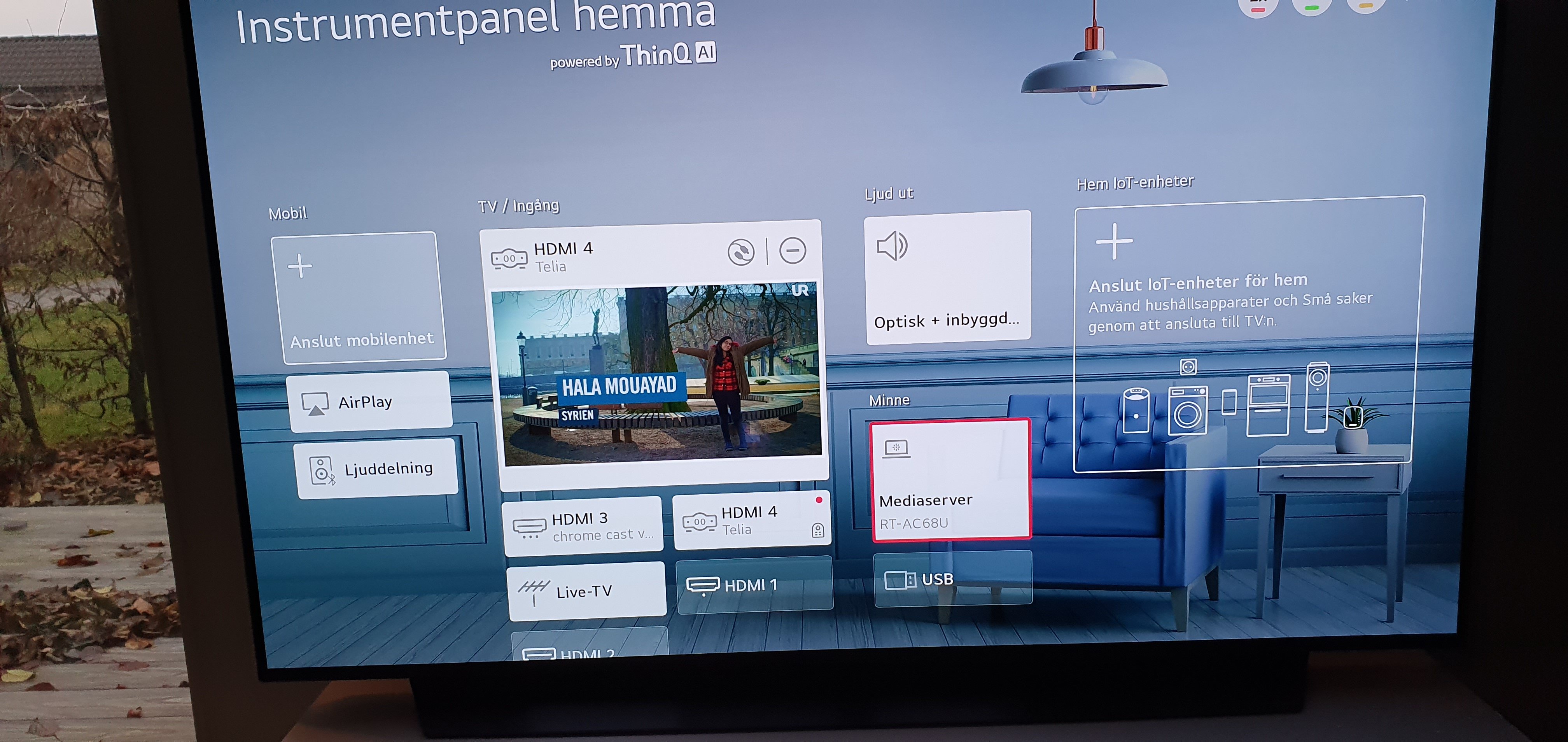

OK, yes it's called Input or Instrumentpanel (Swedish), or if you open the  "Music App" you will also see the Media Server available.

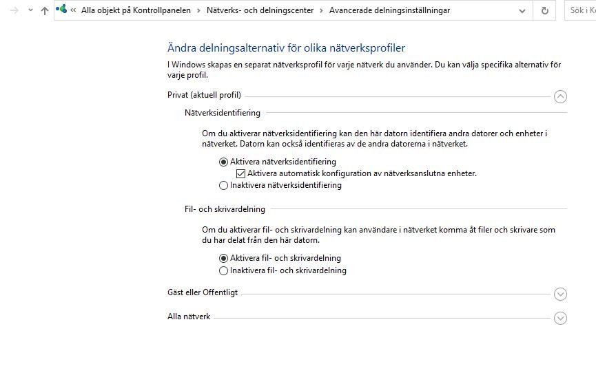

If you Share files from your PC/Windows you have to give access via Control panel and network and sharing-> advanced sharing alternatives (text in control panel i not exact, Swedish on my PC).

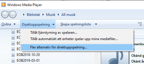

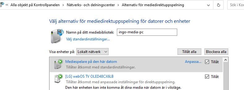

Also change "alternative for media playing" on control panel.
You can also come there from Windows Media Player directly. See picture.

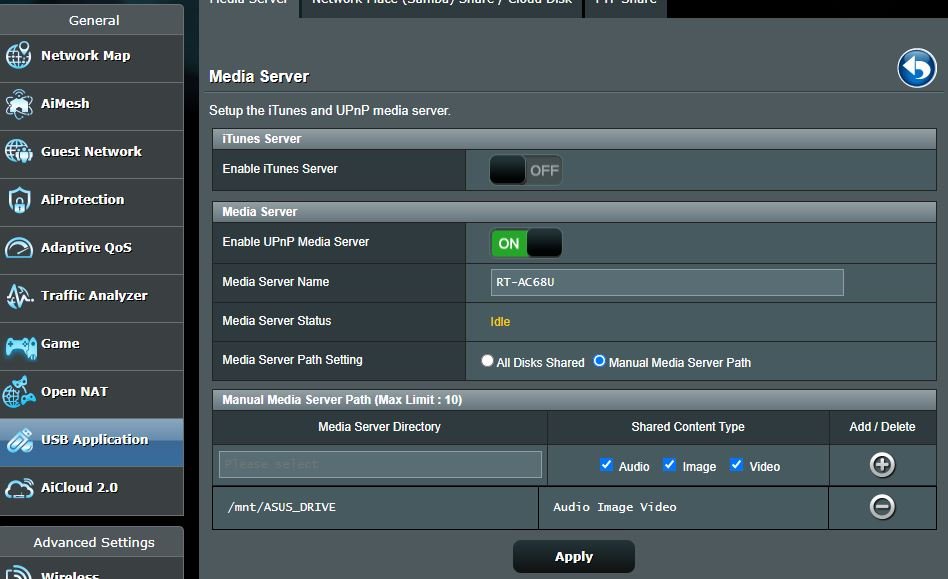

I've looked at my Asus RT-AC87U and I can see that as well as your shares you probably have the setting USB Application -> Servers Centre -> Media Server ->Enable UPnP Media Server turned on, which does let the LG TV see the share via the UPnP . Unfortunately we wouldn't be able to see this on our TV if it were just a normal network share(samba).

Hi Yes I have the PPnP server ACTIVE on my ASUS RT-68U as well. I have two USB connected to the Router, but only allow acces to one. See bottom of picture.

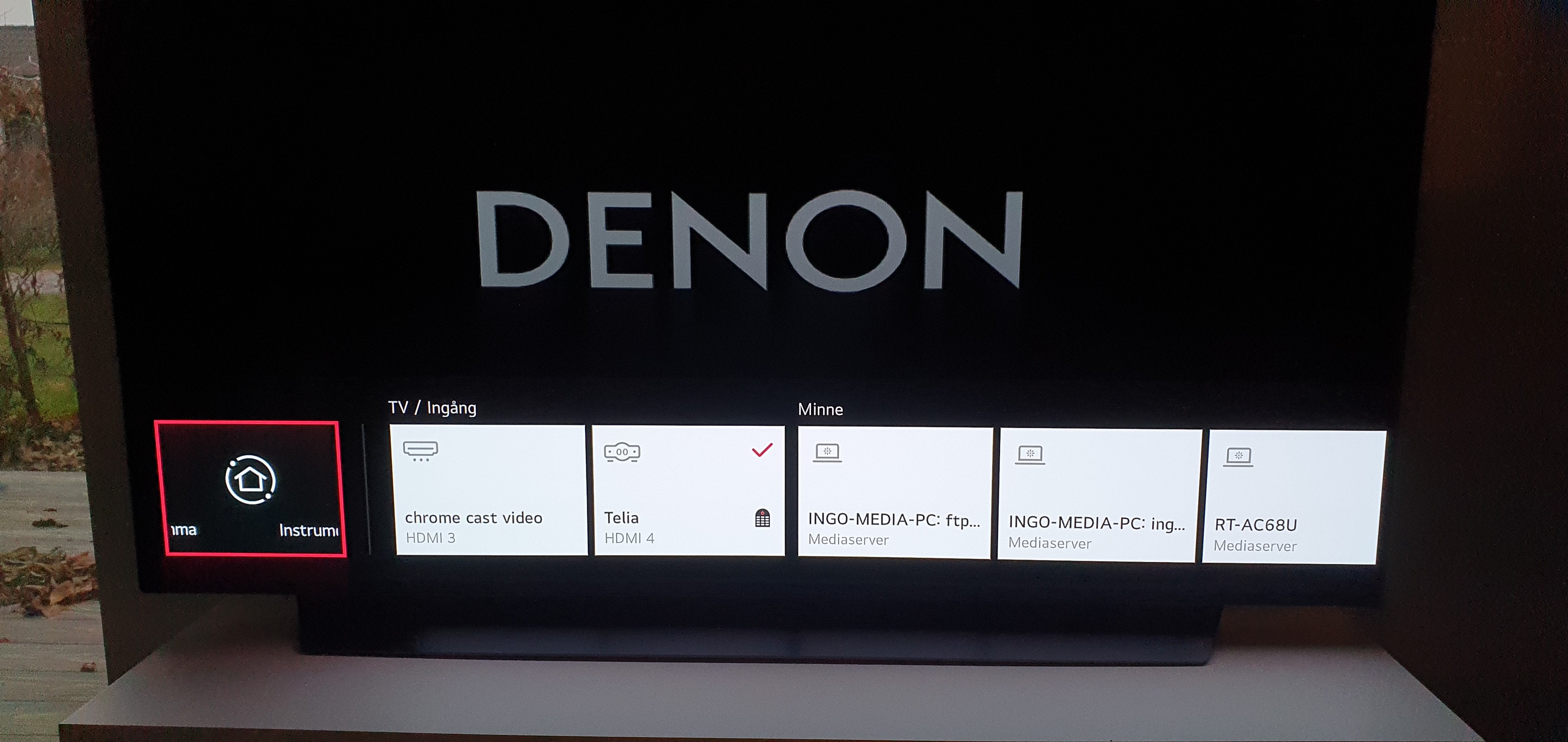

And finally.. If I press the "input" buttom on the remote I get this picture with all shared devices. Here I have on shared from the ASUS router and one shared from my Windows 10 PC. They appear automatically here without any configuration at all. My TV is from 2020 November.
