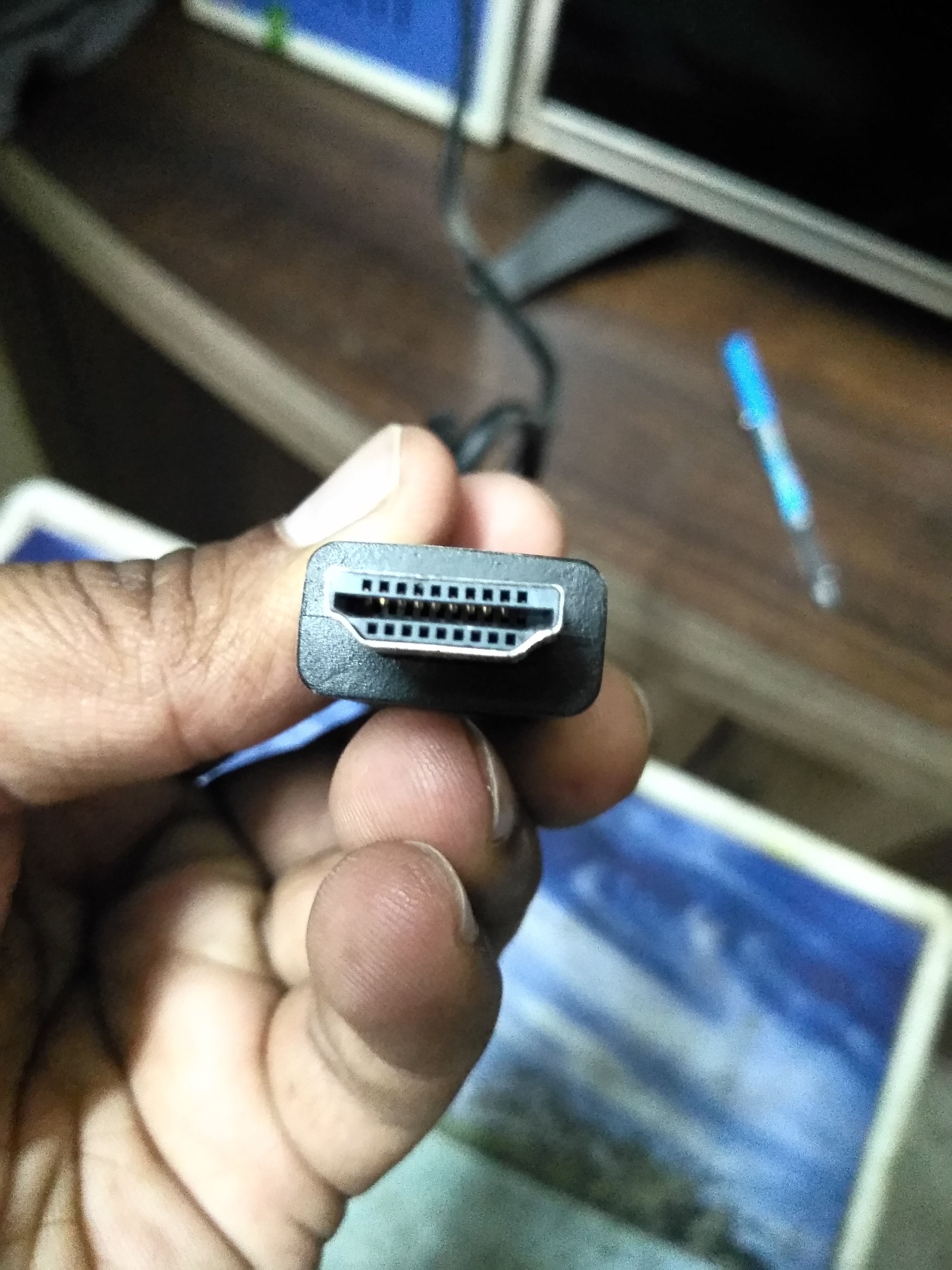

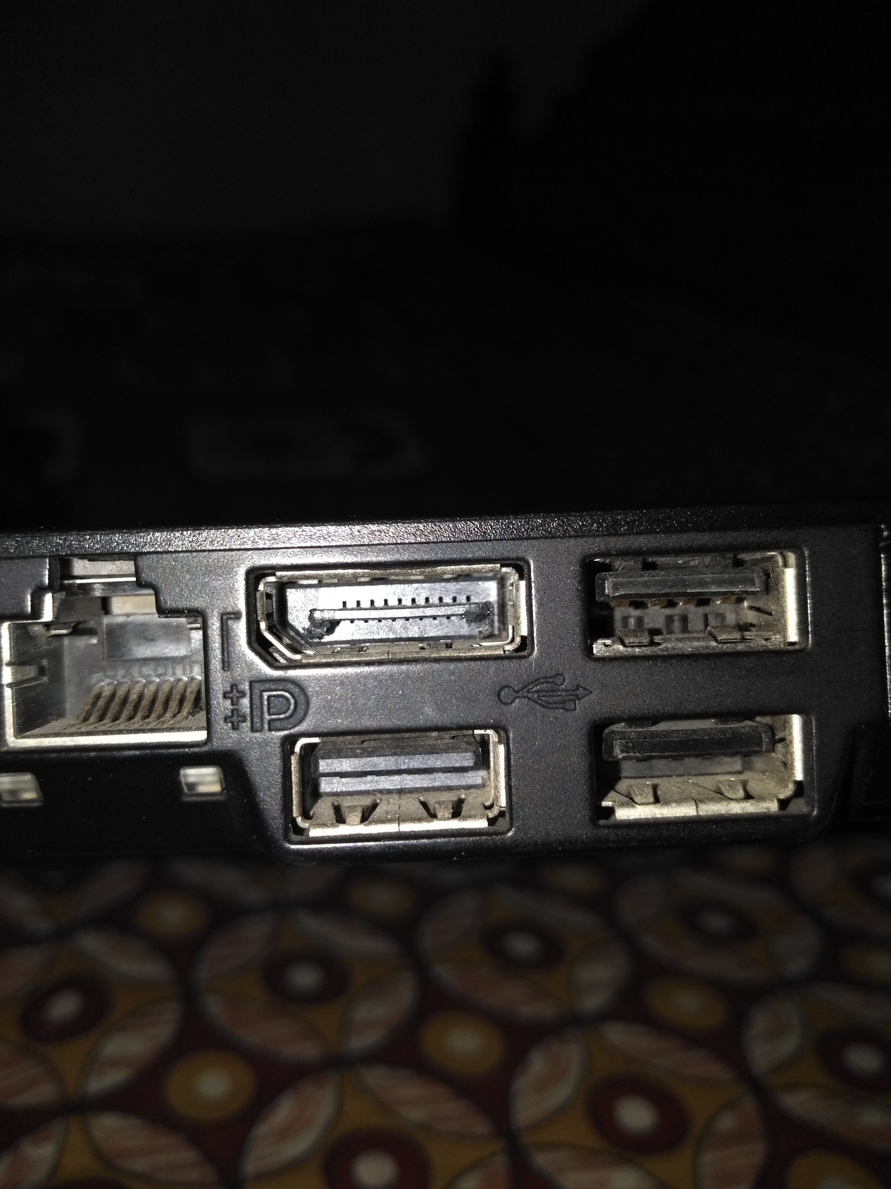

I wanted to connect my Lennovo Thinkpad to my LG web Is tv, can someone guide me to connect
I wanted to connect my Lennovo Thinkpad to my LG web Is tv, can someone guide me to connect, the HDMI port my laptop seems to be different pls check attached images first one is my laptop port and second one is TV HDMI cable
4 answers to this question
Not an expert but...
I believe the port on the laptop is a Display Port which was intended to replace VGA and/or DVI connectors.
If there are no other compatible ports on the computer or TV then may need some kind of converter of some type. Check consumer electronics place or Amazon.
