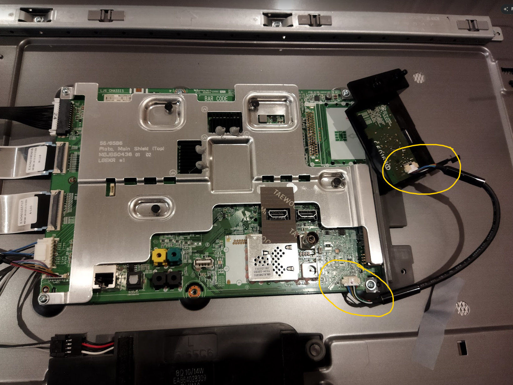

Hey all. Having the same problem with my OLED65B6T.
So far I've tried:
- Different router, ethernet cables & factory resetting it. When I connect via WIFI I get the same problem.
- Disable QuickStart+, hard shutdown (turn it off, unplug from the wall, manually press and hold the power on button at the bottom of the screen for 15 seconds)
- Opened up the back cover, but couldn't see any ribbon wires that need uncrimping - see photos attached. The cable I circled I removed & cleaned with electronic cleaner.
Things that I might try later:
- Replace RF module board - they go for about $50 on aliexpress
- Get an ethernet to usb adapter - anyone know which one works on the B6?
- Replace the main board - prefer not to lol
This is so frustrating as I upgraded from my 10 year old 40" LG TV that had zero issues. I'm hoping I can fix it, otherwise I'm going to avoid LG products in future.
So far I've tried:
Have you given those two ribbon cables on the left a clean? I dont think having a ribbon cable with a bend is the issue, their ribbon cables just seem to be prone to oxidizing badly. Wouldn't hurt to at least try unplugging and replugging anything you can see a few times?
I gave them a look over & they honestly looked spotless. I didn't disconnect them, but I haven't seen the message pop up for about 2 days now. Touch wood it's all good.
One thing I did do was upgrade my router firmware to Asuswrt-Merlin - that might be contributed to the fix as well.
