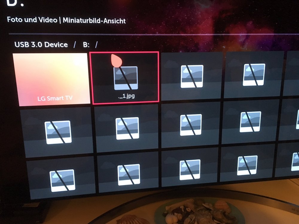

To have a picture  show on my new LG OLED55B87LC I've connected an external USB 3.0 hard disk (formatted with MS-DOS FAT32 on my iMac) that I've filled with hundreds of pictures from my Fotos App.
But when I open this drive on the TV the jpg pictures (numbered 1.jpg to 999.jpg) show up as ._1.jpg to ._999.jpg. When I scroll down at the end the list then the real jpg`s appear. So it looks like there's a copy of each file on this drive starting with  ._  ?? And all of them can't be shown on the TV - they look faulty ?
I've tried out with another drive / USB stick - just the same problem. Does anyone experience the same problems ? Do USB devices have to be formatted in a special way ? Any idea how to solve this ?

those are probably thumbnails  file metadata created by MacOSX, those are not visible in your computer because files with names beginning with a dot are considered "hidden" in all Unix-derived systems (Linux, MacOSX), due to FAT32 constraints it can't store thumbnails as resource forks (the MacOSX way),
