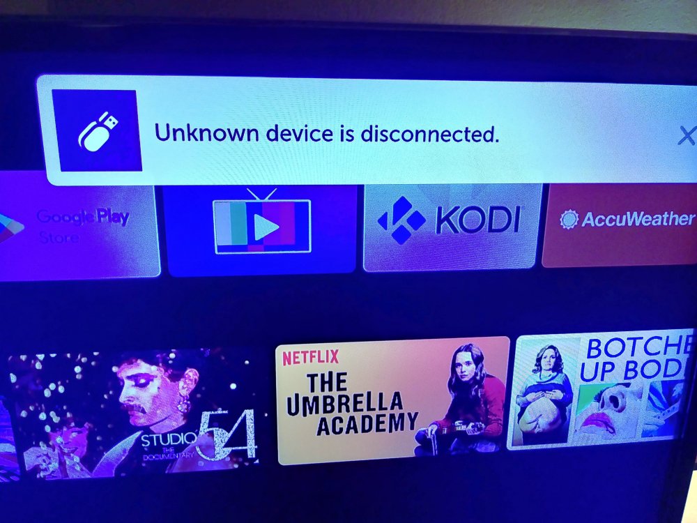

I have owned this tv for a year and pleased with it ... until about a month ago. I now have constant repetitive messages in top right hand corner of screen saying 'Unknown device disconnected' or 'wired network is connected' or wired lan cable is connected' and it's driving me crazy. I have tried the lg live chat technical support and they were not aware of the issue but I've seen the same problem discussed on US forums and here too. Nobody seems to be able to have a solution. I have unplugged all external stuff - Virgin V6 box, Wii, wired internet, etc and it still happens. Help!!

I started to get the "unknown device has disconnected" popup last night all of a sudden.

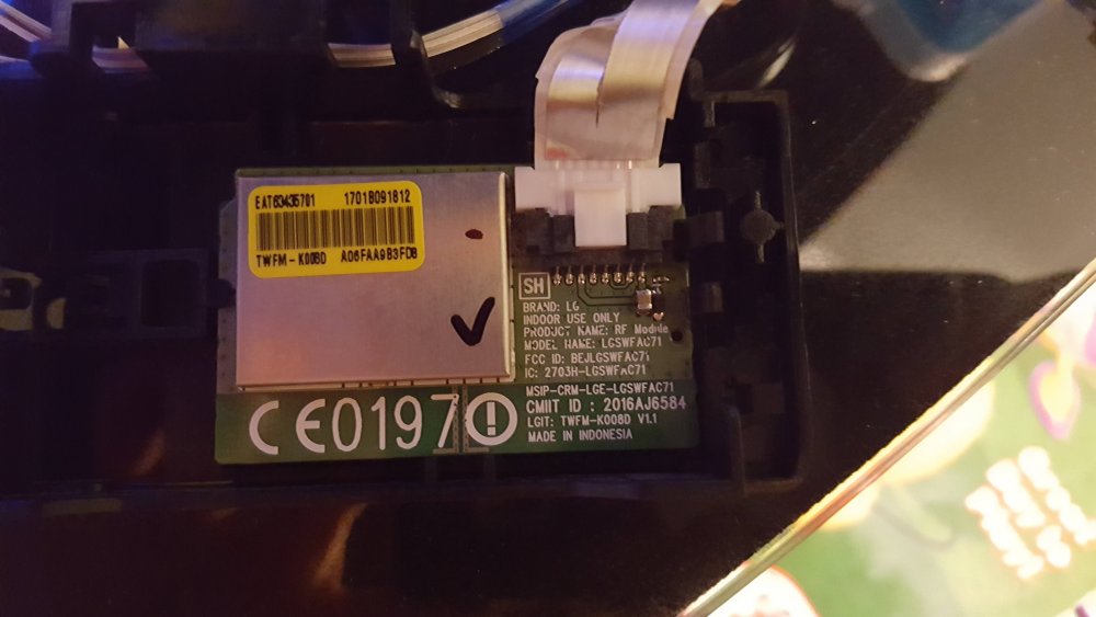

SOLUTION:  Have replaced the  RF Module (EAT63377302 WI FI MODULES & 3D TRANSMITTERS FOR LG GENUINE 49SJ810V).

Since the wifi could not detect any wifi networks, it was obvious to me that the wifi module is faulty. Made some research to find out the correct part number of this module and bought one from the ebay.

1. Remove the back cover.
2. The wifi module is at the bottom center. Its a small box, which could be removed by one screw. The box has the bottom switches as well tje wifi controller.
3. Disconnect the plug from the wifi and remove the board. Teplace tje wifi board with a working one and connect the connector. Fix the box back to the tv
4 fix back cover.
Is quite easy procedure. Should not take more the 30 min.

Thanks for sharing, I opened up the back cover and found the wifi module, it was quite easy as you mentioned, mine was in a plastic cover with the  power button. Now I gotta wait for the part to arrive. I'm in Brazil, wasn't hard finding it online. My tv is a 49uj7500, part lgsbwac72

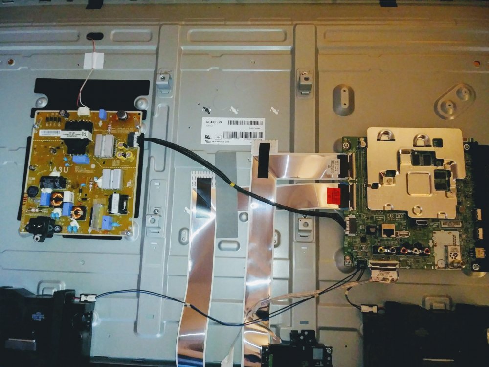

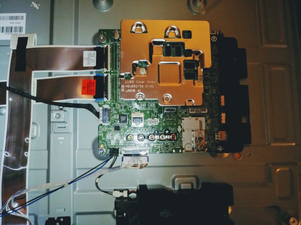

I just replaced the WiFi module yesterday and it solved the problem also. We will not buy another LG tv again as this tv was a replacement for an LG that went bad while under warranty. This tv was fine until the last update. We feel LG should have acknowledged and sent out WiFi module replacements but they keep saying they can’t find a connection between the two. Granted some people have more issues and they offer service call but it costs. I also realize not everyone can change out the module. The hardest thing was taking out all the screws out of the back of the tv.
I can confirm that I experienced a similar issue on my 55UJ6300, and apparently changing the WiFi RF module worked. I was not using WiFi at all, since I had my TV connected by Ethernet cable to the router, but around November 2018 I started seeing the "Unknown device disconnected" pop up messages. Some days it would happen more often than others. Sometimes a "Wired cable connected" or similar message would also show up, and sometimes a bigger black notice would show up saying "Network connection lost" or something similar. Sometimes the Ethernet connection would actually stop working after this. I also started seeing the 2-3 second pause followed by fast motion to catch up every once in a while. This would happen for example when watching YouTube or Netflix on the TV apps. Netflix would sometimes require me to get out of a movie and back to it for it to resume playing.  Turning on Store Mode would hide the pop up messages, but I am sure they were still there only hidden, since the othe symptoms would persist.
As someone in this thread suggessted, I opened the back of the TV, looked at the RF module, and found a similar one on eBay for less than 10 dollars (here in the US). The module was the same though the revision was a bit higher (1.1 in mine and 1.4 in the one I found). I chose it since I figured maybe a newer RF module would work for a longer time, or had the issue fixed so that it will not happen again in the future after a while. I was able to successfully switch my module with this one, and even though I have not tried WiFi directly, everything I needed seems to be working, and all the issues have disappeared for now. It has only been around 3 days, but I am hopeful that the issue will not come back.
