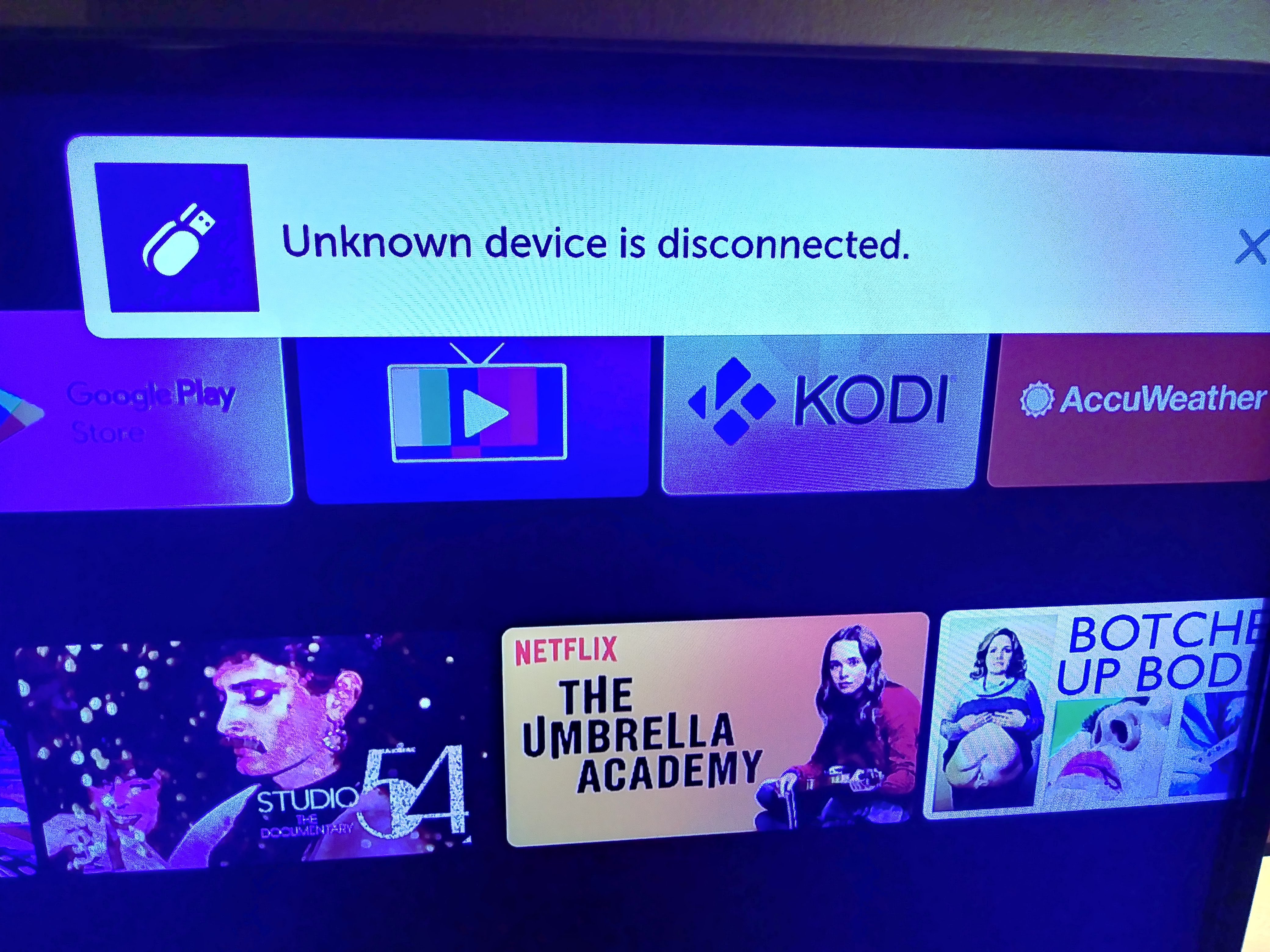

I have owned this tv for a year and pleased with it ... until about a month ago. I now have constant repetitive messages in top right hand corner of screen saying 'Unknown device disconnected' or 'wired network is connected' or wired lan cable is connected' and it's driving me crazy. I have tried the lg live chat technical support and they were not aware of the issue but I've seen the same problem discussed on US forums and here too. Nobody seems to be able to have a solution. I have unplugged all external stuff - Virgin V6 box, Wii, wired internet, etc and it still happens. Help!!

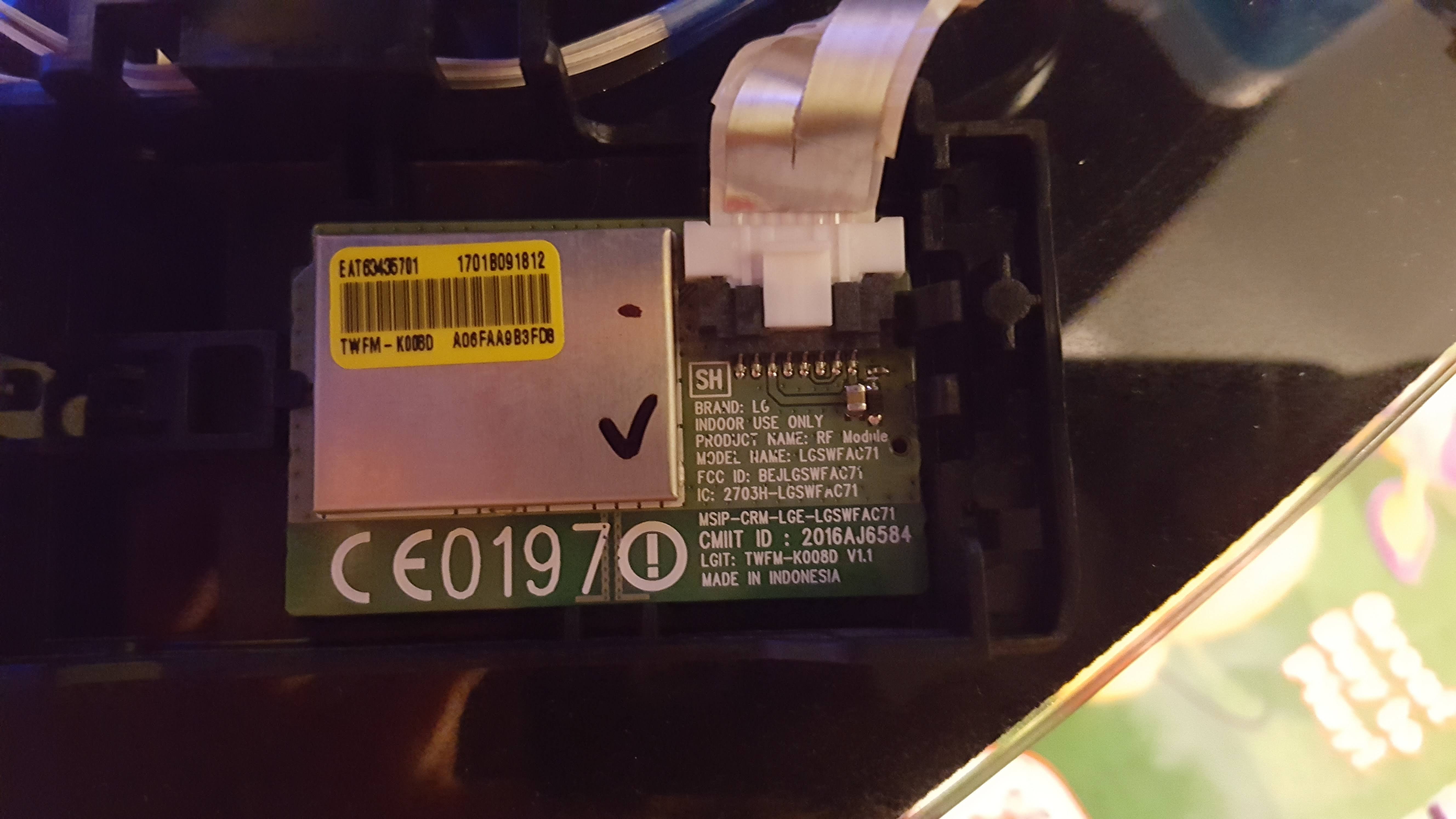

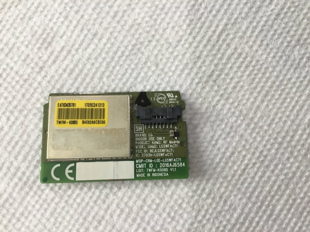

Please find attached the pictures of the faulty rf module. Since is a common fault on many tvs, please make arrangemnts for a replacement. I may send you my address if requested.

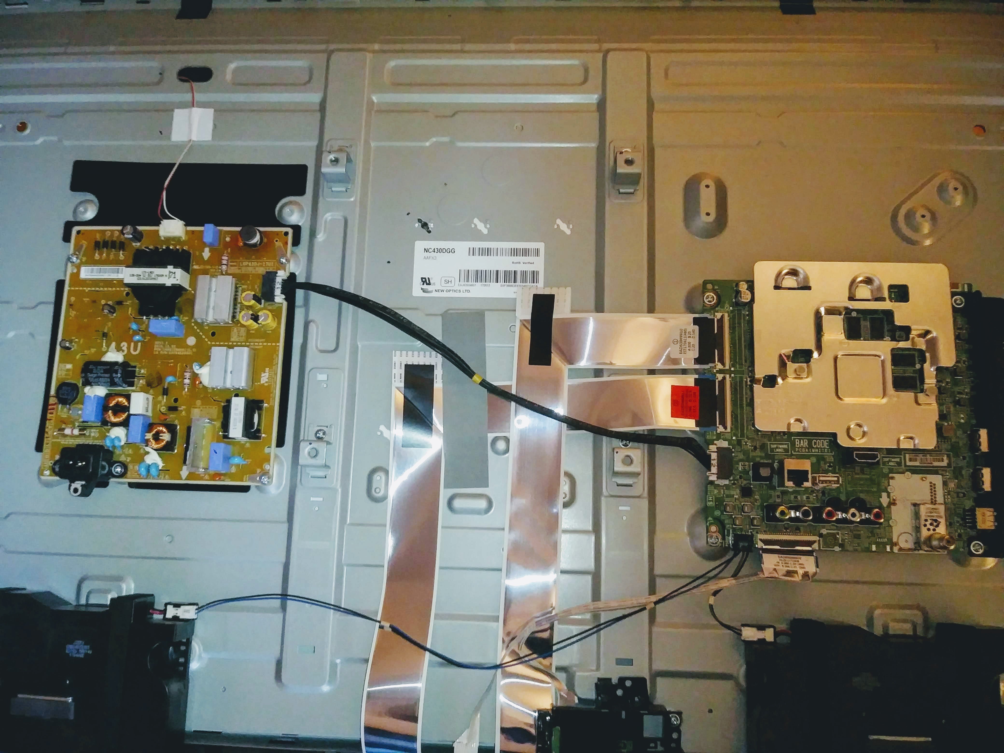

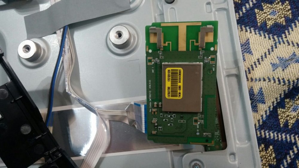

anyway, per the experiences reported in this forum, I tried to see what the module is. At the first glance, and more and more scope, no obvious fault was detected. everything seemed to be OK. So I just disassembled the module and the ribbon cable. I experienced that the TV had little or no sense to magic control. So, the module was not a thing that could be ignored. So I took some photos and reassembled them again after the only common remaining task, i.e. cleaning the module and connecting cable both at the module's and mainboard's header by a spray solvent.
And now, it is for 3 days that the TV has operated flawlessly. Everything is OK; Magic control, WiFi, Screenshare, No message, No pause or delay in the stream display ... I wonder what the bug was and wonder whether it would be coming back? Who knows? It was recommended to me to substitute the TV to another model or brand. It is not my decision for now.
So, It may be helpful if the users, who have replaced the module, say in please that if any similar tasks had been already done before replacing?

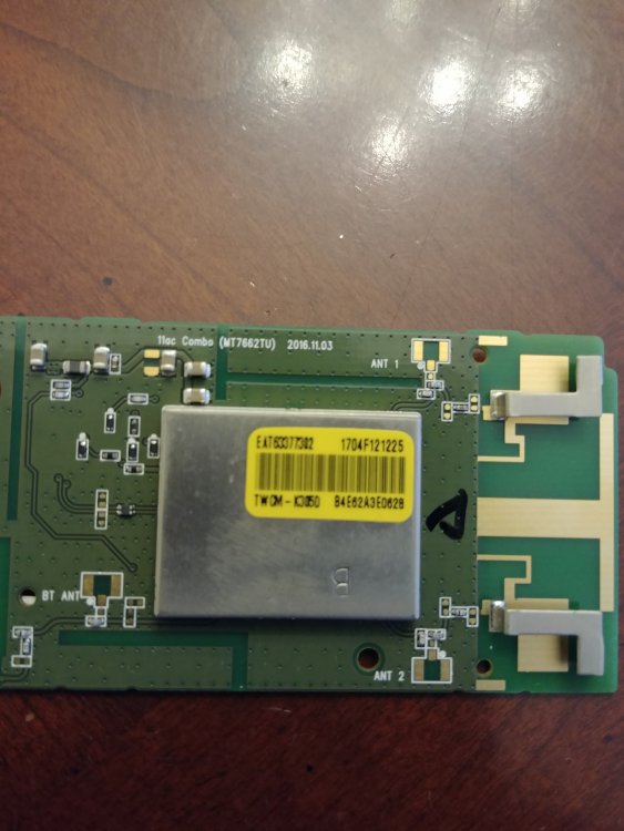

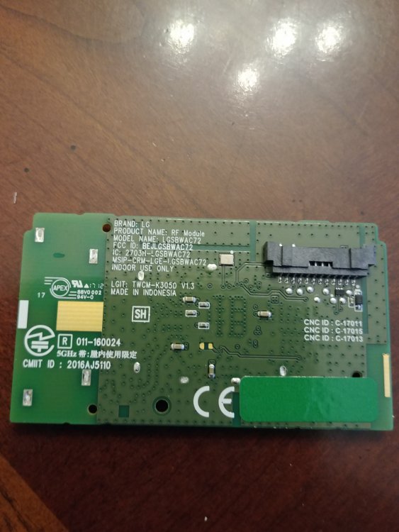

Here is a picture of my old module, in case it helps.

Thank you. My problem has also been solved. I disassembled the RF module and the ribbon cable and reassembled them again

My 49SJ800V has the LGSBWAC72 RF Module and after disassembly and blowing some cold air from my hair dryer on the connectors fixed my problems.
Now my magic remote stays connected and Netflix hasn't had a hiccup ever since.
Take note that I still get the "unknown device disconnected"/"unknown device reconnected" combo.
Same here, issue started with os update on my UK6090PUA. I contacted customer service who asked me to change the location of the TV from US to Canada and back, and if that does not work (it didn't), do a hard reset by unplugging and pressing the start button for one minute. That did not help either. These random notifications are very distracting, up to 10 per minute, then nothing for a while, and back again.
