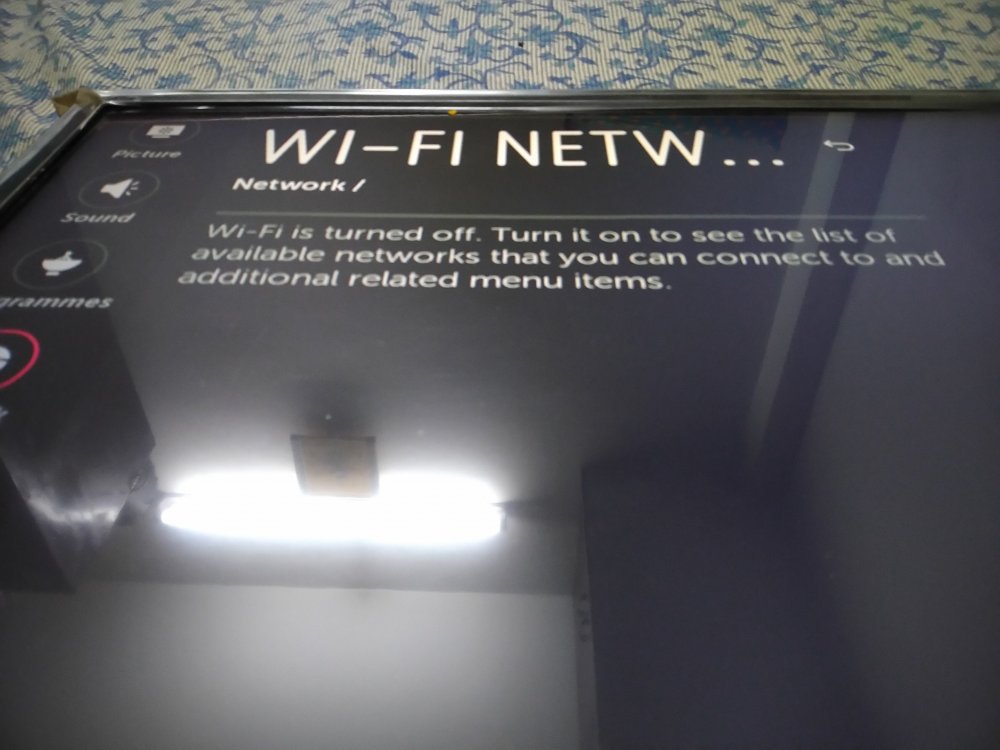

The Wifi module was not working and an lg reprezentative  had to replace that wifi and bluetooth module. Now is working as it should.

As  I was saying, simply resetting and power cycling does not work. Resetting the magic control also does not work.
I ordered 3 necro-cannibalized modules from China, and none works either. Since there is a chance that one of them was good still exists, I am beginning to suspect some self-destruct feature. Because USB also still works and what could happen destroying only one USB port(wifi), and not harming all others, connected to the same controller.
Are there any other ideas? I get the same message listed in the above picture.
Power cycling, manually setting date and time, switching to Canada and back to USA, none have solved the issue.
