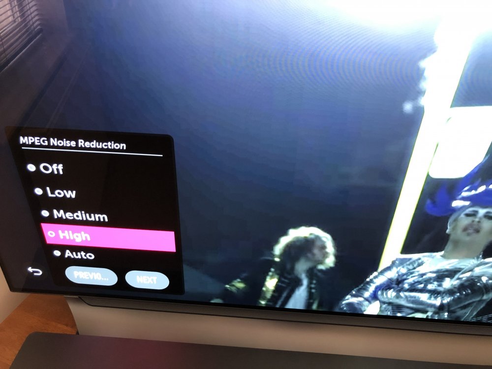

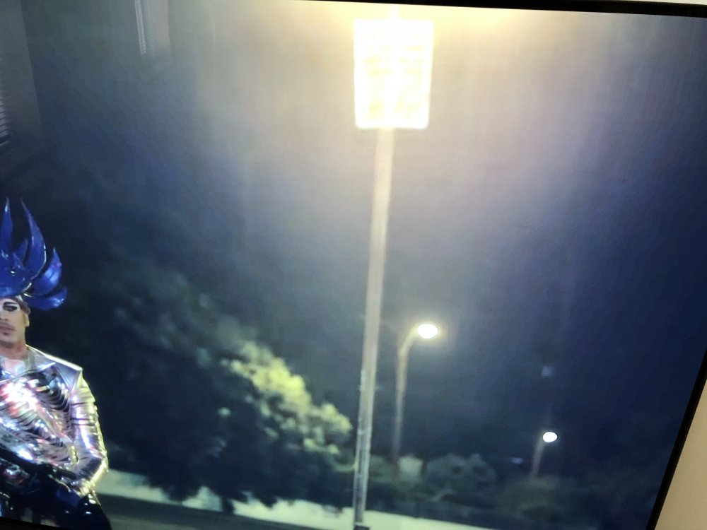

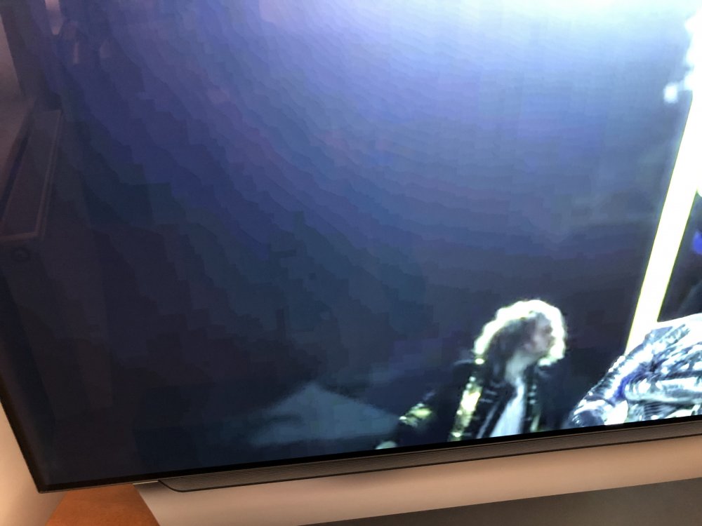

Since update 04.10.31 was applied to my OLED55C8PLA TV, the Quad Step Noise Reduction “circuit” has completely stopped working. The “circuit” was previously activated by using the MPEG Noise Reduction menu. I always had it set to “Auto” and, by doing so, the awful colour banding effect was almost completely eliminated. From the attached pictures you will see that the picture now has awful colour banding regardless of which MPEG Noise Reduction setting is used.

I have sent various pictures (as attached to this question) of the colour banding now being produced now that Quad Step Noise Reduction (“decontouring”) is not working. I would stress that previously with MPEG Noise Reduction setting on High or Auto, the banding effect was eradicated.
