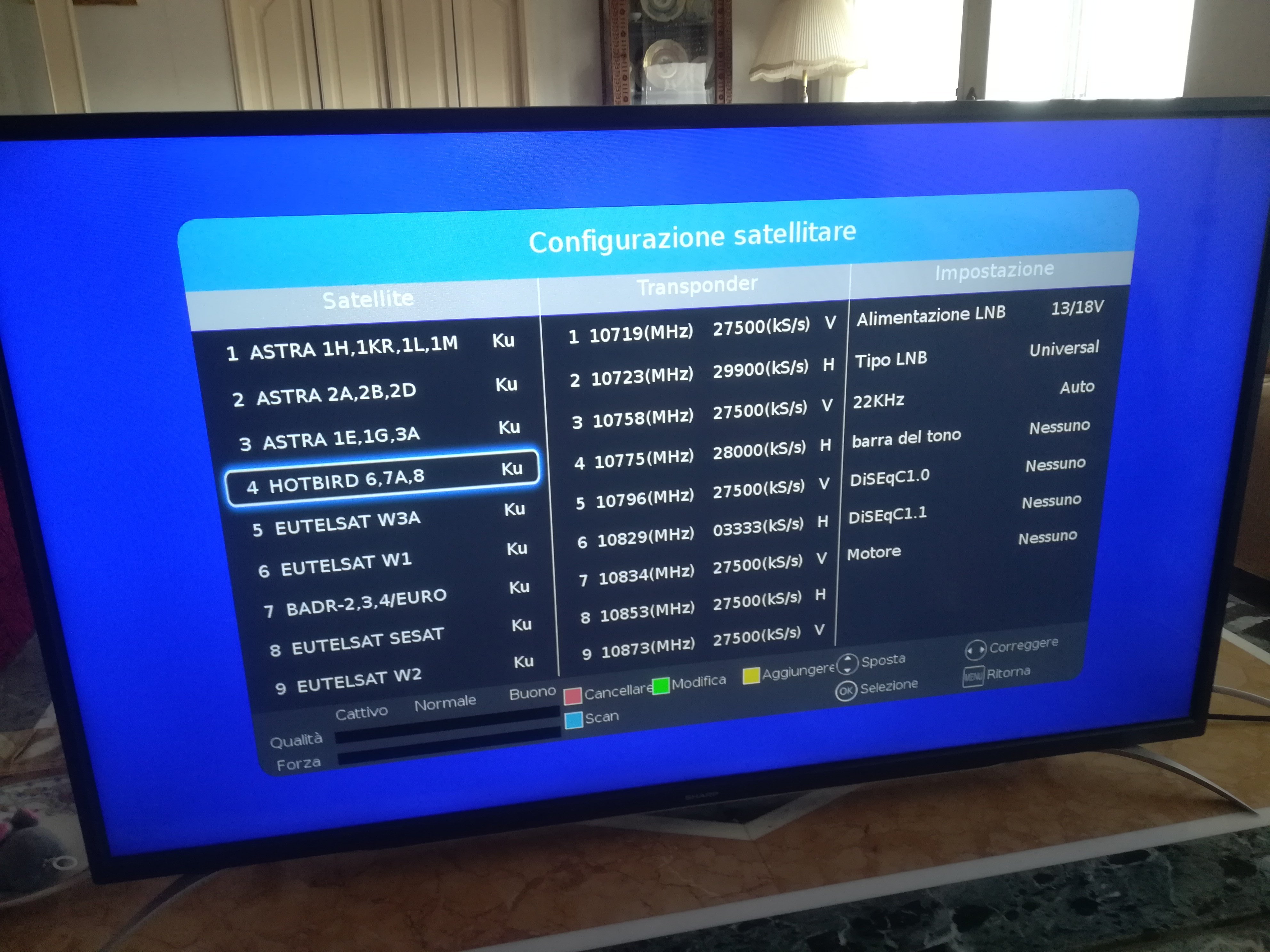

Hello, i'm new on this forum and I buyed an LG 55C8 Tv. I'm italian and I have problems to set the DVB-S signal.
The tv report a series of satellite and has setted as free satellite only TVSat that is the free provider of my zone including rai and mediaset.
I have not a tvsat smartcam and my system is setted on free wifi on hotbird 6, 7a or 8.
TVSat is on Hotbird 13, so the signal is not received.
I tried to set the satellite custom settings from myself but I have no luck.
I post the picture of my old tv with the correct settings, if anyone want to help me i will be grateful.
Thanks in advance.
1 answer to this question
I solved from myself using the suggestion of another forum.
Hotbird 6/7a/8 is now called hotbird 13, so the presetted setting was good.
My connector was broken, i have redone it and now the preselection works great,
