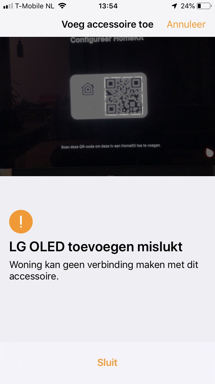

I have a problem as well. I am unable to connect my LG OLED 55C9 to Homekit. Every time I scan the QR code generated by my TV with the Homekit app I get a message in the Homekit app that adding LG OLED to Homekit has failed. Airplay works fine; I tried with the  TV connected wired and through (the same) WiFi network, no result. With other iPhone no result either.
Some Airplay features work, others not:
MacBook Pro:  ScreenMirror works, playing films from iTunes works, playing films directly from QuickTime and selecting Airplay to LG TV DOESN'T work.
iPhone: Airplay works with all features
Edited by robertapple1
adde fotot

A conversation with Apple helped me realise the problem. The Apple guy asked: is bluetooth (BT) on? Of course it was, but then it hit me: Airplay control works with BT. And therein lies the problem.
When I bought the TV it automatically recognised my settop-box/decoder (Ballard Rural Telephone Cooperation is how it is called on my TV; it is provided by T-Mobile Netherlands). This set-up makes it possible to use the LG Magic Remote as a universal RC to control my settop box. This feature uses BT.......
After disconnecting the LG Magic Remote from the settop box, the Homekit app on my iPhone recognised my LG TV and added it as an accessory. Succes at last. BUT, after setting up my LG Magic Remote again to control my settop box, the Homekit app didn't get a respons from the LG TV anymore.
My conclusion is, that there is a Bluetooth protocol interference at play here, that I as a user cannot fix. My opinion is that LG needs to contact Apple to streamline each others usage of BT protocols, and come up with a firmware update.
At the moment I choose in favour of using my settop box with the LG Magic Remote, as the functionality of the HomeKit controls of the TV is limited, but I would love to be able to use both.
