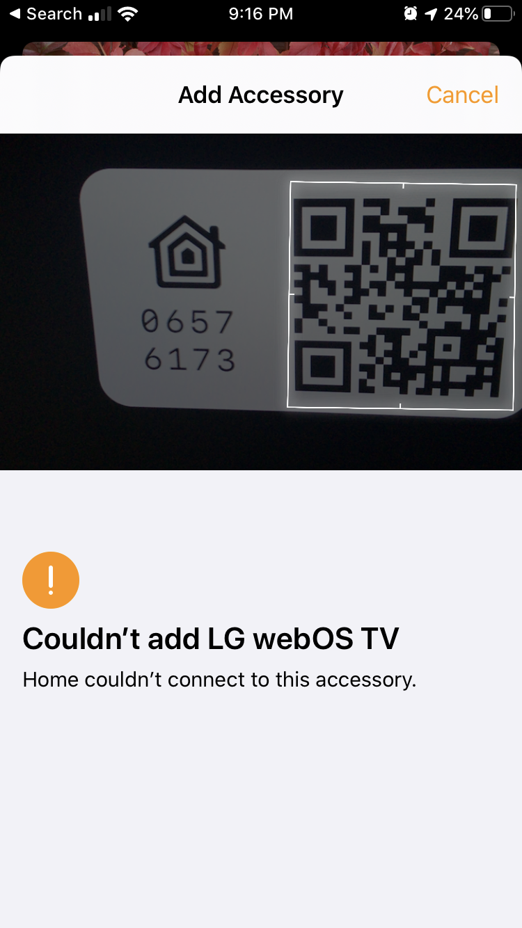

Bottomline: Magic Remote pairing with my set top box (using bluetooth) interferes with proper usage of the Homekit app. No solution yet.
update. I tried to use homekit again (there were LG firmware update and AppleiOS updates). At first I couldn't get it to work. My mistake, the LG was still partly connected to HomeKit. After severing that connection I was able to connect to Homekit AND use the connection Magic Remote + Settop Box. To the problem is fixed!!!!
