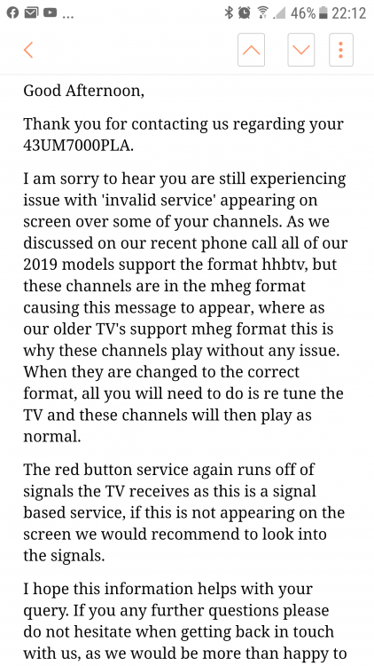

I have left a response *or two, on Facebook. Here is a copy of the email response as requested.

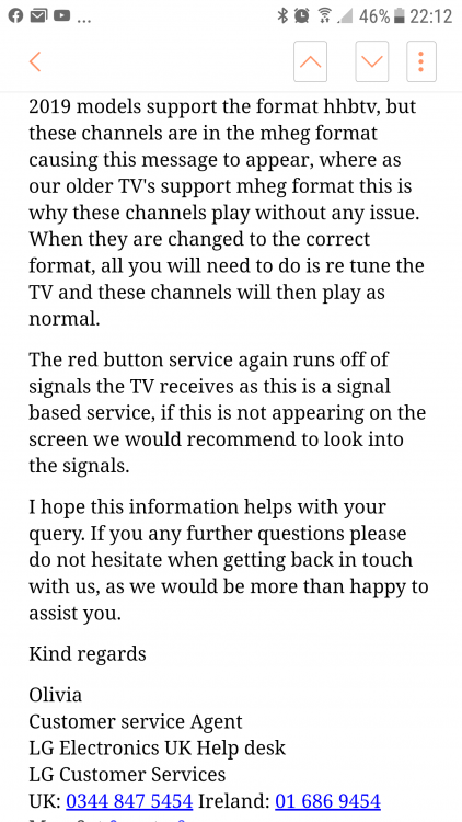

Indeed, here is a partial quote from the LG Facebook team:-
Quote
...a response from our team. This is not something that we have any control over here at LG.
Our tuners only support channels on a HBBTV format. Older channels are using an older format and so the TV will either not receive this or it will show "invalid service". This is based purely on the channels themselves, and they would need to be updated by the channel broadcaster.
We would be happy to raise this as a customer concern to highlight your issue; however, at this time there would be nothing we can do from our side of things.
They might perhaps have a point and it might be that it's a waiting game. Yet it beggars belief that despite knowing what the situation is they are more than content to basically 'stick it' to their customers.

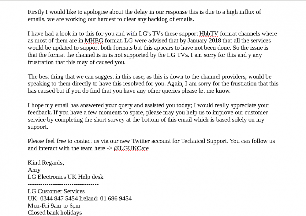

Hi again - just thought I'd share the LG email reply I received recently in relation to this issue. It doesn't add much to the sum total of discussion
so far .... but it shows that LG Customer Services are being somewhat intransigent and trying to shift the blame.
I think the LG response is unacceptable. Their TV should be able to receive all the current freeview channels just as their 2018 sets do. This was a decision made LG that give the consumer no choice . I have reported this to BBC watchdog program I hope some more of you do this as well as i think it is well out of order.
