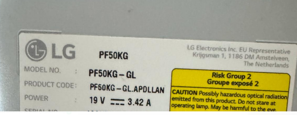

I bought an lg pf50kg  smart projector and can't find netflix, youtube and no app store so i paid for a projector that should be smart and ended up having a normal one this is cheating lg .
  • Sad 1
  • 1 month later...
Hi, i bought PF50KG too. And i have the same issue. There is no Netflix or Youtube pre-installed. I bought an expensive projector tht is not smart. It foes not connect to my ios as well.
Very disappointed. Not sure how to resolve this.
It seems they have now added the apps mentioned by you guys to the play store of the WebOS.
I haven't checked them out yet. I will wait until you guys talk whether you got any real value from the product.
Thank you for your reply.
There is no play store or LG content store in this projector. We cannot install these apps either. All i can do is connect the projector to a laptop or iPad via HDMI or Apple lightning connector and play the content.

Sorry to bother you.
I am a PF50KG model user.
There is an LG App store for these identical devices sold in different countries such as PF50KS, PF50KA. but my PF50KG has an empty Webos interface.
my only goal is to install NETFLIX and YOUTEBE.. How can you help with this?
