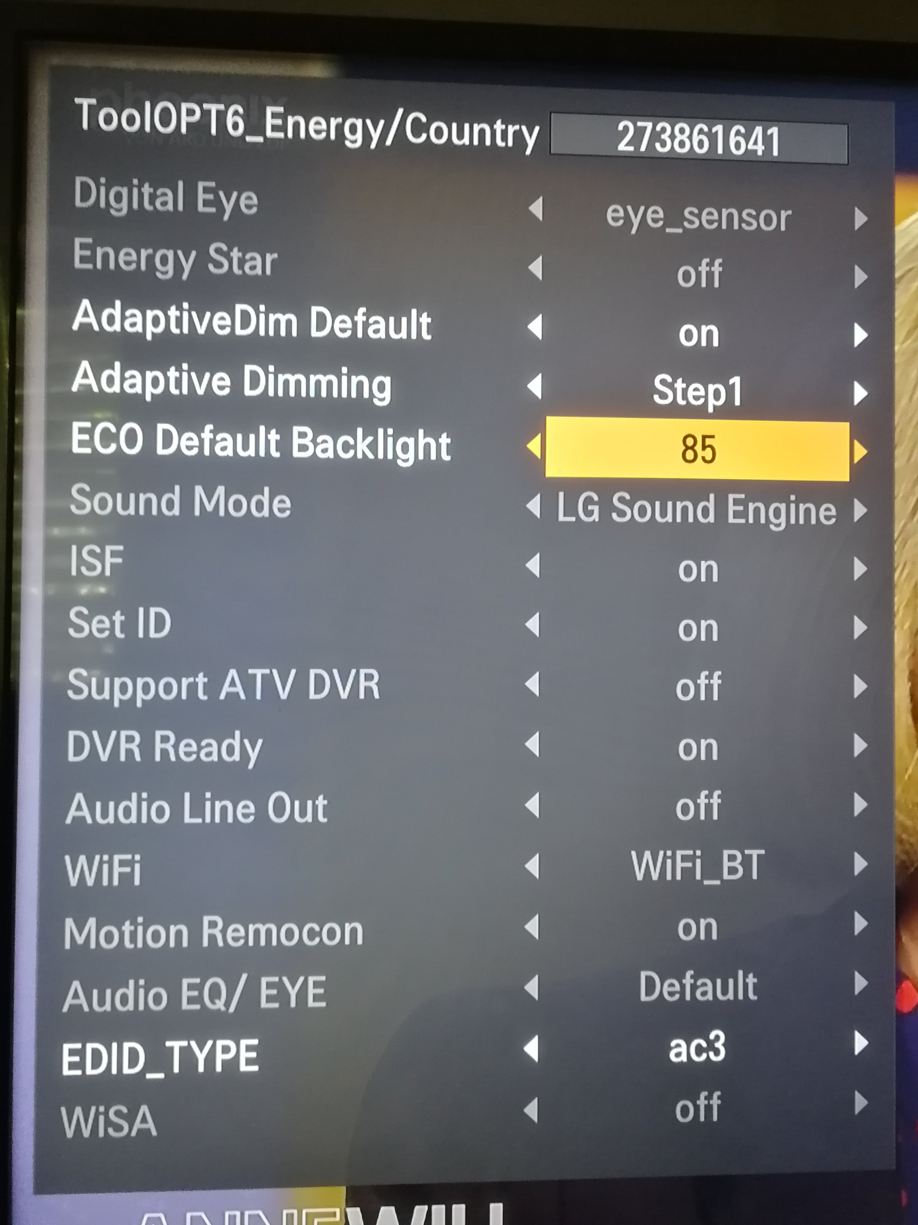

Hi everybody, thanks to @ponello I could turn the DVR function on, typing in this code in the service menu:
ToolOPT6_Energy/Country (541847305)
Then I had to change the country to one where the function is allowed, I chose Estonia 'cause they have a channel list compatible with Italy.
The only issue now is that Bluetooth is inactive, so my magic remote doesn't work anymore. I couldn't find the option to turn it on. Any ideas?

@Hblone
Hi there,
I found a code which activated DVR and which also left Bluetooth activated. I took a screenshot. The country of transmission must then be changed to a country in which DVR works. I changed it to Germany and so far everything works fine.

Hello, glad it worked !!
Maybe I also found how to reconnect your remote. You can try folowing this video. At minute 3:45 shows to push two buttons on remote for reconnecting- Let us know please.
Unfortunately the magic remote does not work anymore in its pointing function, probably something happened to the motion engine, because it pairs regularly, but the pointer doesn't move anymore. I also switched the TV back to the previous original settings, I found a remote test screen on the service menu and it says that the remote work properly but the motion engine is not present (in the TV for what I can understand), but it worked before I changed the code.
I'm going to ask to LG service how to have it work again and I'll let you know.

Hi, the option you refer to at no.3 is DVR READY under toolopt6 menu. You need to find a toolopt6 code that enables that option, but make sure that all the other options are compatible with your tv, better if you find a screenshot of the toolopt6 menu to check it before typing in the new code. As I wrote in a previous post I would suggest you to select a toolopt6 code of the same class of your original code (take a picture of it in case you need to roll back to it).
After you get DVR READY turned on, you have to select a country where USB recording and live tv are available, if in your country they aren't, otherwise it will still not work. The issue you will face is that tv channels may be set in the wrong order. For example I could select Estonia, which provides the same channel list of Italy, so I completely solved the problem.
