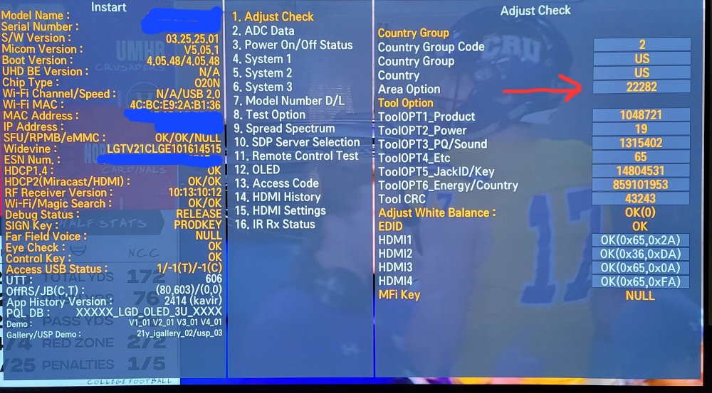

Hi all, I'm a United States C8 owner. I've read this thread but it's unclear to me if someone in the U.S. has successfully enabled live TV recording. I have a service remote and I'm ready to go if someone can provide the correct code(s) in a way that doesn't disable bluetooth and doesn't give the wrong antenna frequencies.
I appreciate your help!

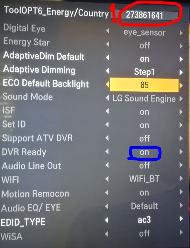

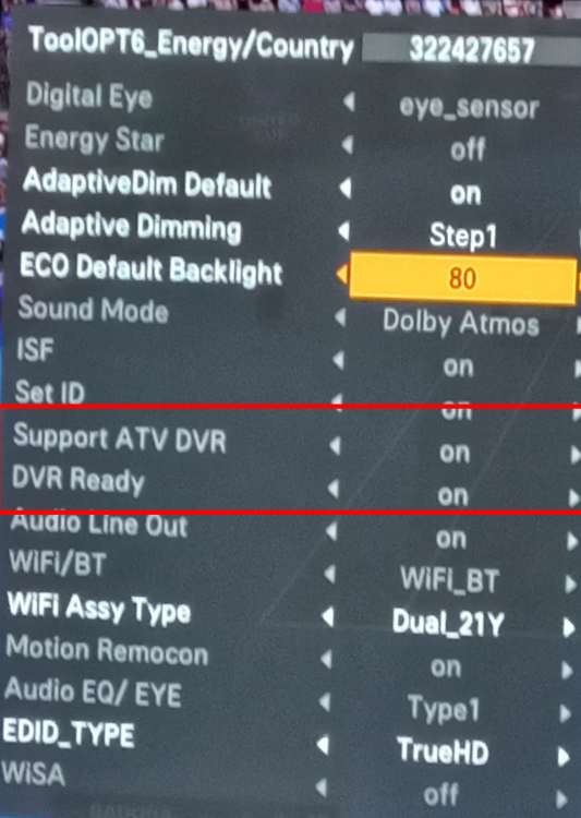

hi.
(** The responsibility belongs to you.)
Log in to this menu on your TV. (toolOPT6)
Take a picture of this menu. (Don't lose this picture just in case)
Then replace the red marked place in the picture I sent with the numbers in the picture. (change it to : 273861641)
and take another picture.
compare it with the first picture. Only the blue area should be different. (on/off)
Thanks for your prompt reply. On my TV the menu appears to be different, with the DVR READY field on Tool Option 3, not 6. Also I'm not seeing how to change that number at the top -- do I need to change my TV's region first or something?
Thank you again for your help!
USLGOwner,
I too am in the US and have an LG C1. I am also new to this and trying to learn exactly how to unlock something that is 100% capable of DVR. I am not able to see my TV right now but I do believe that you may need to change the area option under the "adjust check". This may be a different button in the service remote if i am not mistaken. I changed it to 1793. This then allowed me to change the  toolOPT6 menu to the recommended 273861641.  I believe this is where I got stumped and will have to come back too.
I have no idea what the "adjust check / area option" does, if someone could shed some light on the subject that would be helpful.
Thanks to all that contribute to this thread.
Let me know what you get.

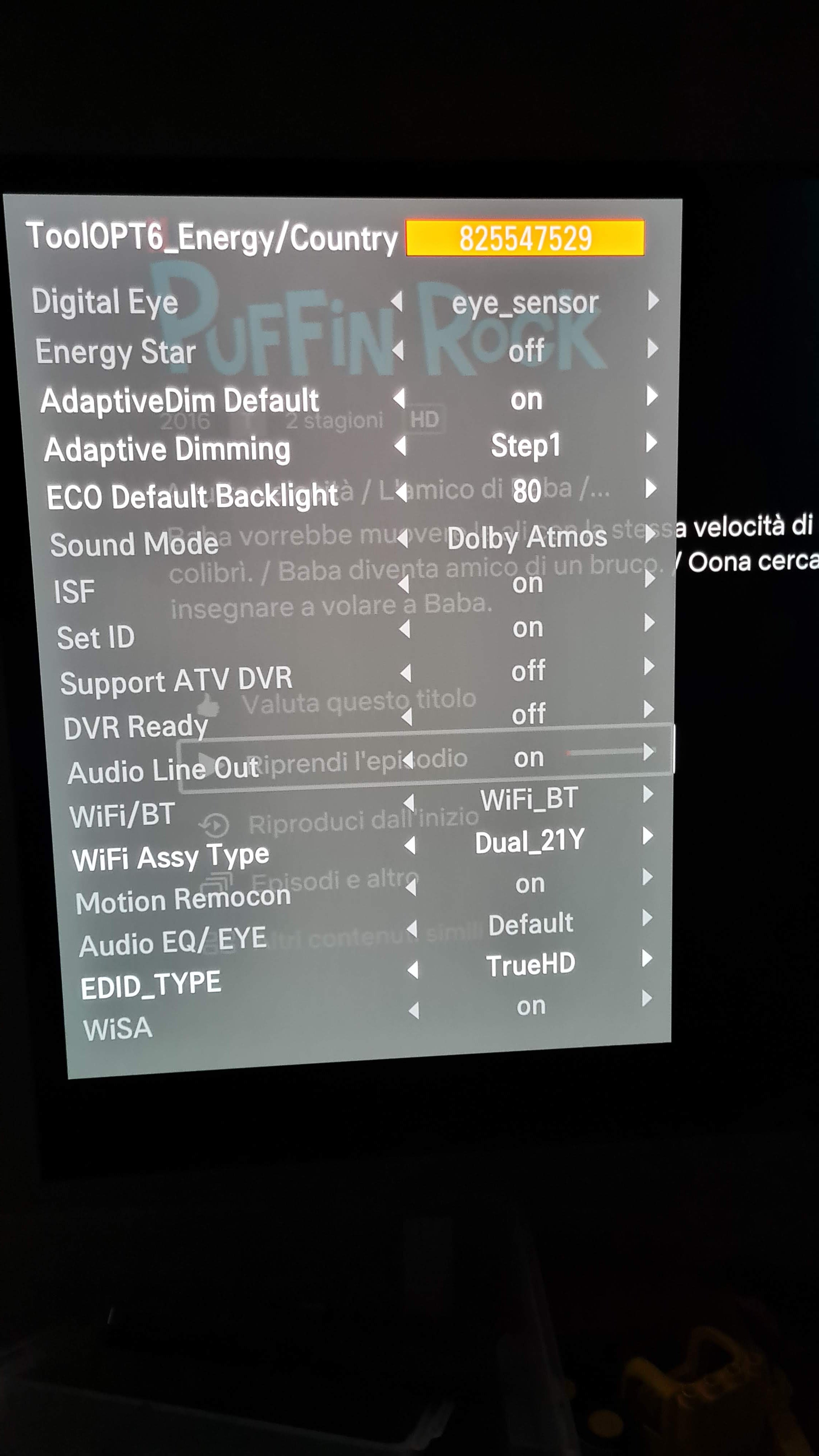

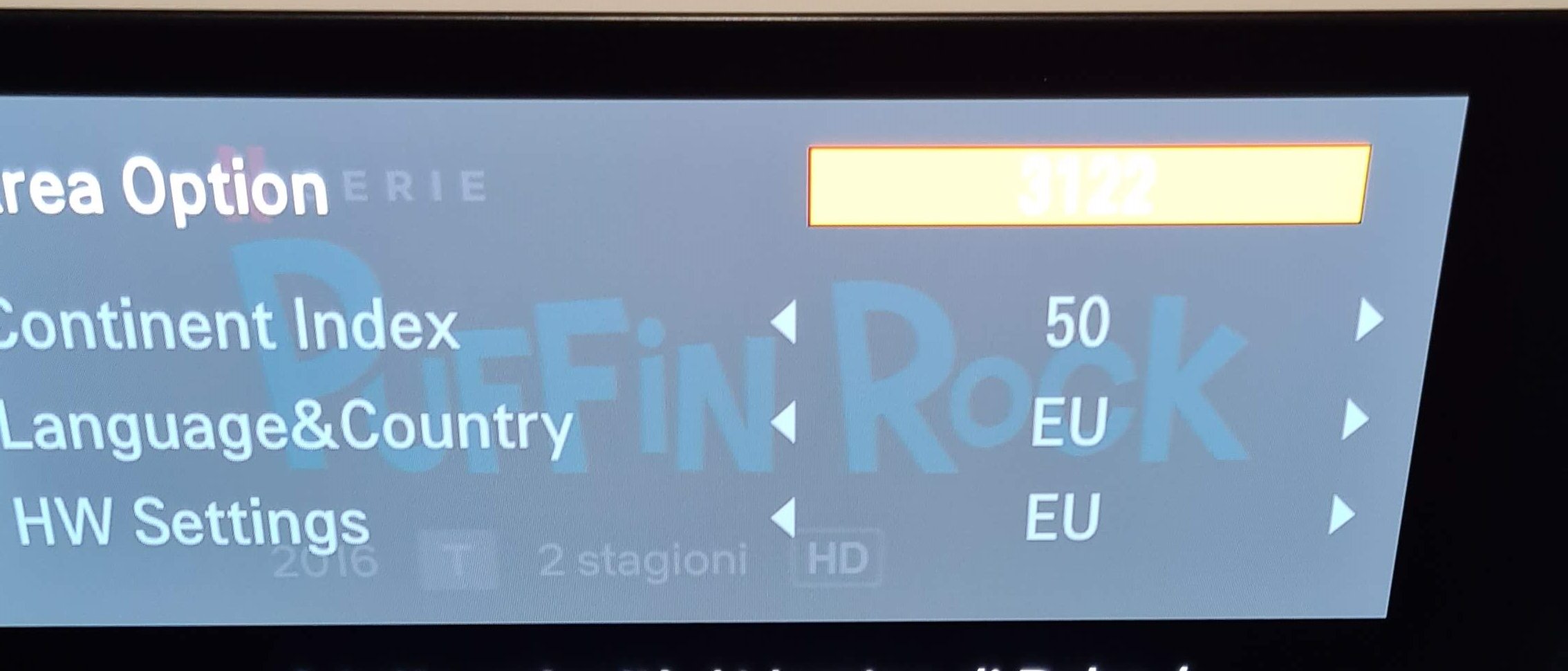

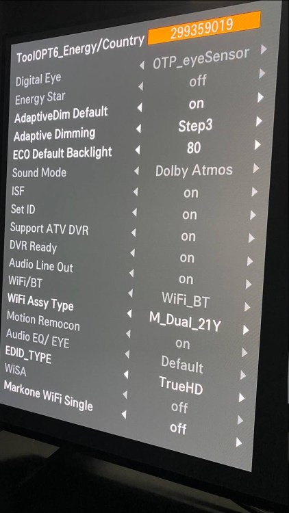

Hello everybody,
I have my OLED C16 and I would like to enable the Time shift option which in Italy is not enabled.
This is my current setting.
20220309_205638.thumb.jpg.3b66e14872d27a34adabff18d9bb95a8.jpg20220309_205723.thumb.jpg.803c47092141e695ae9a62189345096e.jpg20220309_205718.thumb.jpg.3e831459bbc2df27e392cb8e07c1e0b4.jpg
Which  area code or ToolOPT6 do I need to change?
Thanks everyone for the help

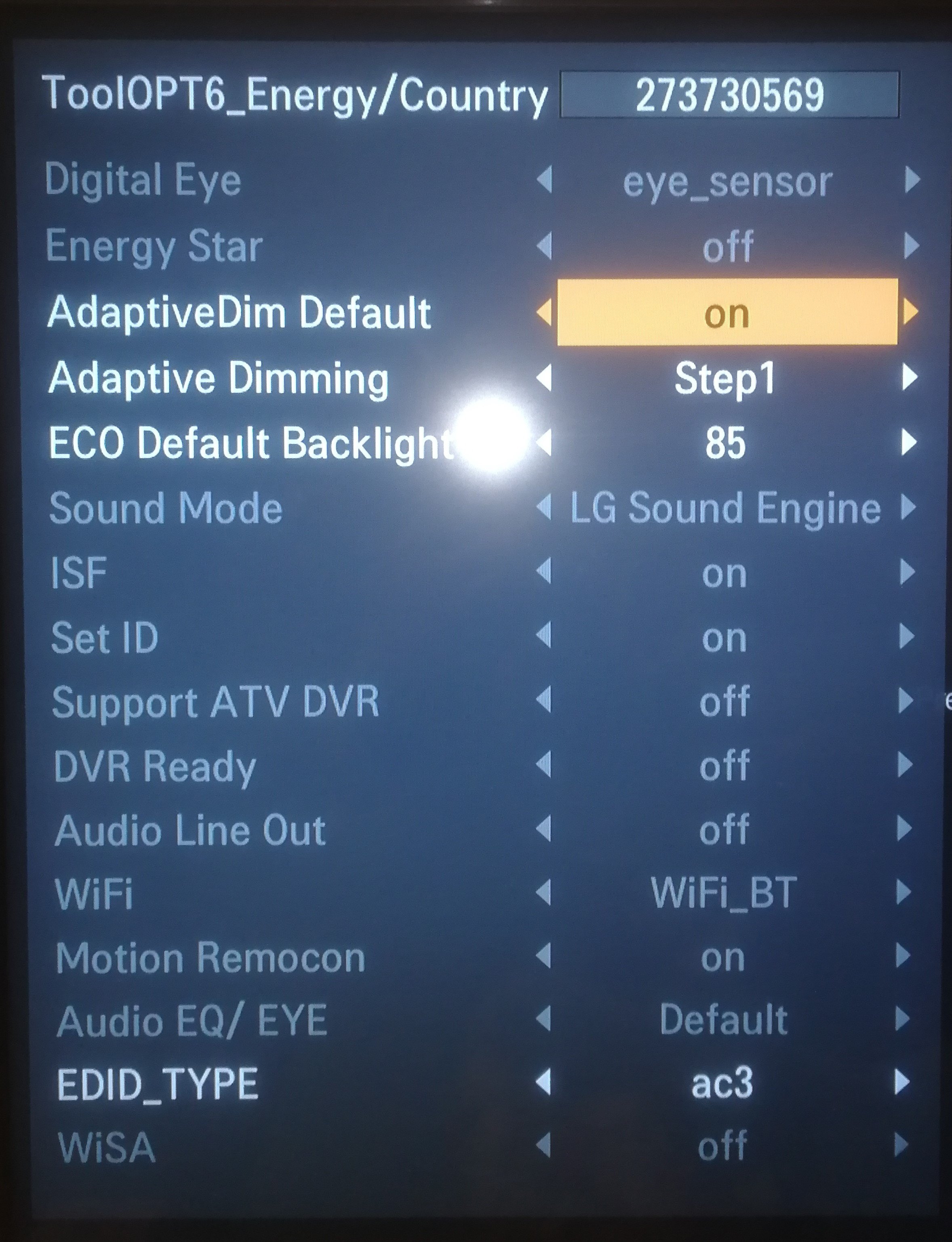

Hi, you need to change ToolOPT6_Energy/Country code with one that has DVR Ready option turned on. Try to find one online, or maybe someone here in the forum can help you. Before typing in the new code, I suggest you to make sure it is the same class of the one installed by default on your tv (it starts with 825.....) and that all the other options are set the same way, otherwise you might experience some malfunctions that may not be reversible.
I was given the code for my tv by another user of this forum, but unfortunately it has very different option settings from yours, so I wouldn't try it on your tv.

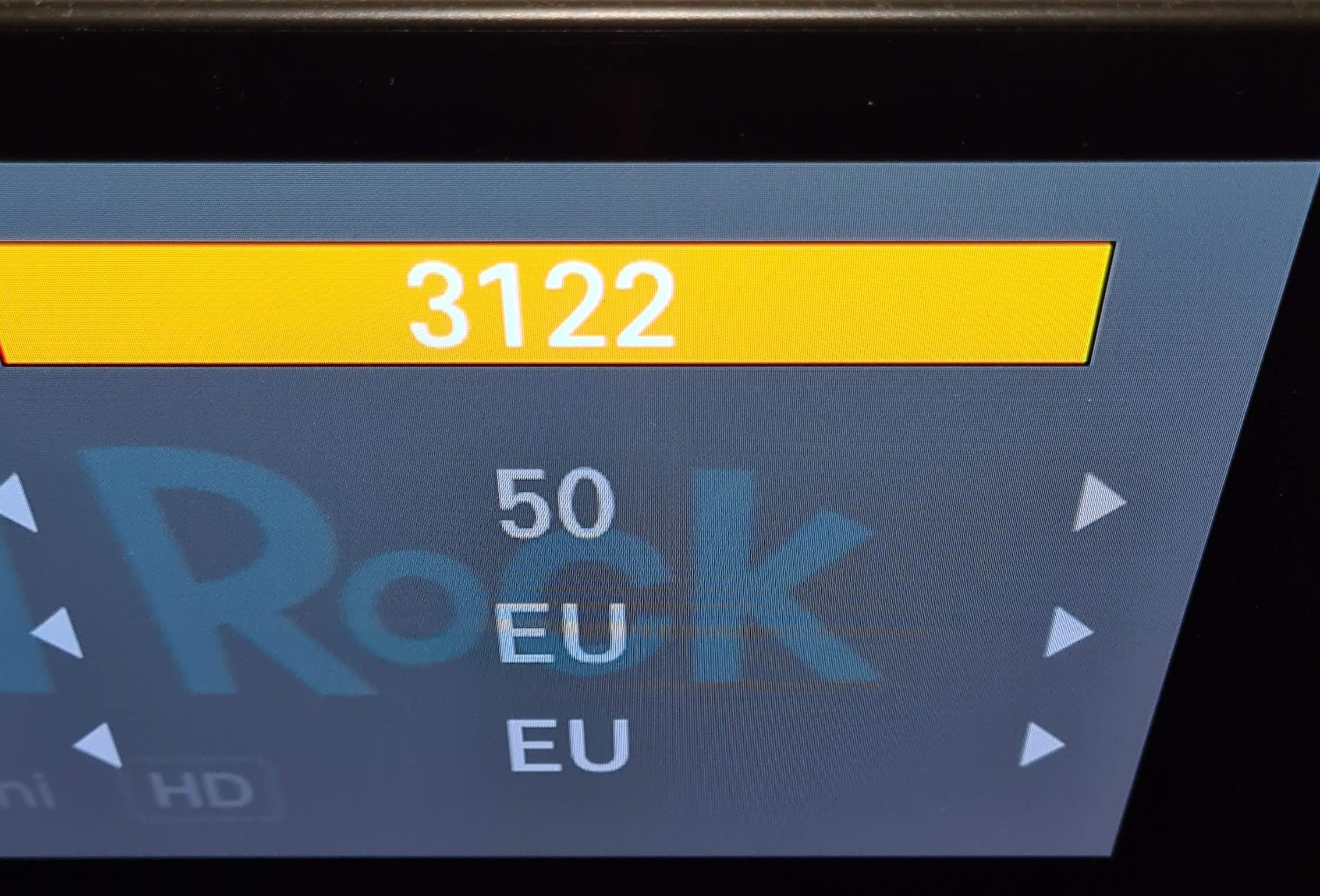

When you find the correct code that enables DVR Ready option, then you have to change the country from the tv settings menu to one in which DVR is allowed, if you live in Italy you can choose Estonia who has the same channel list of Italy so you will have all the channels sorted correctly.
Hope this will help you

In the meantime I tried to change the country to Estonia, but the new channel numbering list does not correspond to Italy.

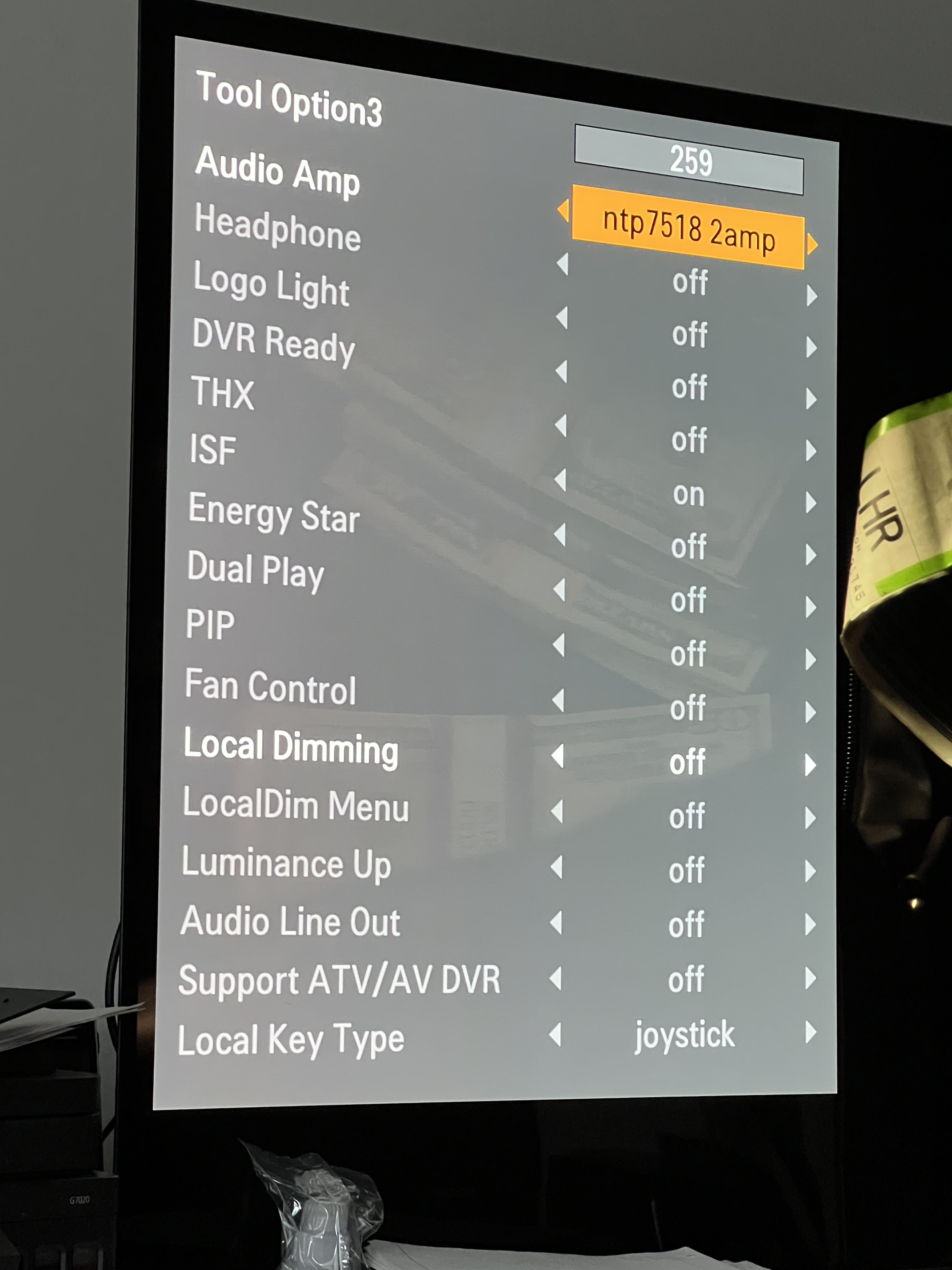

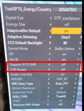

tool option3:   323 try.
be careful, only the "DVR ready" section should change. Do not use if there is an error.

@filfae Yes, I finally managed to enable PVR and Live TV functions and everything is working fine!
I don't know the meaning of the Energy/Country Code at Toolopt6, what I could understand is that changing them will enable/disable various options in the TV software - I believe they refer to the different TV models and to the Countries in which they are sold. I also think that different TV models have different toolopt6 "class" codes, meaning the first two or three digits in the code.
What I suggest you to do is to take a screenshot of the default code on your TV, then search for a screenshot (you can probably find it online or asking on this forum) in which the code has the same first 3 digits but the "DVR Ready" switch set to ON and, VERY IMPORTANT, all the other options set the same as your TV. Selecting a code with random options settings could result in malfunction or damage to your TV: I was lucky because the first time, even if I typed in a wrong code for my TV and it deleted the Magic Remote support engine and some other minor functions, as I later typed in a correct code of the right class of my TV, a software update was released that fixed the problem, and everything works great since then.
When you find and type in the correct toolopt6 code for your tv, then you must change the geographic area in the options menu to a country in which DVR is enabled, and the channel list is the same as Italy. I selected Estonia and it works great. The only issue is that I had to turn off automatic time zone selection, so twice a year I have to correct the time manually.
Hope it will help you.

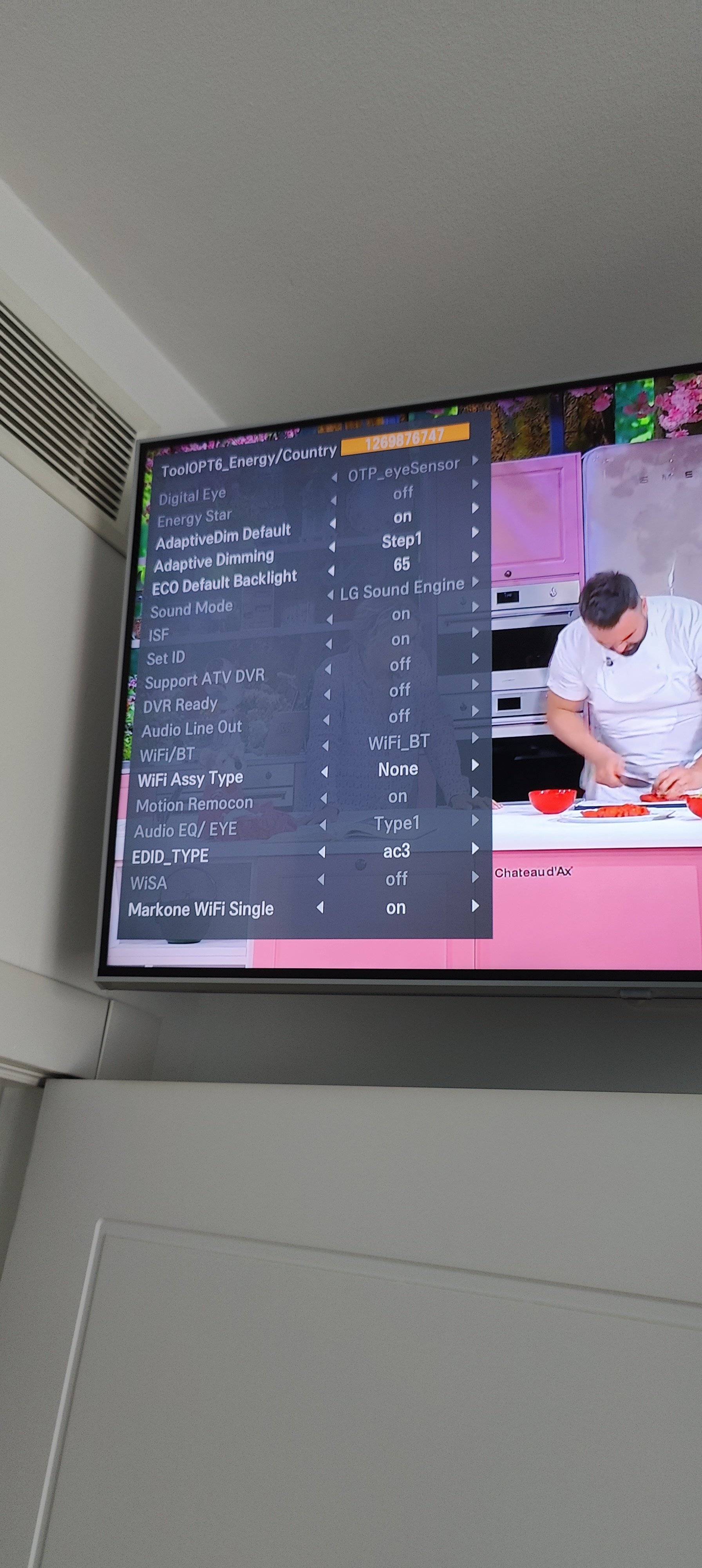

Still on this question:
I am looking for a "ToolOPT6_Energy/Country" code with enabled PVR/TS for my OLED42C26LB.
Here what I have there:
Some of you may be interested to "ToolOPT6_Energy/Country" code of my OLED65C11LB:
It is a non Italian model. I could enable PVR/TS by changing broadcasting position to Austria and getting back to Italian LCN. Here the procedure I have used:
In case you are interest you are interested, you have only to translate and change ITA with your country. It is generic and it should work.
