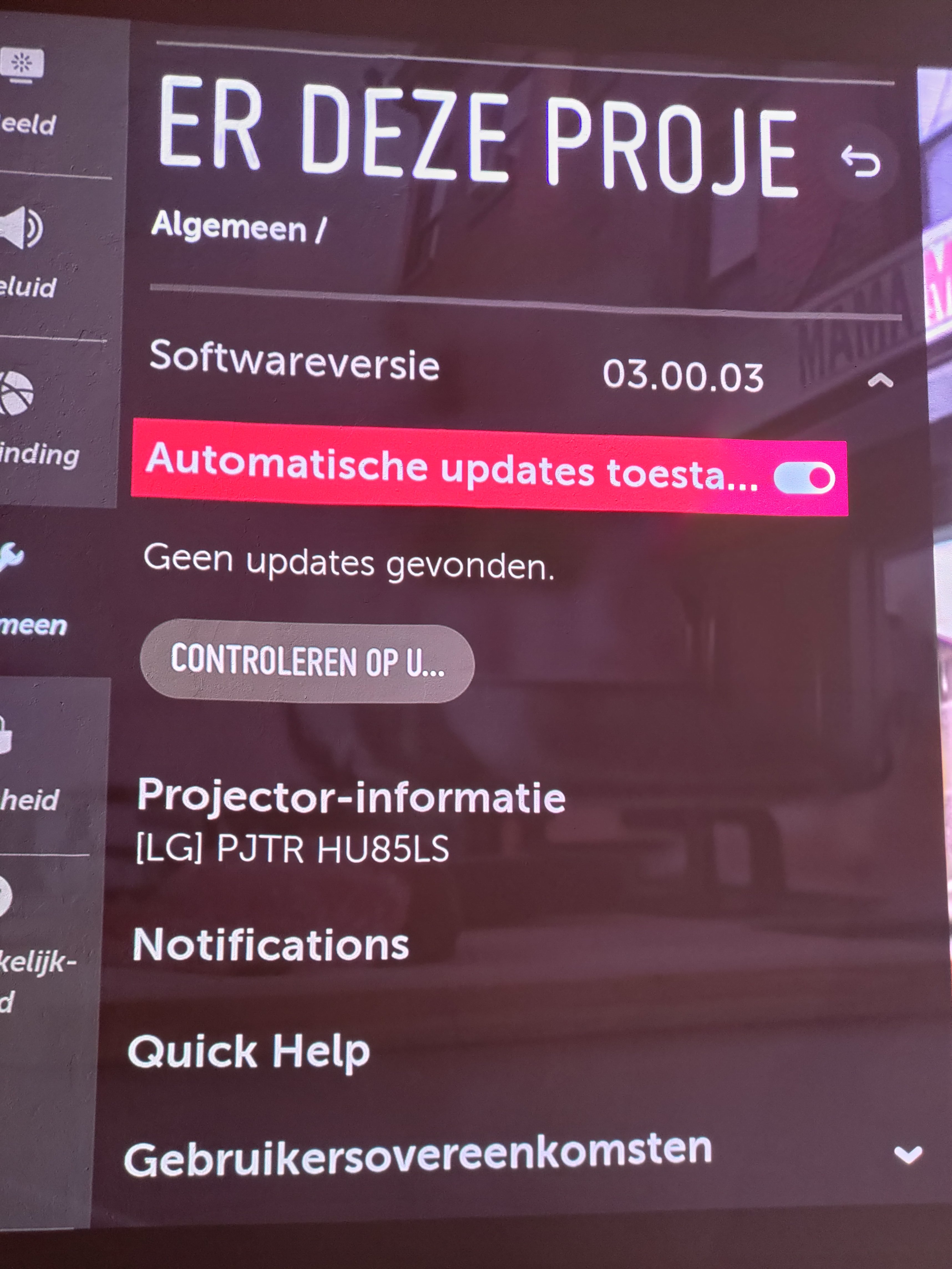

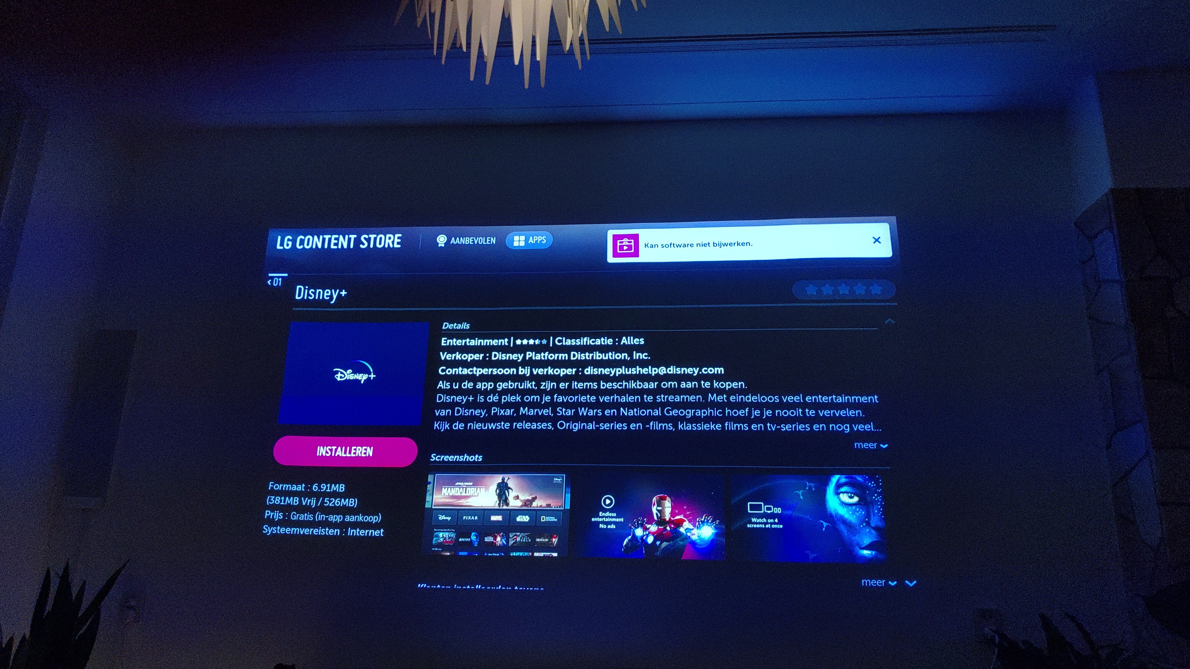

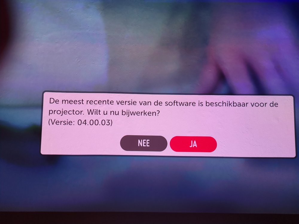

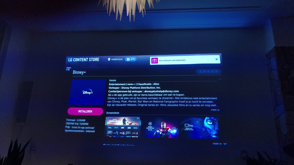

At last I see the Disney plus app, but now the LG content store is mentioning, to use this app the software needs to be updated yes/no so I click yes and then I get the notification , "can't update software"
Does anyone have an idea?
I did already power of and pull the power cord form the mains. And restarted.
I have exactly the same problem. Do you have a solution?

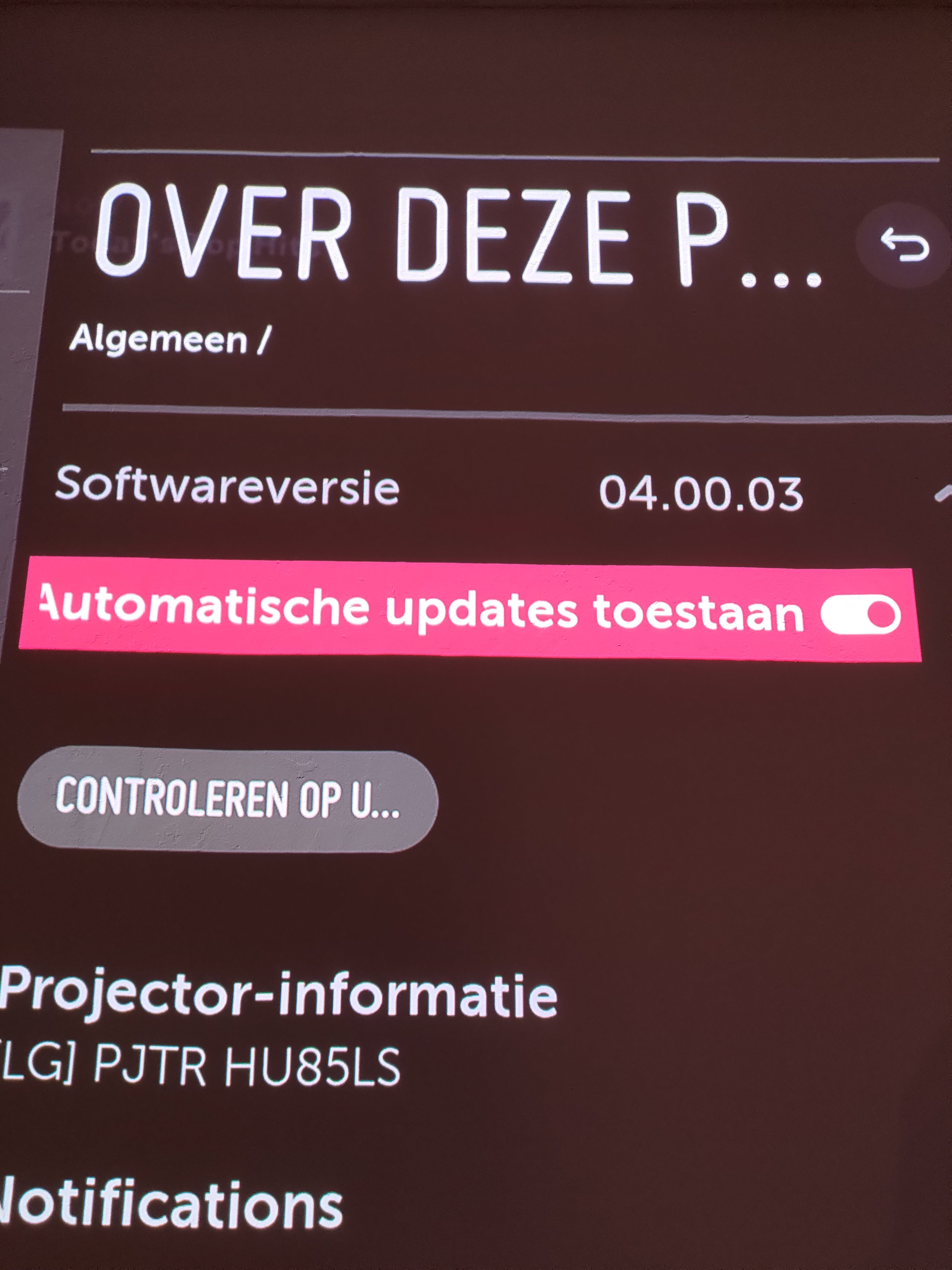

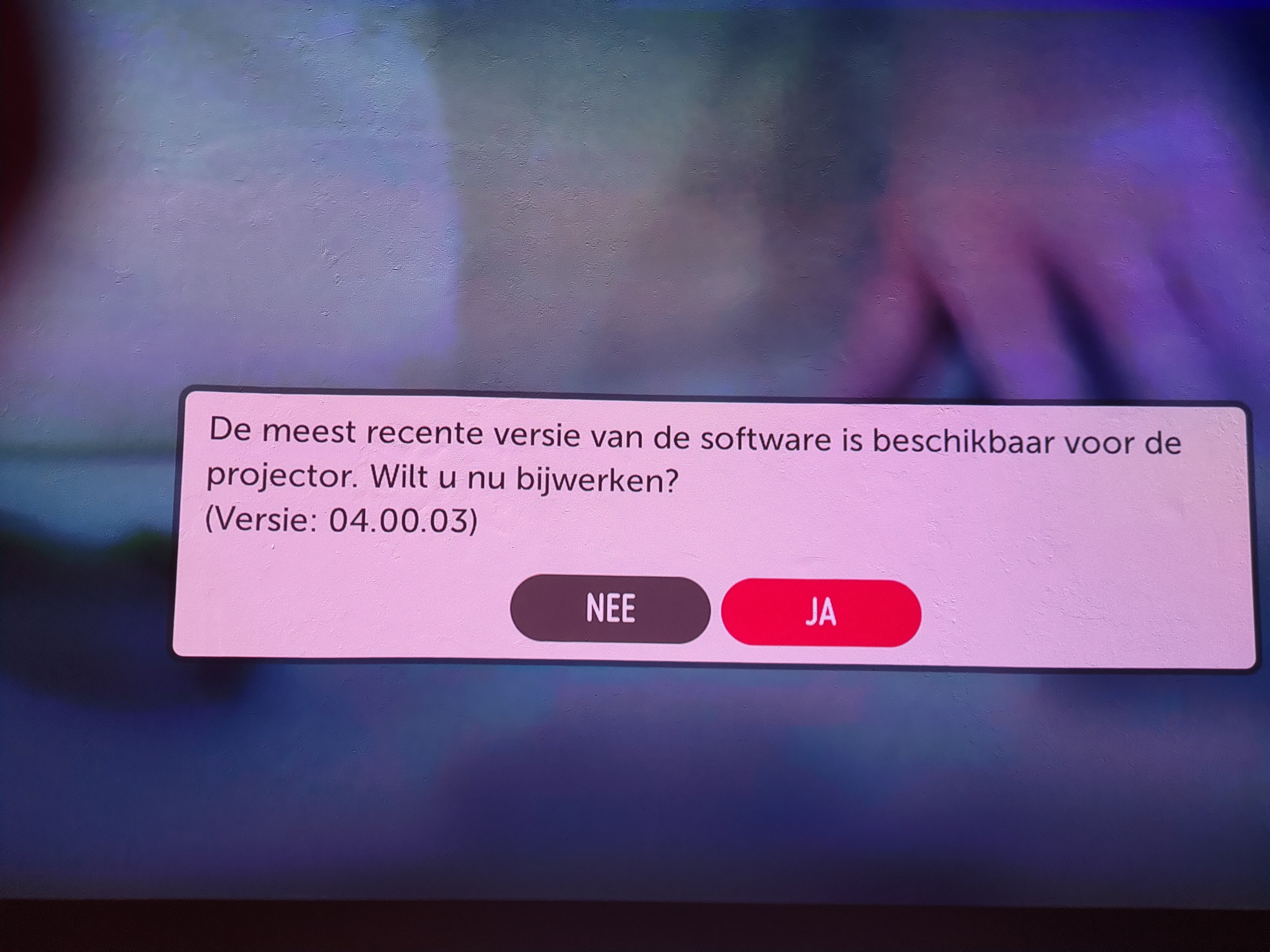

SOLUTION for everyone here 🕵️‍♀️
LGHU85LS  problem is solved @ my side.
solution is fount here":
Disney+ installed after the update towards SW 04.00.03    was SW 03.00.03
If someone wants to receive the SW let me know.
  • 3 weeks later...

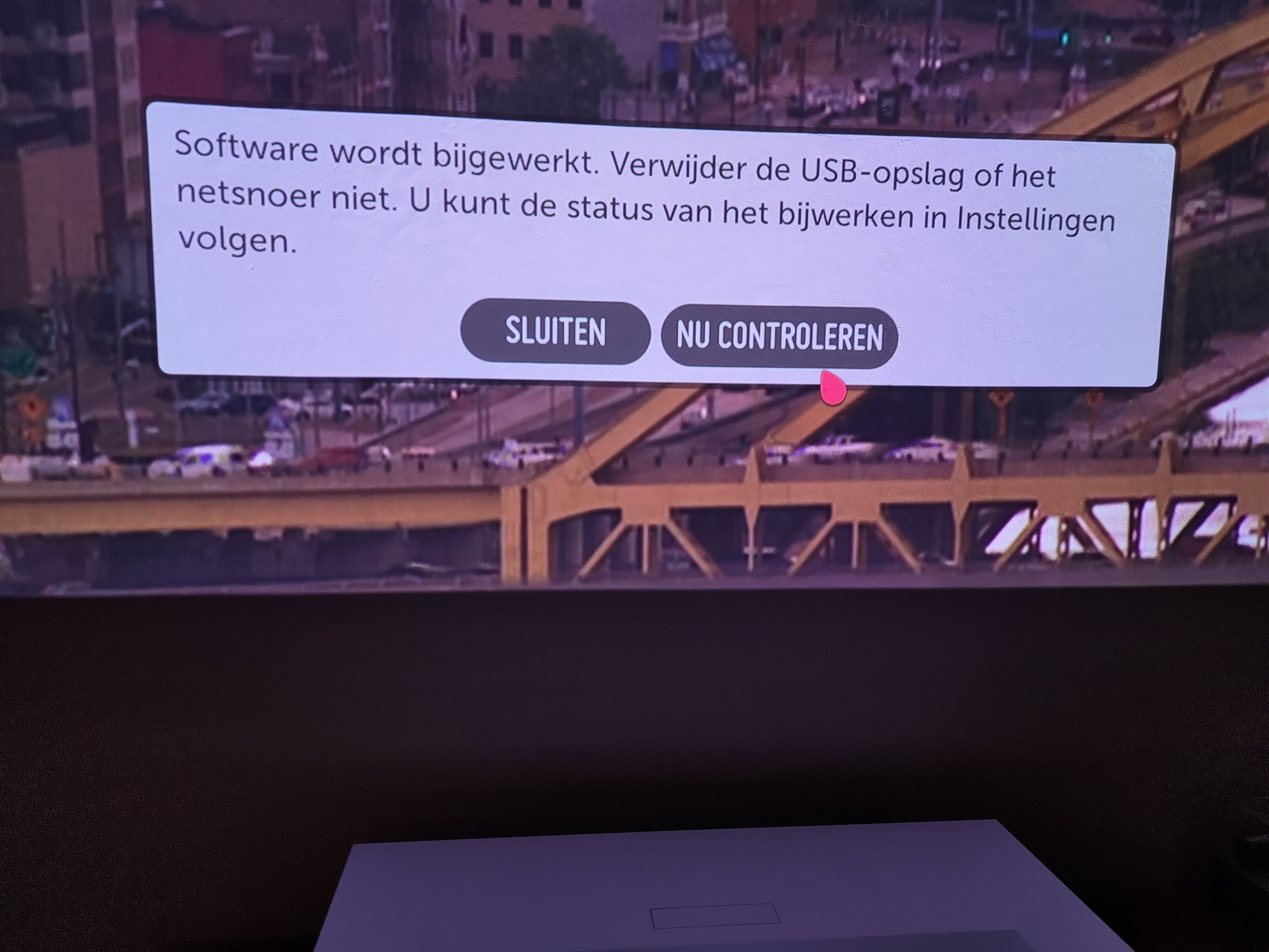

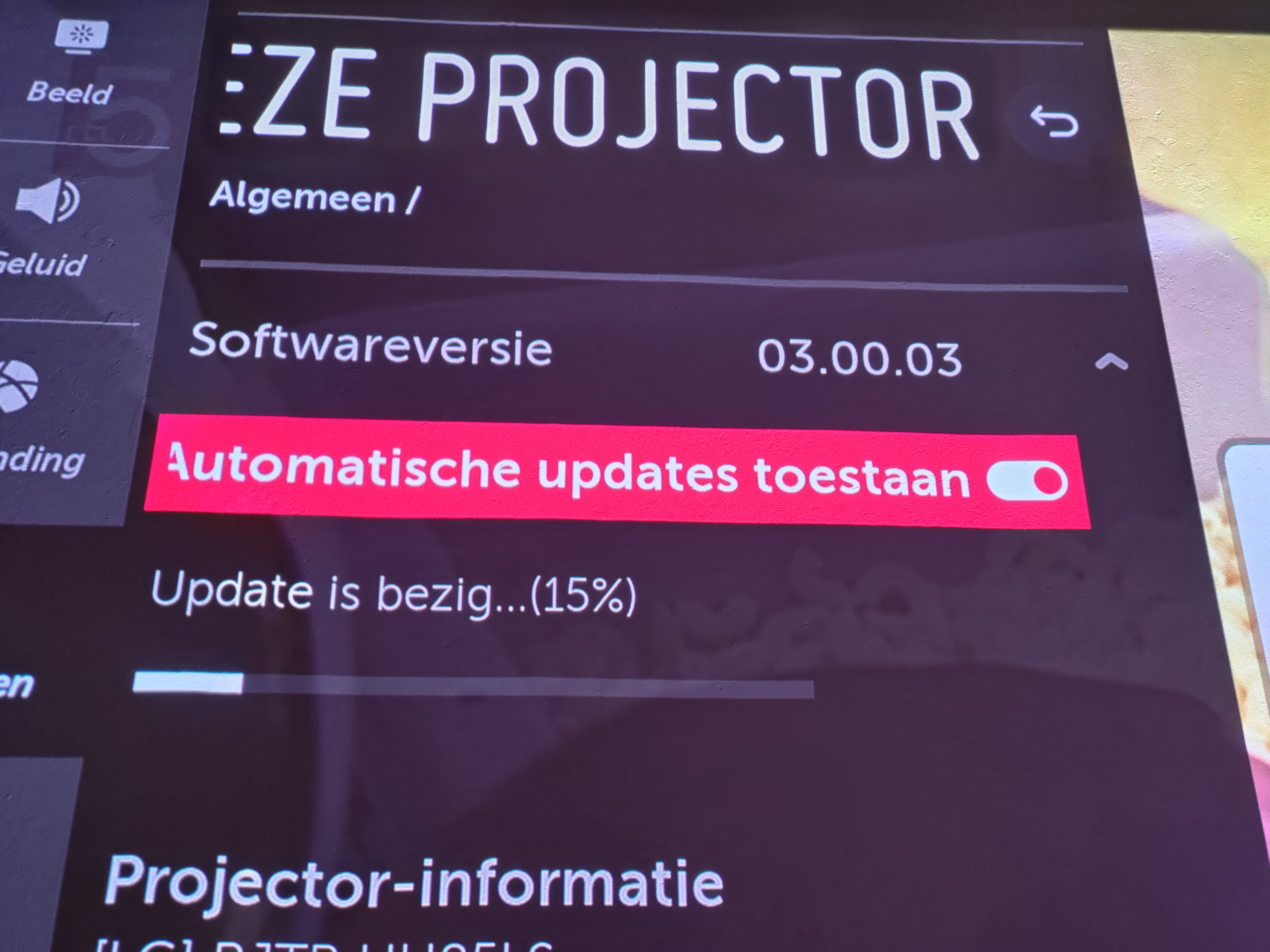

Hi @Sébastien Lep and probably others.
Here is the link to the webOS software:
I had one small "error" after installing Disney+  but next day the installation went fine (maybe it needed an extra powercycle)
good luck with it and spread the word.
it will expire again after ONE week so until 8april2022 10:37 AM
