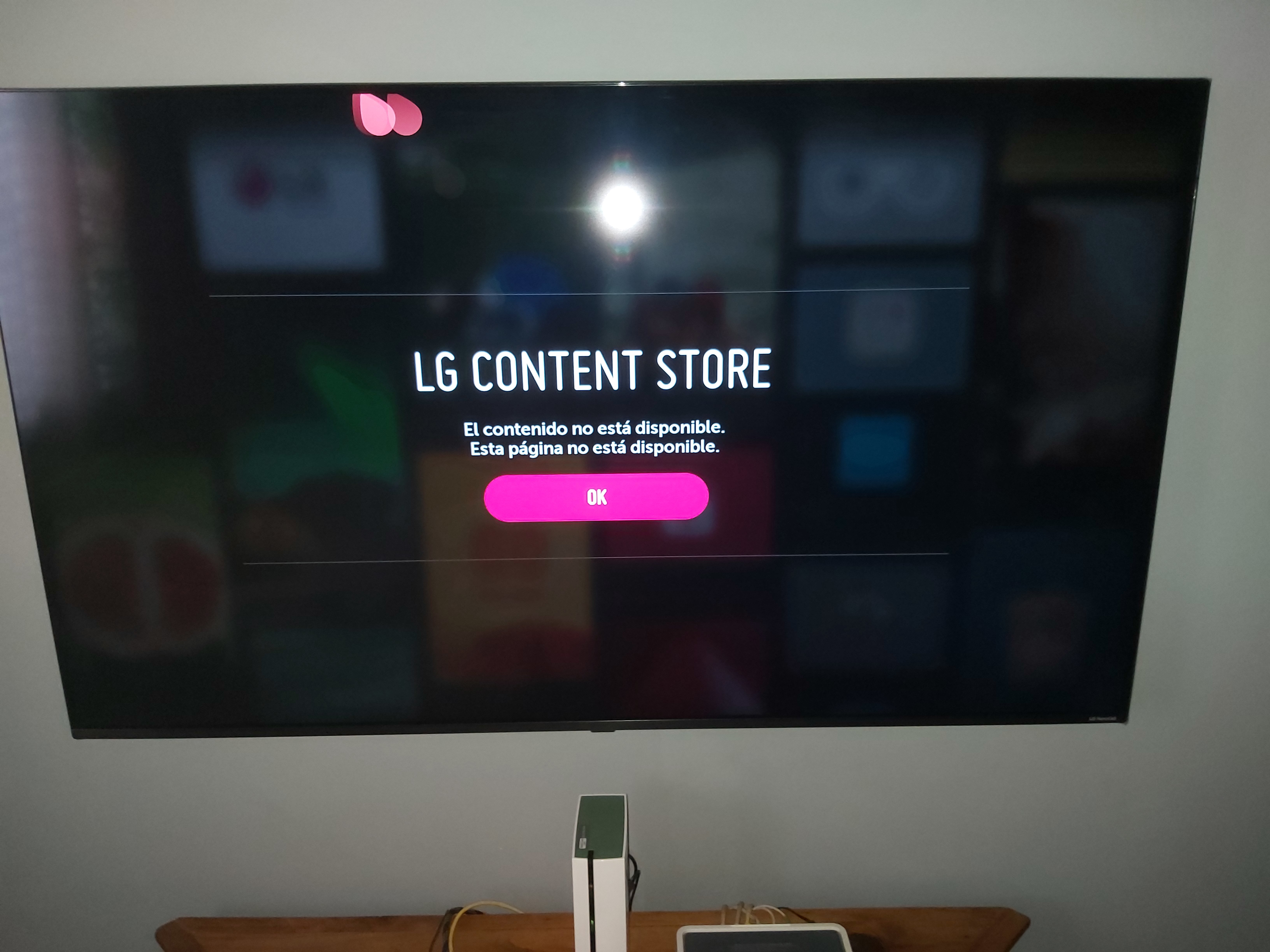

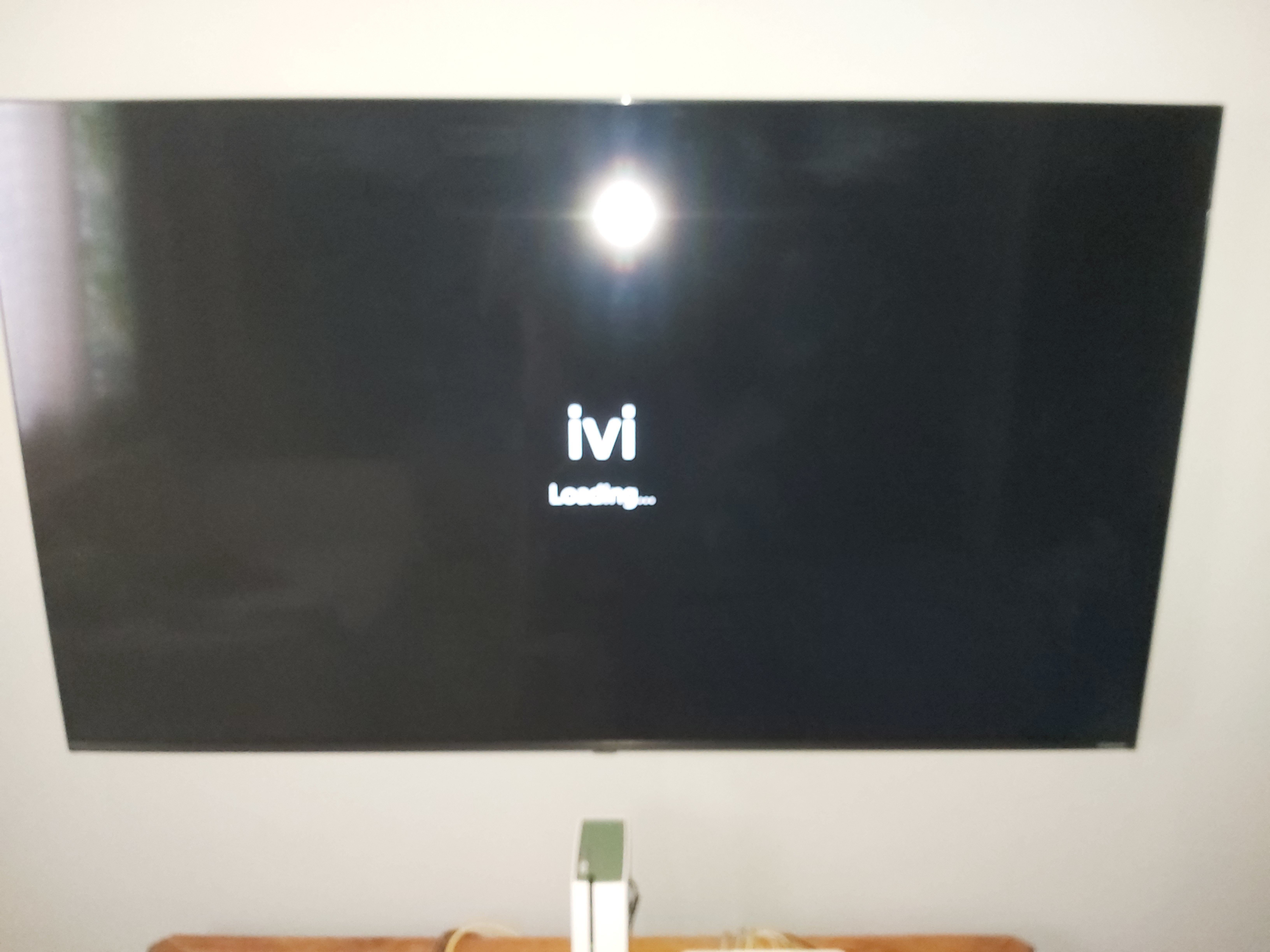

Since my  55´ SM8200PLA was updated to 5.00.02 version, every time I turn on the tv, ´ivi loading´ message appears, then gets into LG Content Store, and then shows ´This content is not available´ and hitting OK, goes back to my HDMI connection as per usual.
Once the tv is showing programs, if I get into LG Store, everything is normal and works properly.
How can I get rid of this annoying issue?

Tried that and not working... searching about what "ivi loading" is, discovered ivi is kinda auto webos system...or something like that, but why is showing in my tv?

@raspia What country are you using the LG TV, and how did you update the firmware? Did you download it yourself, or was it an Auto Update by the TV itself?
The reason I ask, I have just spotted this from Wikipedia: "ivi (ivi.ru) is a Russian online video streaming service which offers licensed video content, including more than 65,000 titles of movies, TV shows, cartoons and music videos. "
So, unless yoiu are using that TV in Russia, that "ivi load" thing is NOT Valid, and points to a bug/mistake in the firmware image build by LG for your country, or you got a "suspect download" image if you did it yourself manually, and use a USB stick.
I´m in Spain... the first update to 5.00.03 was through TV Menu, the last update (5.00.10) was through a pendrive, and I downloaded the frimware from LG SUpport page...
The ivi message and LG Content Store error happen since 5.00.03 update.
Here hare some captures of the proccess:
Another thing I tried is to download and install ivi app from the strore and uninstall it, just in case but no succeed.
