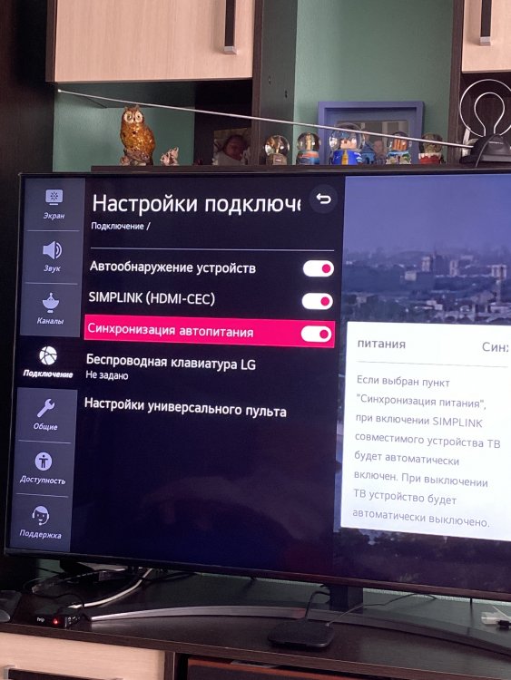

You guys can try going to All Settings > General > Devices > External Devices > Universal Control Settings
Select HDMI 4 (where I assume we have our sound bar / device connected).  Click Manage Settings.
I found there what HDMI port ARC was assigned.
I moved my connection to my sound bar/device to that port… and it worked for me.

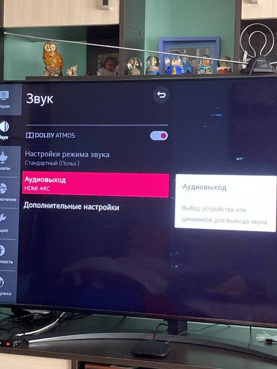

On your receiver switch to a different input so that they TV switches to HDMI2, then switch back to using netflix or what ever on the TV and this will temp get it working for you.
For me, I found I had to go into the Home -> settings -> Audio (not the quick settings on the left from the gear icon on the remote, the one from the bottom Home menu) and turn on HDMI-ARC and then select "PCM" instead of "Auto".  On Auto some Apps like Youtube would work through ARC but Hulu and Netflix would not, but now all apps are working!
