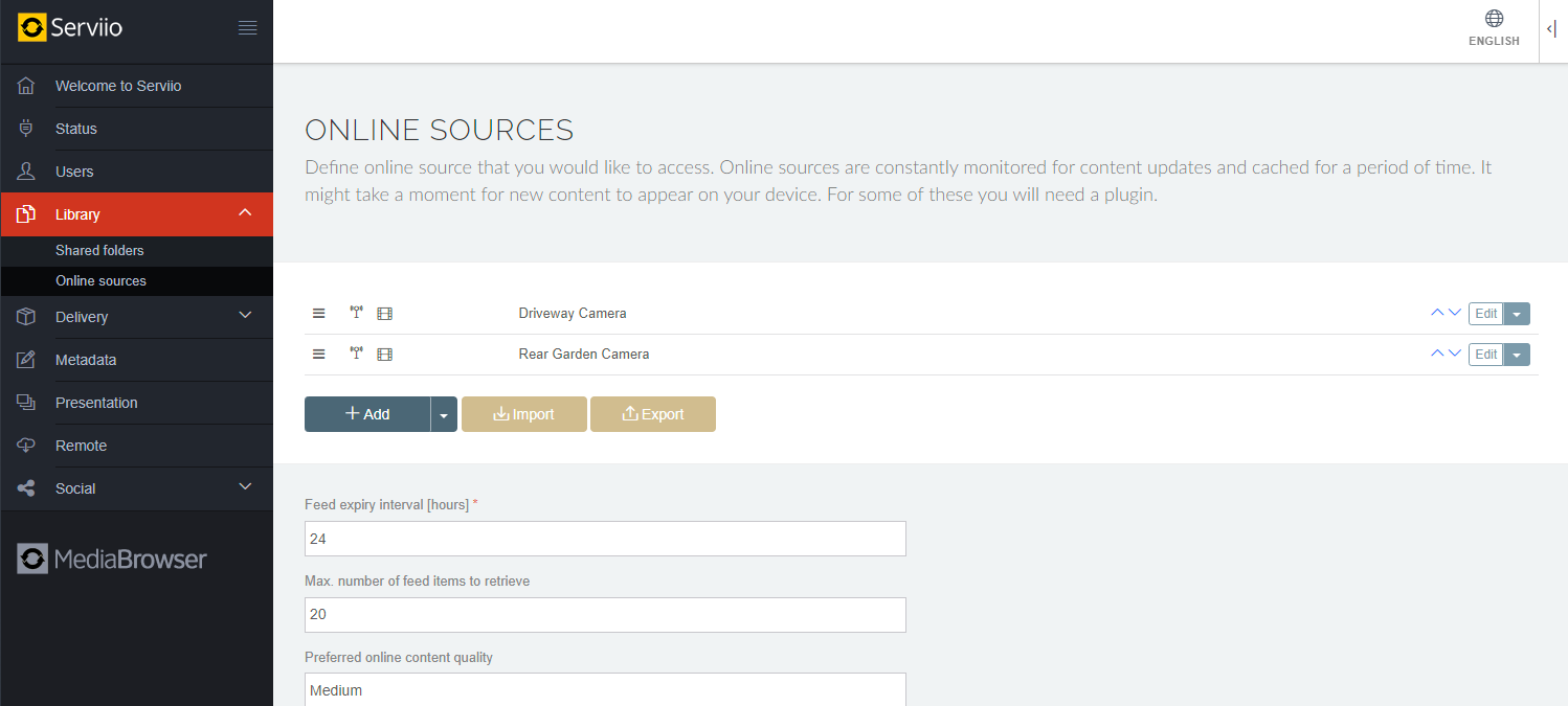

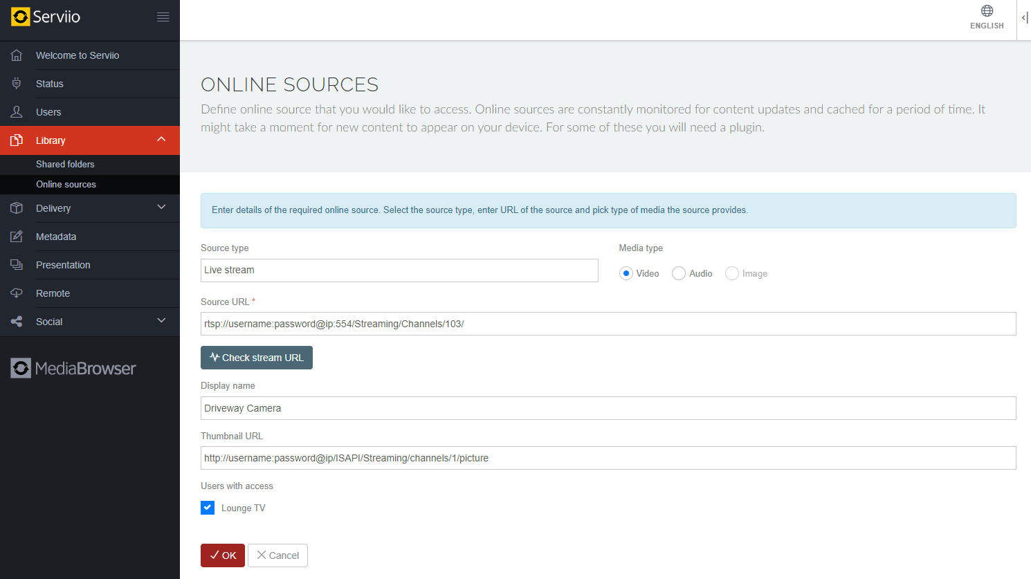

I’ve ended up using Serviio in a Docker container running in the NVR which works well and through access control can allow you to limit it to just the TV’s IP address. If going down this path the only thing I wish is knew before is to remove all content listing apart from “online” and reduce nesting. Also currently with 2.2.1 and below of Serviio if you have a username/password for thumbnail access it won’t work (RTSP will though even with auth). I’ve raised a bug with the author.

Thank you for your kindly help, may I pleas ask you shortly to describe me the process? I have one Win64server 24/7 on on the same LAN, I'm thinking to use it to convert the stream into DLNA, is that the way? (the DVR can't be used for run other processes).
For example:
Install Serviio for windows, add to it the stream rtsp, set this and that parameter, etc. Then what to use on the side of TV to load it, thank you really a lot for your help :)

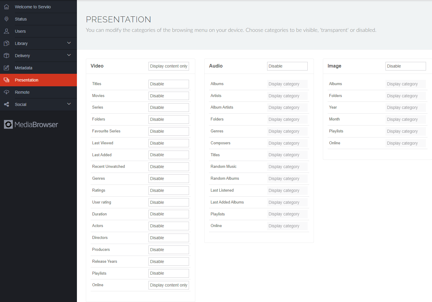

"If going down this path the only thing I wish is knew before is to remove all content listing apart from “online” and reduce nesting"
going down this path means the use of Serviio is not working, or it means that the camera stream will go down?
What do you mean with the content listing? In which part of Serviio is contained? So I have to remove all extept the voice “online” and "reduce nesting"?

The screenshot with the heading Presentation. Serviio can host a lot of content all on one, you’ll have a huge number of folders to navigate every time you want to look at your cameras unless you turn it all off. That screenshot shows how to configure it for easy access to the cameras. It works just fine.

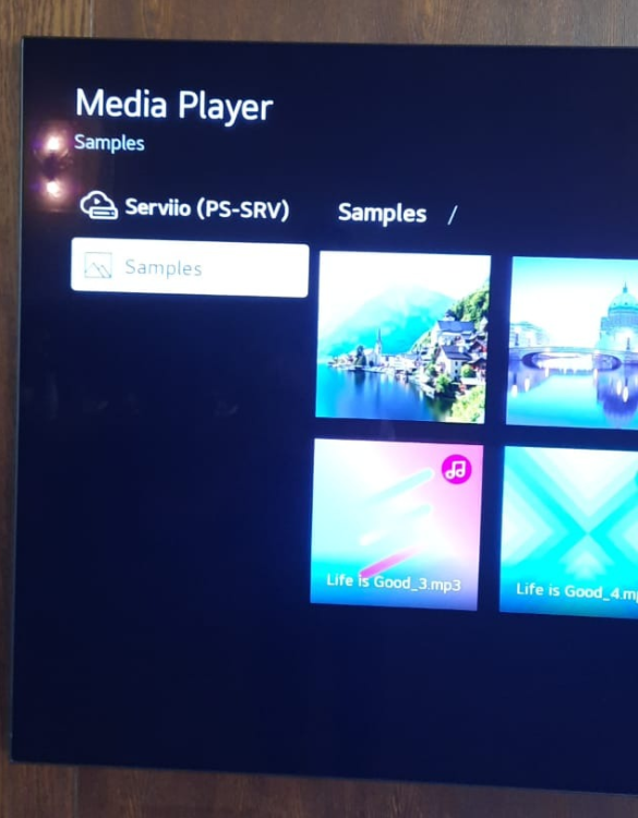

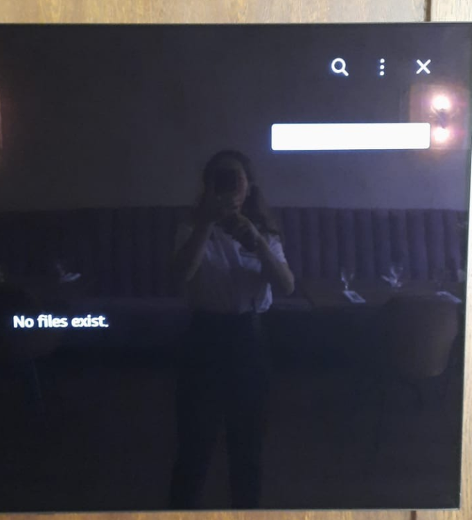

Today I've remotely accessed a 24/7 server and there I've installed Serviio, following your guide I've connected the video rtsp source and tested it, then blocked all the presentations as you showed in the picture. Serviio is able to detect different devices in the network, TV and so on, and testing it sucessfully, now on one TV I can see Serviio as a source in the list, all good till here.
But when I enter it says "file not found", I can't see the stream anywhere surfing between buttons/menus available, but I can see examples with pictures and videos. Then I disabled in Serviio anything possibile, especially on audio and pictures, and restarted again, no differences. I'm sure it's my Serviio because if I stop it it will disappear also on TV. Strange, really strange, do you have suggesions?

Ah not everything is disabled in presentation. Video is show content only and online is show content only. Think of it like a folder structure where otherwise you’d need to go into the Video folder, then into the Online folder.
Check that the RTSP stream you’ve specified is working in VLC. If there is a username/password then put it into the URL like:
rtsp://USERNAME:PASSWORD@IP/blah/blah/blah/stream
in VLC under the file menu there is an option to play a network stream.
