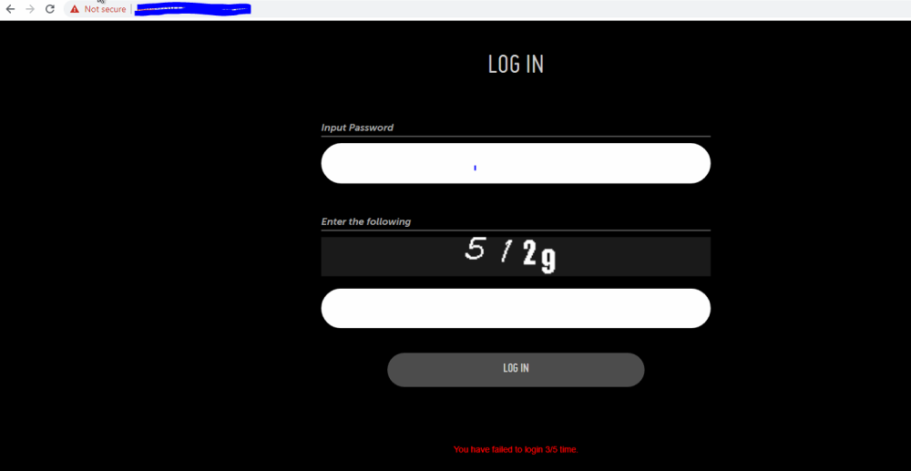

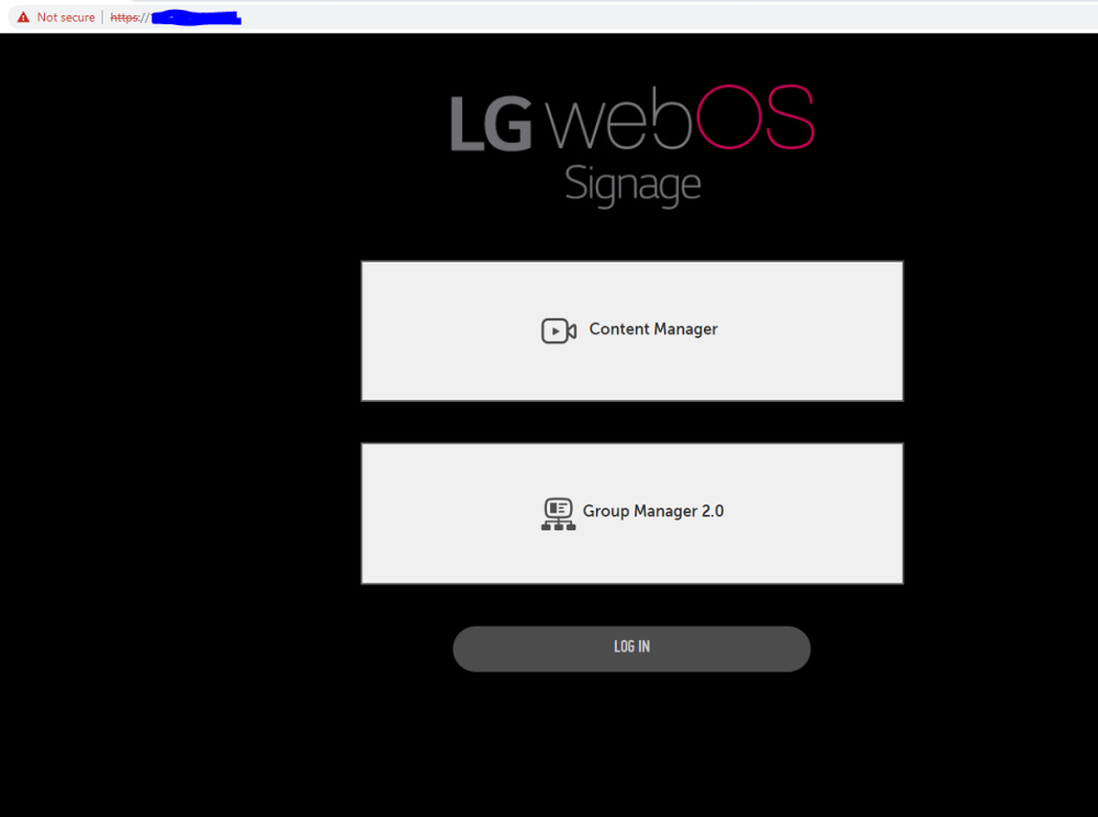

I have login issue on a brand new LG TV 55UR640S0ZD there I  want to create content with content manager and create Groups with Group Manager 2.0.
I´m trying to login to Dashboard with chrome and Internet Explorer browser which is connected to wlan with IP address:
Here it says to Input Password and I have tested
0000
000000
00000000
1157
admin
Without success, what is the default password?
I have reset the TV from Hotell mode menu and ordinary Menu to factory default but does it exist any other way to reset TV?
How can I get access to my TV?
All help is appreciated
BR. Filip
  • 2 weeks later...
Hi, I found the password
it is then Digisign Serial number + LGe12# you find this in [Installation Menu]>[Signage]>[System Information]
and then your password is "SerialnumberLGe12#"
Hope it helps someone.
Filip
