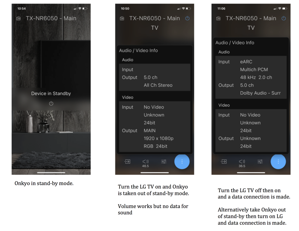

I have an Onkyo TX-NR6050 connected to a LG OLED77C2PUA using a high speed HDMI cable.
When the TV is tuned on the Onkyo comes out of stand-by mode. The volume control on the LG remote is able to raise and lower volume control on the receiver.  The LG has a connection to the Onkyo but the LG is not passing any data.
If the receiver is out of stand by mode (by either turning the receiver on first or turning the TV on --> off --> on) then there is a data connection and sound can be heard.
The issue seems to be in the timing of the handshake between the two devices. The LG has no problem turning on the onkyo but whether the data connection is established is based on the receiver being out of stand by mode first.
I tried everything found on line from changing HDMI connection type form Auto, PCM, and pass through. I have tried disabling the quick start from LG setup.
It is very annoying considering the amount of money invested into a setup that is suppose to be eARC 2.1.  I should not have to use the home theater remote.
Any ideas?

I just purchased a new 77OLED C3 to replace my five+ year old 65E7P, the latter of which worked seamlessly with my Yamaha A/V receiver. I had one HDMI cable pulled through my wall to connect to the A/V box. When my new tv was installed on Saturday Sept 9, I did not check out the connectivity issues until Sunday, when I noticed that when I turned my tv on, instead of automatically connecting to my cable box, it brought up either the home screen of my Apple box or the home screen of my blueray player. i had to manually set my receiver to the cable setting to get it to bring up my broadcast stations. I called Costco Concierage and they could not resolve the issue so they connected me with LG technical support. They also could not resolve the issue and proceeded to tell me that they did not support the connection set up to my a/v Receiver and that I should connect my Apple box and blueray box directly to the tv, requiring pulling two more HDMI cables through the wall. This did not make any sense to me, and LG was at a loss to explain what the technical issue was, even though this issue has been brought up on other other forums and a You Tube video was also made by one customer who was irate about this issue. Not sure if this is a defect on my set or a problem with LG connectivity software. LG should have opened a ticket on this issue and escalated the problem for a fix. I am on the verge of returning this tv for either a Samsung or Sony OLED set but wonder if they too will not work seamlessly with my home theater.
Bob,
You fail to mention the model of your Yamaha. It needs to have an eArc HDMI port and you need to use a highspeed HDMI cable. Your cable box (you should dump it for YouTube TV), AppleTV and Blu-ray player should all be plugged into the A/V receiver with good HDMI cables. If your current Yamaha is 5 years old or older, I suspect it lacks eArc with HDMI highspeed cabling. You purchased the best TV. Unfortunately, you didn't do your homework before the installation. Most manufacturers don't play well together. High-end A/V is complicated and requires study beyond most manuals. Best of luck to you!
T R Black
Here is an update.
Completed wiring for home theater and permanently mounted TV.
For some reason I set the TV to the HDMI 2 input that the eArc HDMI cable is connected to. When I turn on the TV it displays HDMI 2 then shows AV Receiver. From there the no input is displayed since I have not connected any external devices (i.e. firestick) to the receiver HDMI input.
I can go to the apps that I use to stream TV and the sound works. So either LG applied an update or when connecting to eARC set home to HDMI 2 so that the handshake can be completed.
There have been 1-2 times that when I lowered the volume that something goes wrong and the audio gets disconnected. It has happened so infrequently that it is no issue. Either way, I can confirm that the LG C2 is know working with Onkyo receiver.
